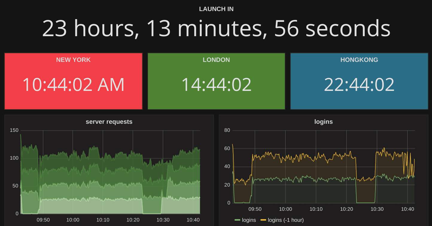

People have been asking for a Clock Panel in Grafana so I thought I’d give it a try and at the same time show how to build plugins for Grafana.

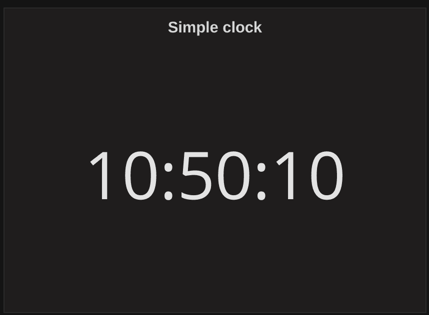

Run grunt to get everything compiled and copied over to the dist folder. Then refresh Grafana and try to add a new panel. The new Clock Panel should be available in the list.
Decorative image
But we’re not finished yet. It looks very plain and off center at the moment. We need to style it.
