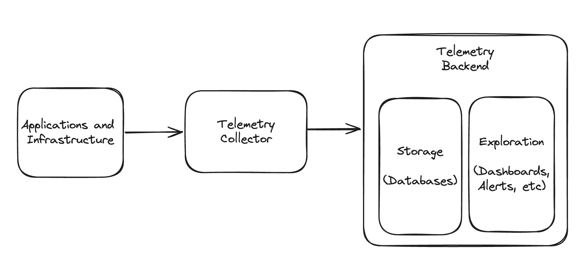

Three key layers of telemetry
Before we dive deeper into the concept of vendor neutrality, let’s look at the bigger picture, as it relates to telemetry and the OpenTelemetry project. In general, telemetry approaches usually involve three layers:
  1. The apps and infrastructure: This is the source of the telemetry — meaning, the actual thing we will be observing.
  2. The telemetry collector: This is software that collects, filters, processes, and forwards telemetry signals.
  3. The telemetry backend: This can be broken down into two further layers: storage and exploration, which is how we extract value out of telemetry signals. For example, at the exploration layer, an SRE looks at a dashboard and determines that a particular service needs investigation.
A diagram depicting the layers of telemetry.
You can get quite complex with all three layers, particularly the collector layer, but telemetry solutions usually have something in each category. This is a useful model to help ground what vendor neutrality means in this post, and how you achieve it.

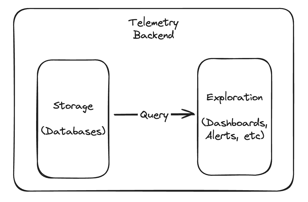

So far, we have been talking about sourcing, collecting, and processing telemetry. What about the backend?
In any architecture, eventually the data comes out of an OpenTelemetry-compatible collector, and goes into a database somewhere. That database might be Grafana Loki or Mimir, or it could be Prometheus, Elasticsearch, or something else. This is where vendor neutrality starts to look different.
A diagram depicting how telemetry backends work.
At this point, it’s no longer about telemetry data being sourced and flowing on the wire — it’s about telemetry data at rest in a database. To utilize that telemetry, we’re going to have to pull it out of the database, and slice and dice it with queries. No matter what database you choose, what matters most is the database’s schema and query language. It will likely respect the semantic standards, but you don’t query databases with OTLP.
Next, you’ll build some set of dashboards on top of the queries from that database, and you might build alerts and other things, regardless of the vendor you choose. When you do this, you’re out of the OpenTelemetry world, and unavoidably building product-specific resources. If you use Grafana Cloud, even if you’re feeding it with OTel signals, it may not be obvious how to migrate those usage patterns to a different backend, and the same is true for all other observability vendors. This is because there are no industry standards for things like dashboards and telemetry databases to adhere to. And, as stated on the “What is OpenTelemetry?” page, telemetry storage and visualization are beyond the scope of the OTel project (bolded emphasis, again, is ours):
OpenTelemetry is not an observability backendlike Jaeger, Prometheus, or other commercial vendors. OpenTelemetry is focused on the generation, collection, management, and export of telemetry. A major goal of OpenTelemetry is that you can easily instrument your applications or systems, no matter their language, infrastructure, or runtime environment.Crucially, the storage and visualization of telemetry is intentionally left to other tools.
