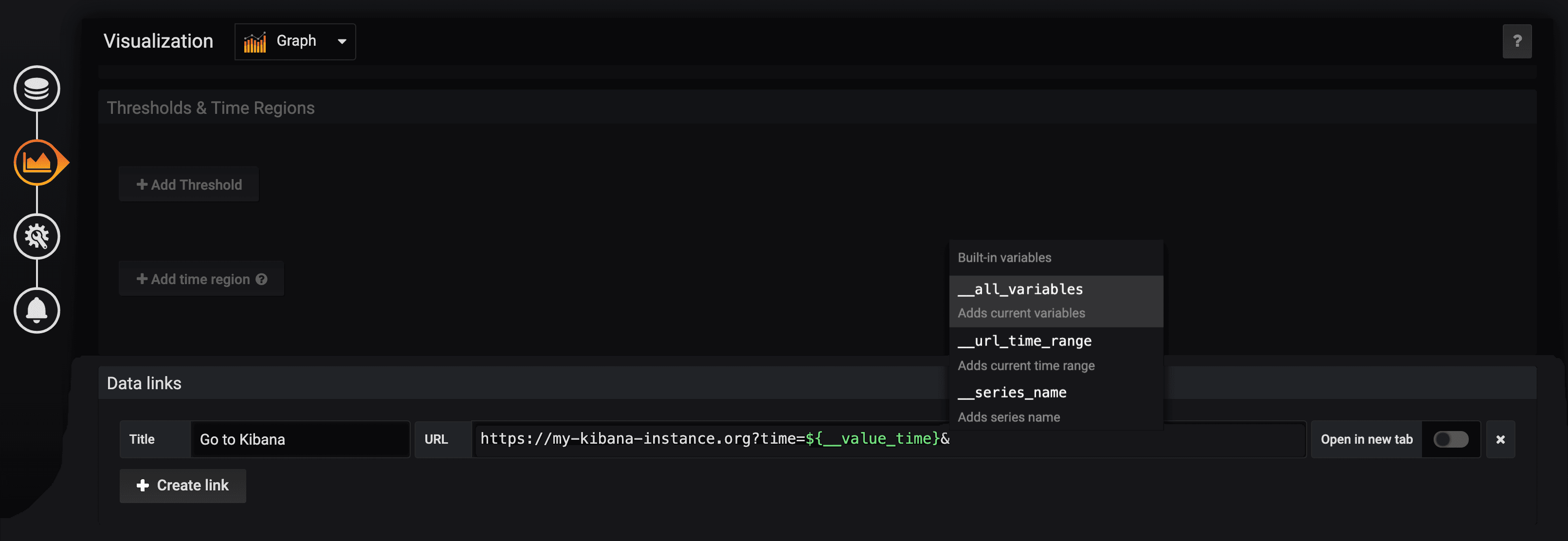

First, we changed the name from Drilldown links to Panel links and we have significantly simplified and improved the way you edit a link:
Embedded image
In addition, for the Graph panel, we have introduced Data links. The difference between those two types of links lies in the variables that can be used when building a link.
Data links, used in the actual visualization, have access not only to template variables and current time range, but also to variables that are specific to the series which you interact with such as series name or clicked datapoint timestamp. Being able to choose a datapoint and combine its values as well as the series name should be enough to recreate the context in the external system. (You can read more about all available variables in the documentation.)

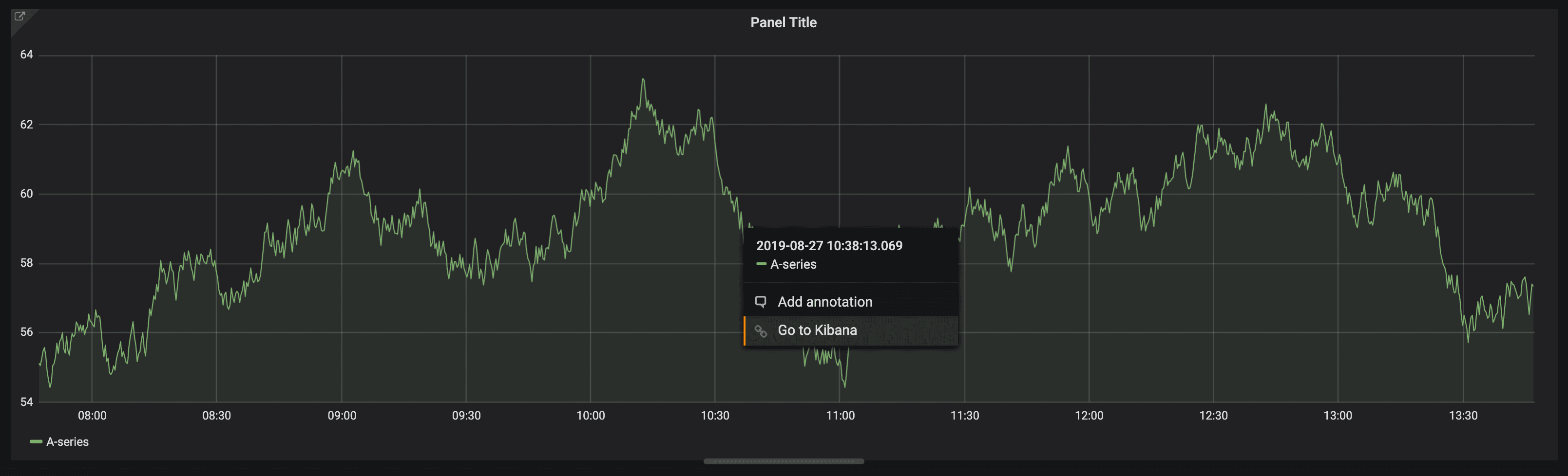

Last, but not least, we have introduced a new way of accessing Data links from the visualization. All the Data links you create are now available via a context menu in the Graph panel that’s shown when you click on a single data point:
Embedded image
