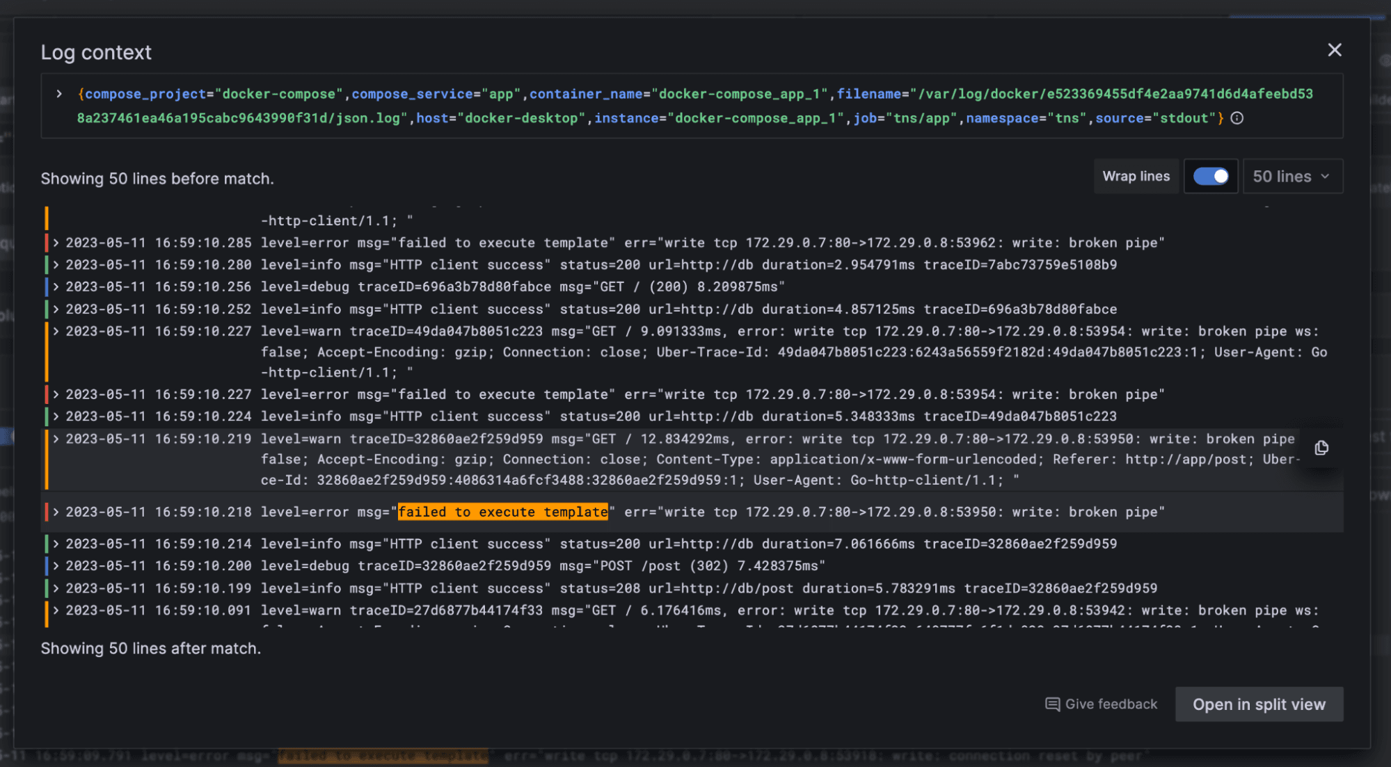

With the enhanced log context feature in Grafana 10, you’ll experience better navigation and a user interface that’s more consistent with logs visualization in Explore. We’ve color-coded log lines and integrated timestamps into each log entry, so you can click on individual log lines to access detailed information, and even selectively display certain labels to drill down on what truly matters.
Screenshot of the new modal view of log context feature in Grafana 10.
Moreover, the transition to a modal view for log context offers a more focused environment for your log analysis. If you click on the Show context button that pops up as you hover on the right-hand side of each log line, you can place your log line in the center of the screen and display log entries that happened before and after that line, highlighting the actions that led to your specific log event.
Screenshot of log context modal with the Show context button highlighted.
The original log line stays sticky within the scrollable modal, ensuring you always have your reference point. And instead of displaying only 10 lines before and after the matched log entry, a dropdown menu now allows you to view up to 50 lines, offering a more expansive view of your log stream in the context of your query.
We’re also now displaying the executed context query right above your log lines, eliminating any potential confusion about the query being run. This ensures you’re always clear on the specific context in which you’re operating.

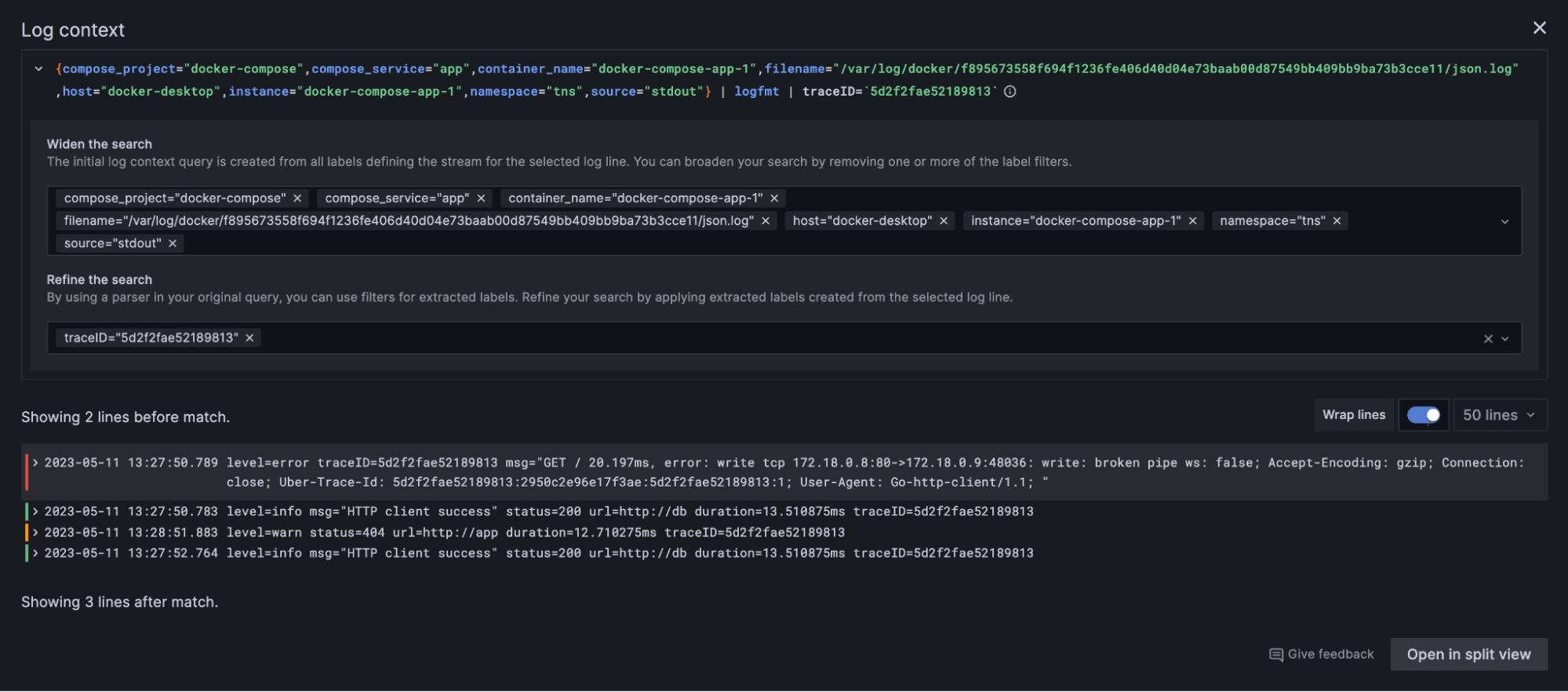

To modify your log context queries, we’ve introduced a powerful new tool — the Loki log context query editor. You can activate this editor by clicking on the log context query preview. Within it, you have the option to modify your search by removing one or more label filters from the log stream. If your original query used a parser, you can refine your search by leveraging extracted label filters.
Screenshot of log context query editor in Grafana 10.
Imagine you stumble upon an error log line containing a traceId and you want to view other log lines sharing the same traceId. This is where the log context query editor is helpful: For structured logs, if your original query used a parser, for example, {compose_project="docker-compose"} | logfmt, you can refine your search by selecting the traceID to view logs lines sharing that traceID.
Additionally, the Widen the search option enables you to remove label filters such as job or host. This allows you to look for logs with the specified traceID across all jobs and all hosts, granting you the control and flexibility to tailor your log analysis to your unique needs.
