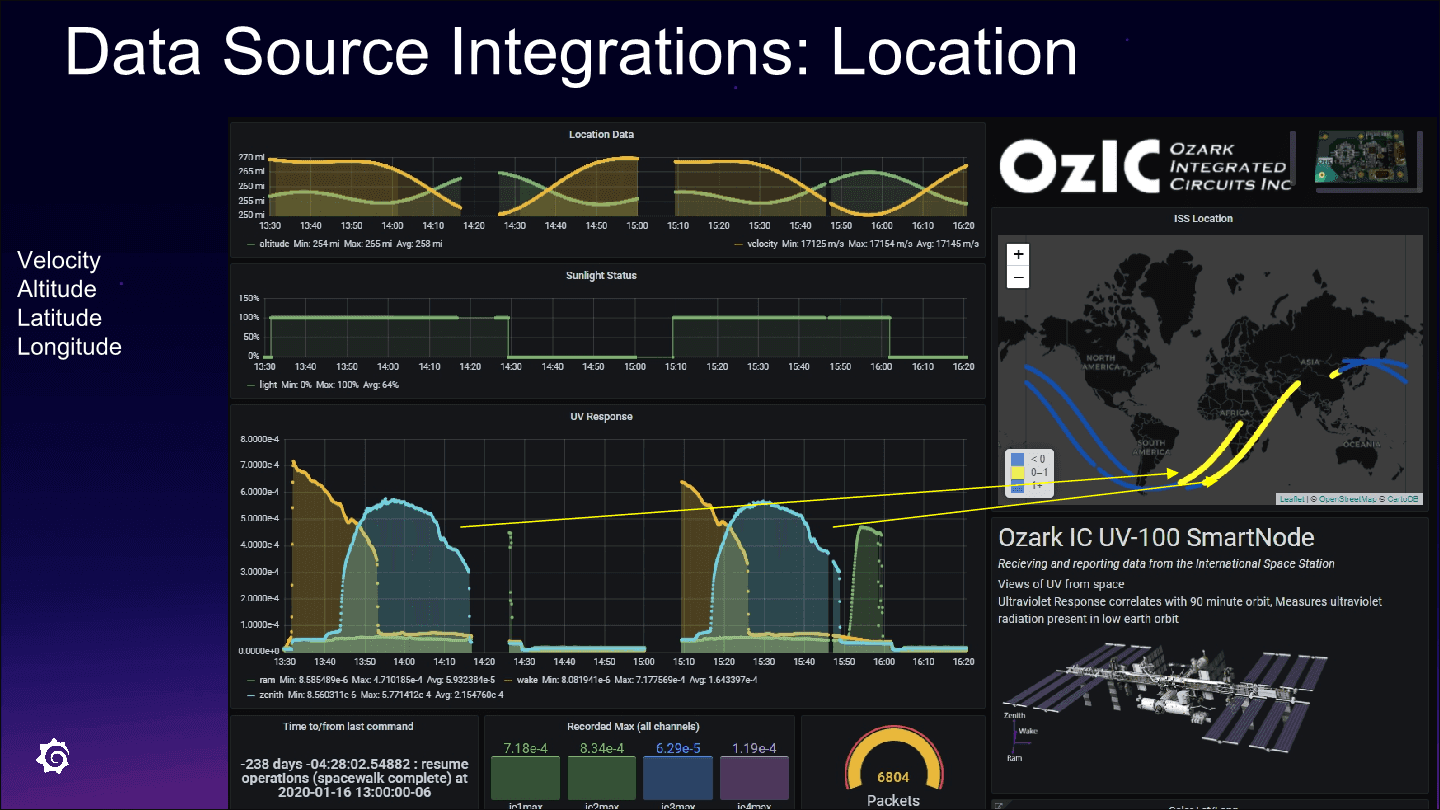

Three Ozark IC UV detector modules were installed on the ISS in January 2019 on Alpha Space Test & Research Alliance’s MISSE platform. Getting the sensors in orbit was step one. They also had to decide how to handle “tons” of data. “We had three modules, with four channels each, all reporting data every four seconds,” said Francis. “If you’re in orbit, and everything’s working, you’re drowning in data. What worked on the bench to develop it is not going to work while it’s live in orbit.”
They began by incorporating a database, using Postgres and integrating their Python decoder to unroll the packets and populate it. But the outcome fell short. What they had was real-time data in a time series, and parametric data to go with each time point. But what they wanted was real-time data aggregation and viewing, and the ability to correlate the data coming from the space station with the ISS location and other geospatial data.
So they implemented a Grafana-based real-time information display system. “Data is no good without the ability to see and to learn from it,” said Francis, who showed off many of the dashboard features during his session. “Grafana is an amazing tool for gaining insights into data sets of any size.”
