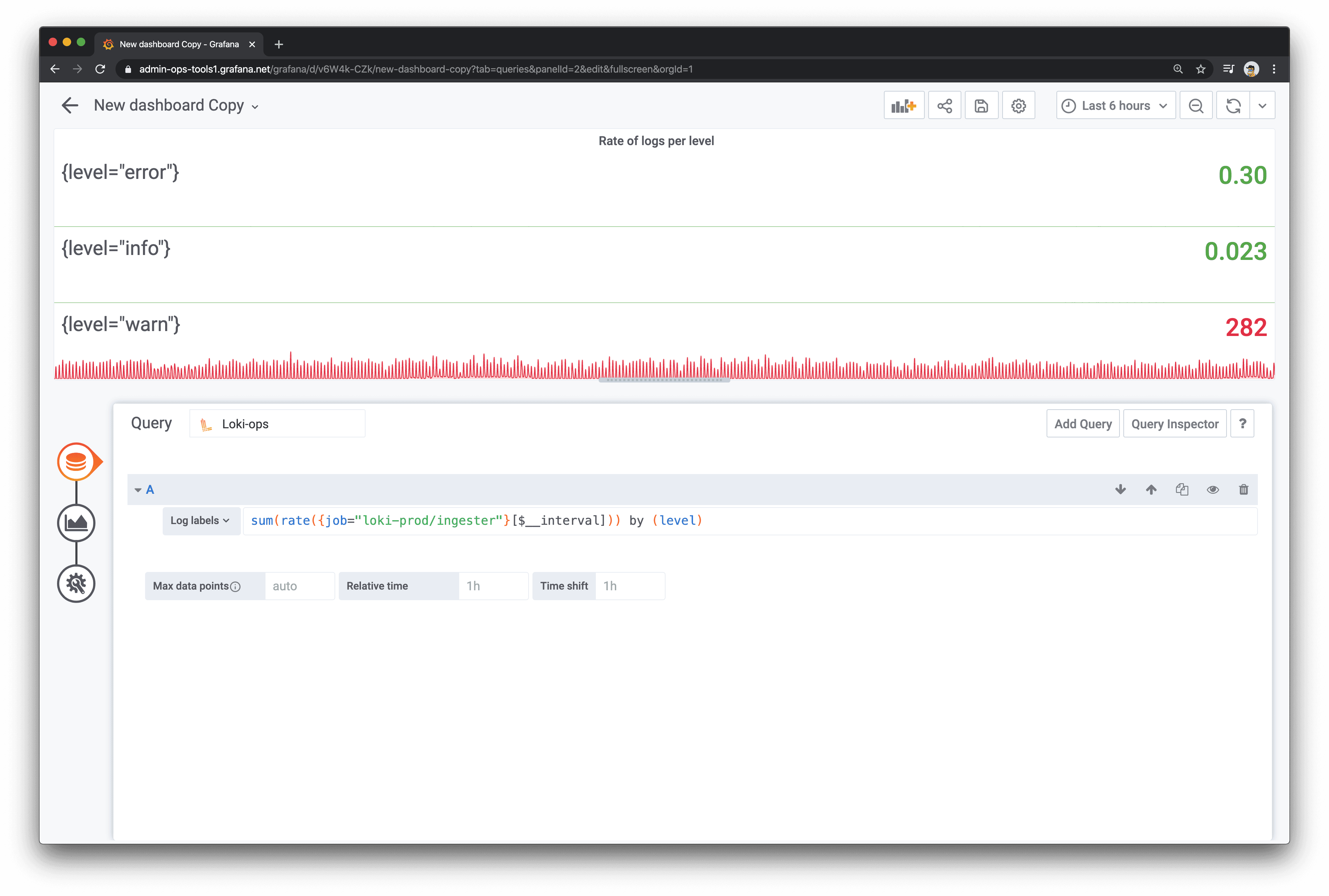

Step 1: Choose a visualization. Graph, Gauge, Bar Gauge, and Stat all work for this (Single Stat does not).
Step 2: Choose a query. Before, the only possibility was a Prometheus datasource using Loki, but now you can simply select a Loki datasource.
Step 3: Write your metric query. Find a guide to LogQL metric queries here. For the interval, you can choose one that is fixed or the $__interval Grafana variable. (This has the advantage of using the same range and step.)
Embedded image
And what you’re able to create is something like this: [[SC_TOKEN_]2]]
The top two graphs were created using Loki as a metric datasource, and the bottom is a typical Loki Log Panel.
And that’s it! You have an application dashboard made only with logs.
