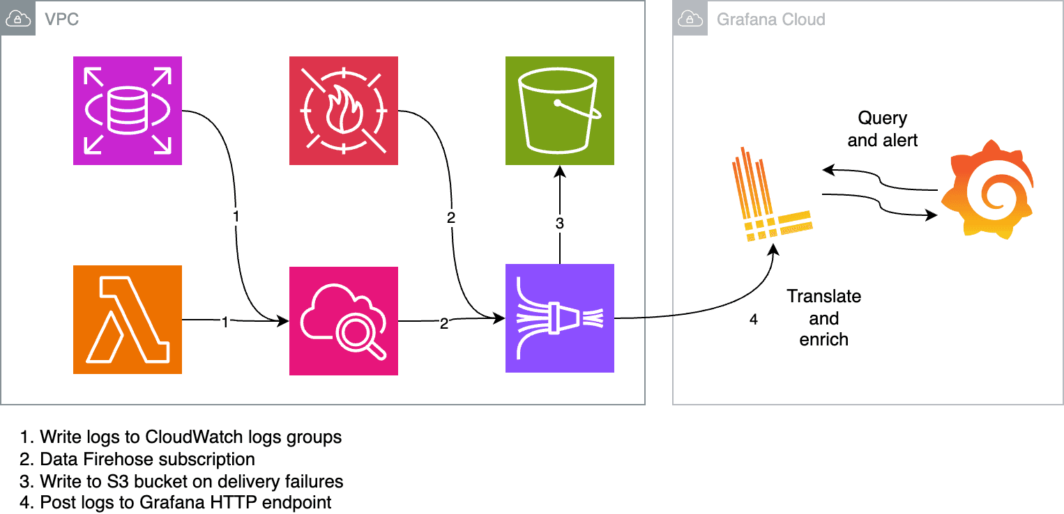

This solution makes it easy to connect Amazon CloudWatch logs to Grafana Cloud because you don’t have to deploy agents or local configurations. Instead, a Firehose stream is configured on your AWS infrastructure.
Delivery streams are configured to batch and send ingested records to Grafana Cloud Logs, which is powered by Grafana Loki, our open source log aggregation system. You can use the Firehose delivery stream to send logs from multiple AWS offerings, including Amazon CloudWatch (through subscription filters), VPC Flow Logs, AWS CloudTrail, and more.
To prevent potential data loss, you can also back up events to an Amazon S3 bucket. You can configure this for all log events or just for those that failed to get delivered—for example, if the delivery quota is exceeded. For more information about adjusting your backup based on the amount of log data you’re streaming, see the AWS documentation on data delivery failure handling.
A flowchart of AWS resources moving to Firehose, then to Loki and Grafana
