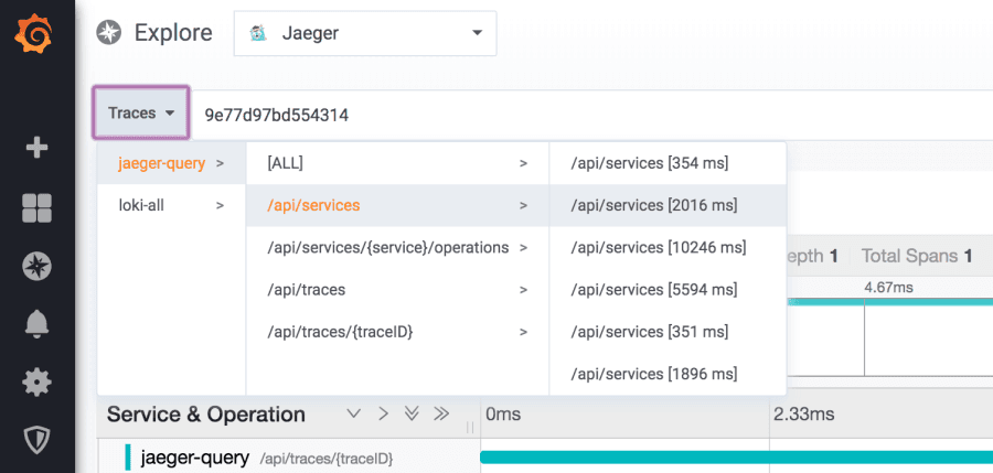

The experimental Jaeger datasource also comes with a trace selector that shows a list of services that break down into their operations, and then show the ten most recent traces. We added this so you can quickly browse traces when not coming directly into Explore with a trace ID.

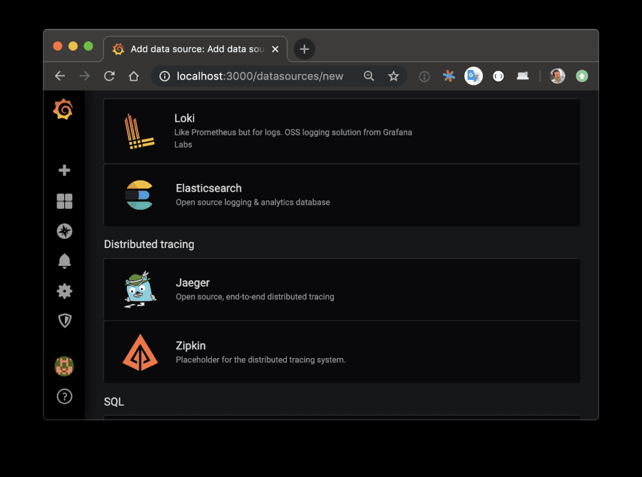

This demo is a statement of intent: Right now we’re embedding the Jaeger UI in an iframe, but in the future we’re going to make it possible to natively visualize traces in Grafana. We want to apply the same Grafana “big tent” ethos here, too – even though the demo is only for Jaeger right now, we want to support other distributed tracing systems in the future.
Embedded image
The experimental branch that contains the Jaeger datasource also contains a Docker compose file that lets you run most of the pieces together: Grafana (experimental image from the branch), Loki, and Jaeger. Note how the compose file uses Loki itself for the Docker logging driver (see setup instructions).
