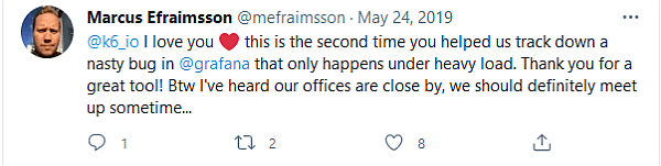

A couple months later, we got reports that upgrading to Grafana v6.2 in combination with using the Grafana auth proxy resulted in a lot of 500 internal server errors when trying to load data for dashboard panels. An auth proxy load test was implemented to reproduce the problem, develop a solution, and verify the solution by running the load test comparing the results. k6 once again helped us track down a nasty bug.
