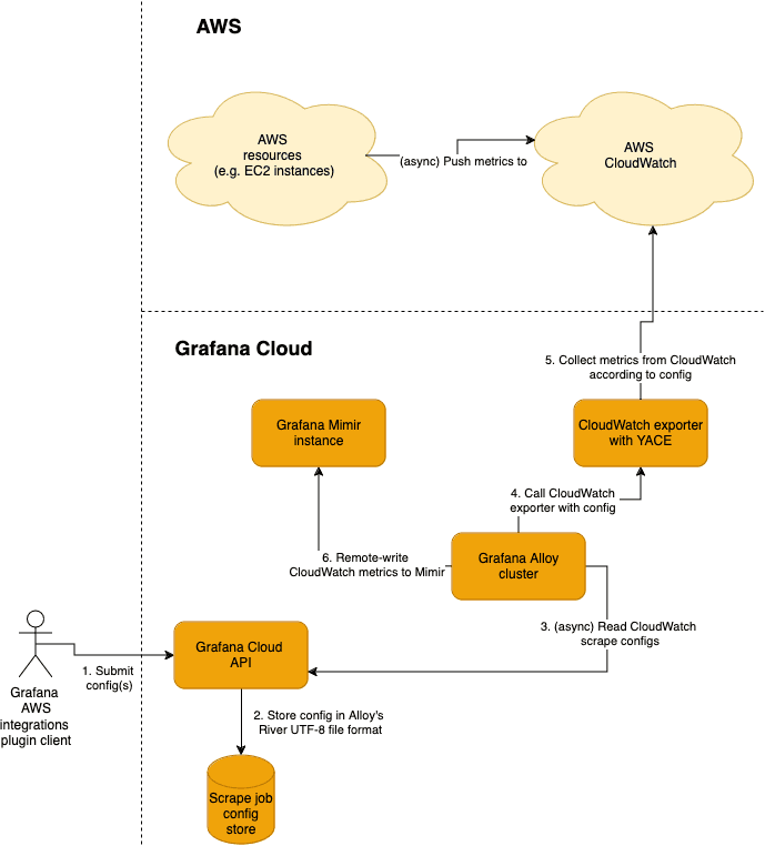

A closer look at Grafana Cloud agentless exporters
Next, let’s take an in-depth look at what an agentless exporter is, using our AWS Observability app as an example. There are several options for getting metrics data from AWS into Grafana Cloud, and AWS Observibility runs on Alloy clusters operated by Grafana Labs. If we look at the high-level flow for creating a CloudWatch metrics scrape job using our current system with Alloy clusters, it looks roughly like this:
Alloy clustering workflow
It all starts with the Grafana Cloud API, which helps you manage and persist your hosted scrape job configurations. It serves your scrape job configurations over HTTP in Alloy’s config format. Then, there’s a Grafana Alloy cluster, where each cluster node periodically pulls the set of scrape jobs from the API and communicates and/or uses the result of communication with other cluster nodes to determine which scrape jobs it should run. Each scrape job is run on a regular time interval, where the exporter is called with the specific query time range, metrics to pull, and the aggregation function to perform on those metrics.
The exporter may be responsible for performing complex metadata operations like figuring out which metrics actually exist with recent data, or associating particular time series with vendor-specific resource identifiers. Read the section about CloudWatch data fidelity in our recent blog for more information about metadata association.

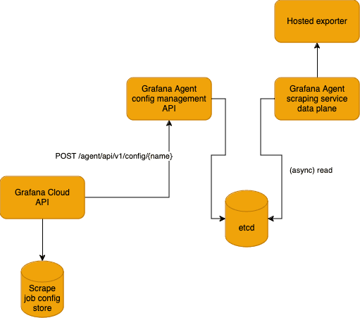

What is now a Grafana Alloy cluster pulling scrape job configs asynchronously from the Grafana Cloud API used to be a much more stateful push from the Grafana Cloud API to something called the Grafana Agent scraping service, using an etcd cluster.
Grafana Agent scraping service workflow
Grafana Agent scraping service requires cluster membership state as well as the scrape configs themselves to be stored in a distributed KV store like etcd or Consul. As a result, the Grafana Cloud API has to persist every config via the Grafana Agent’s Config Management API in the Agent’s YAML config format, in addition to its own distinct persistence layer.
This approach has two major drawbacks:
  1. An extra persistence layer opens the system to complex failure modes regarding data consistency, known as the dual write problem.
  2. Operating that extra persistence layer, etcd, is no small feat, and any software system with complex configurations and interactions will hold its share of misconfigurations and misinteractions that lead to outages.
Alloy’s clustering feature eliminates both of these problems completely through its import configuration components, which enable dynamic Alloy configuration to be retrieved from remote sources. Specifically, we make primary use of the import.http component, with which we configure Alloy nodes to call our Grafana Cloud API to generate the latest set of scrape job configs.
