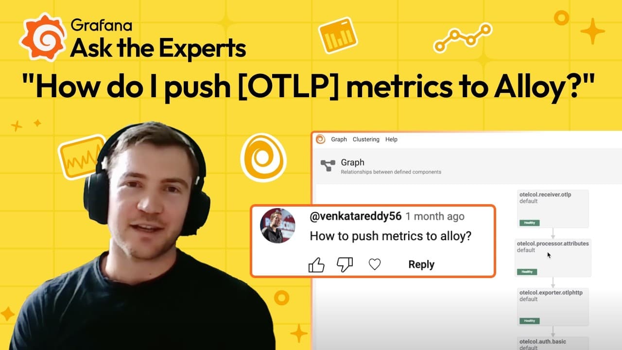

How to receive OTLP metrics and send them to Grafana Cloud
Seeing as how Alloy is a distribution of the OpenTelemetry Collector, it only makes sense to start with OTLP (OpenTelemetry protocol) metrics. More specifically, let’s look at how to use Alloy to receive metrics from an application instrumented with OTel and then send that data to Grafana Cloud.
To do so, you’ll use four OpenTelemetry components:
  • otelcol.receiver.otlp, which receives metrics in OTLP format via HTTP and forwards them
  • otelcol.processor.attributes, which transforms the attributes associated with a metric
  • otelcol.exporter.otlphttp, which sends the metrics to Grafana Cloud using credentials
  • otelcol.auth.basic for exposing those credentials
We’ll also enable Alloy’s live debugging feature, which will help build the transformations we want for the attributes processor and to make sure we’re comfortable with those attributes before we begin sending the metrics to Grafana Cloud.
Once you have that set up, you’ll use the run command, and you’ll then be able to see the four connected components in the Alloy UI. If you click on the otelcol.processor.attributes component, you can go into live debugging to see which metrics are passing through the component and identify any necessary changes.
From there, you can go to your Grafana Cloud instance and look for the specific OTLP metric you’ve set Alloy to collect. If you run a query on that metric, it should appear in your graph in just a few seconds.
For more details on how to set up this type of OTLP metrics pipeline, check out the full Ask the Experts demo from William Dumont, a software engineer on the Alloy squad, below.
Video

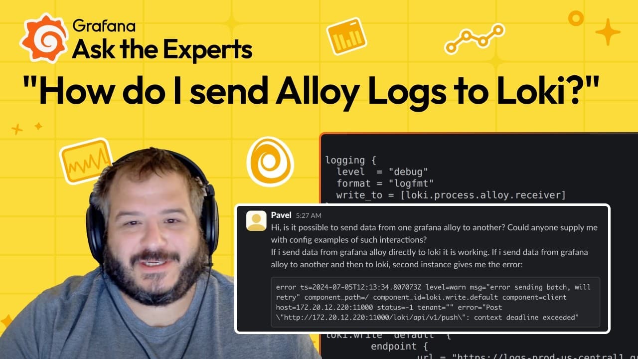

How to send Grafana Alloy logs to Grafana Cloud
Now that we’ve walked through sending OpenTelemetry and Prometheus metrics to Grafana Cloud, let’s look at the next most popular telemetry type: logs. In this example, we’ll send the data to Grafana Cloud Logs, which is powered by Grafana Loki.
To do so, we’ll need three components:
  • logging, and in our example we’ll use debug level to get the most information possible, as well as logfmt for the format, though you can also use JSON. The other important argument here is write_to, which tells the logging framework where to send those logs
  • loki.process, which is a pipeline unto itself. You can add any number of stages here, but for our purposes we’ll just add the service name, and we’ll use alloy so we can identify it on the frontend
  • loki.write, is what actually sends the data from Alloy to Grafana Cloud, or any Loki-compatible endpoint.
Once you have that set up to suit your needs, go back to the Alloy UI to see all your components running. Then, go to Grafana Cloud and look for the Alloy label filter. If you run a query on that label filter, you should see logs coming though and you can manipulate your data as needed.
To find out more, check out this Ask the Expert video below from Matthew Durham, a senior software developer on the Alloy squad.
Video
