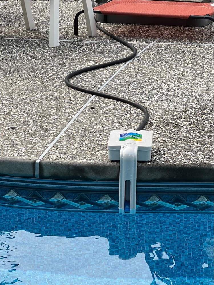

I found the most cost-effective approach was a mechanical device called a Pool Sentry, which is basically a device with a float that works exactly like a toilet. The water level drops, the float goes down, and the water valve opens to allow water from the hose to fill the pool. As the water level rises, it moves the float up until it reaches the desired height and then the valve closes to stop the flow of water.
A picture of of the Pool Sentry at the edge of my pool.

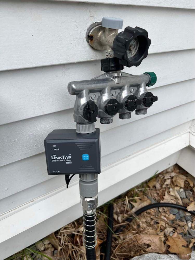

To solve this problem, I found the LinkTap G2S, an IoT-enabled smart water controller you can attach to a garden hose. It even had a flow meter built into it to monitor how much water was being consumed. Combining the LinkTap with the Pool Sentry allowed me to define a schedule to turn the hose on for two hours a day so I could monitor how much water the Pool Sentry added to the pool.
A picture of the LinkTap device attached to a spigot outside my house.

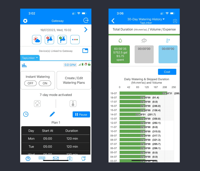

As you can see from these screenshots from the iOS app on my phone, the LinkTap G2S collects all sorts of interesting data, including daily watering history.
Side-by-side screenshots LinkTap data displayed on my phone.

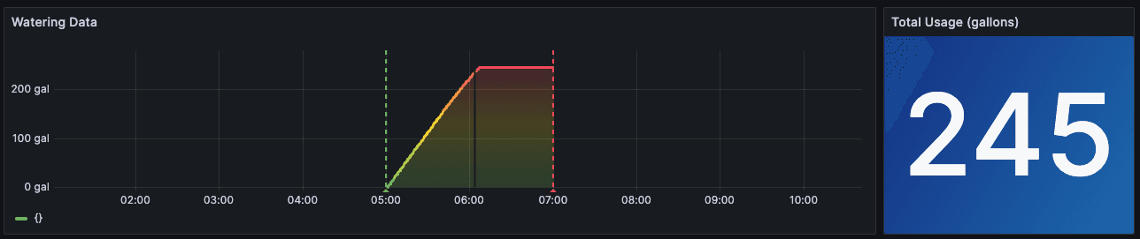

The result is a beautiful graph!
A screenshot of a portion of a dashboard displaying watering data.
As you can see, I set it up so Grafana creates annotations automatically from the wateringOn and wateringOff events, so now I had the vertical green and red lines on my time series graph indicating the start and stop times.
For example, in the graph above I can interpret the flattening of the line shortly after 06:00 as the time when the Pool Sentry stopped the water flow and the pool was filled to the desired level. I also added a gauge visualization showing the total water consumption during a given time period.

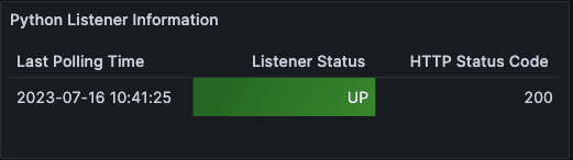

I also created a probe using the Prometheus BlackBox exporter to monitor the status of my Python Listener and added it to my dashboard. That way, I know if something happens to my Python Listener.
A screenshot of Python Listener information, including the last polling time, status, and HTTP status code.

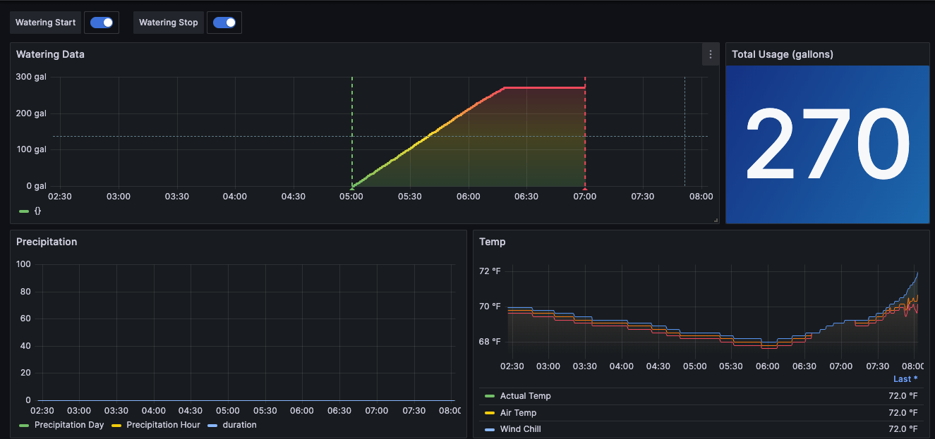

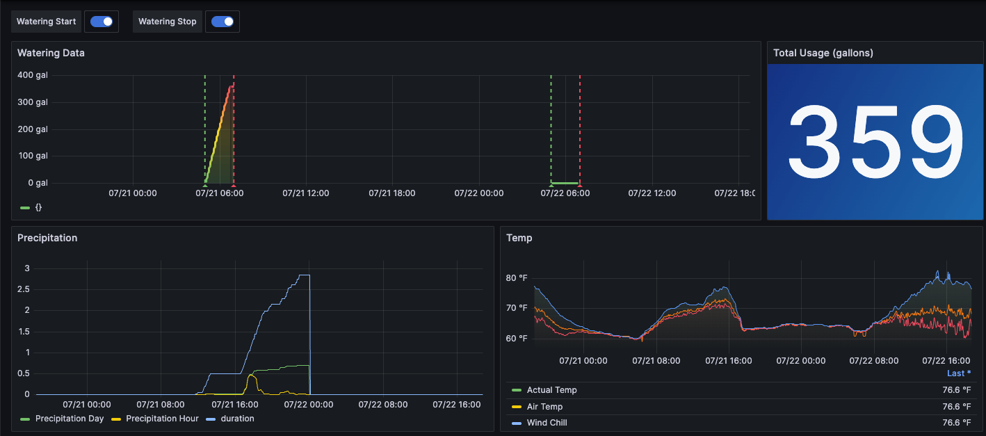

A screenshot of my dashboard, including water usage data, precipitation, and temperature.
With these additions, I could bring together data from two IoT devices into a single pane of glass to evaluate water consumption, rainfall, and the ambient temperature. As you can see from the screenshot above, 270 gallons of water were added on a rainless day, and the water turned off after the water reached the desired height.
And in the example below, two separate days — one dry and one rainy — are visualized, and you can see how the system responded appropriately on each occasion.
A screenshot of my dashboard covering a larger time range, including water usage data, precipitation, and temperature.
