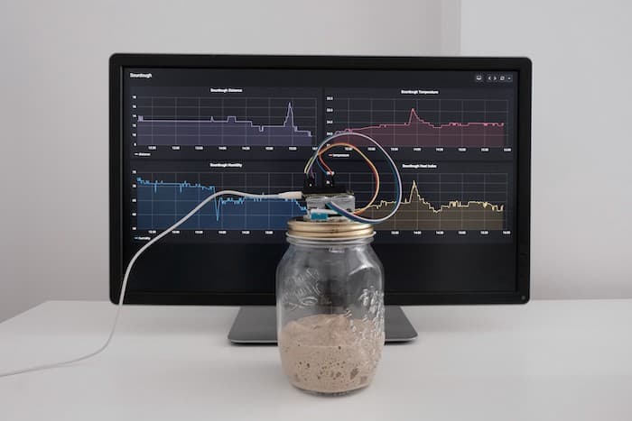

A sourdough monitoring system helps you track your sourdough starter’s temperature, humidity, and height. My sourdough monitoring setup uses an ESP32 development board, which collects data from sensors attached to the lid of the sourdough’s jar. To measure the height of the sourdough starter, I used an ultrasonic distance sensor. For temperature and humidity, I used a DHT11 sensor.
In my earlier sourdough monitoring setup, I used InfluxDB to store data and Grafana Cloud for dashboarding. For this blog post and for Make magazine, I updated my setup so that now the collected data goes to Grafana Mimir, the open source time series database that stores Prometheus metrics, in Grafana Cloud, and the information is visualized in beautiful graphs in Grafana. In Grafana, you can track your metrics over time or even set up alerts that will remind you when to feed your starter.

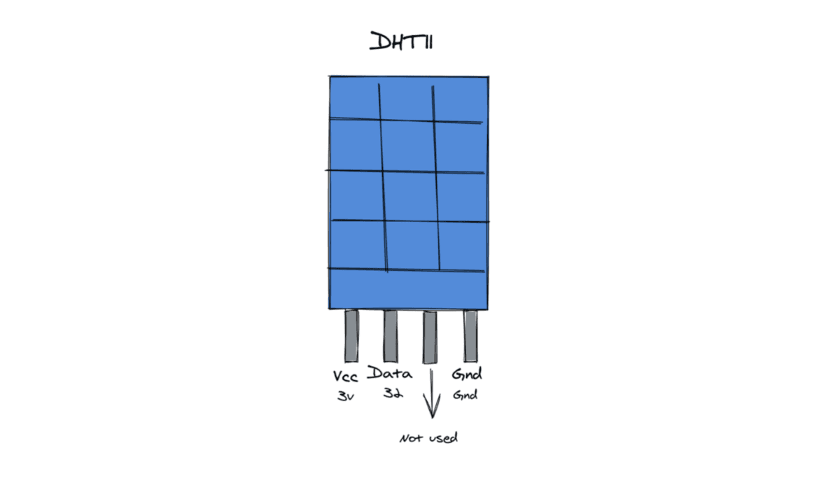

The DHT11 is a very basic and cheap sensor made of two parts — a humidity sensor and a thermistor. It can be used to measure the environment in which our sourdough starter lives.
If you have bought a DHT11 sensor module, then you should see 3 pins or 4 pins. In the 4-pin version, one of the pins will not be used. No worries if you have the 4-pin version — you probably bought just a sensor by itself. This has happened to me as well, and it is an easily solvable problem — you just won’t use the third pin.
Embedded image
We are going to connect these pins in the following way, as shown in the figure above:
  • Vcc pin to 3.3V on board
  • Digital pin to pin 32 on board
  • Gnd pin to Gnd on board

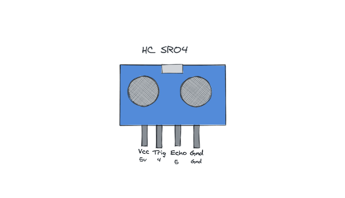

The HC-SR04 ultrasonic sensor provides 2cm–4 meters of measurement function, with accuracy around 3mm. This sensor will be used to measure how far your sourdough starter is from the lid and  calculate its rise and/or fall. The HC-SR04 has 4 pins that you will connect to the ESP32 board in the following way:
Embedded image
  • Vcc pin to 5V on board
  • Trig pin (sends the signal) to pin 4 on board
  • Echo pin (receives signal) to pin 5 on board

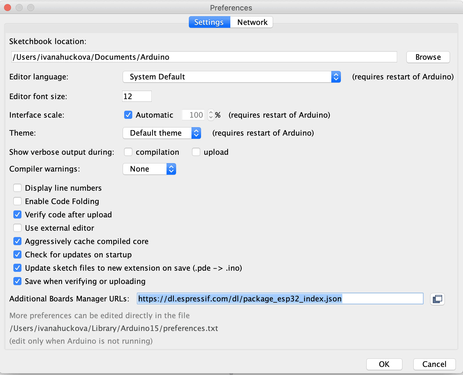

Open your Arduino IDE. If you are using an ESP32 board (and not an Arduino board), you need to add a board definition that adds support for your EP32 board. Go to Arduino > Preferences and add url https://dl.espressif.com/dl/package_esp32_index.json to the Additional Boards Manager URLs input. This open source board definition adds support for programming ESP32 boards.

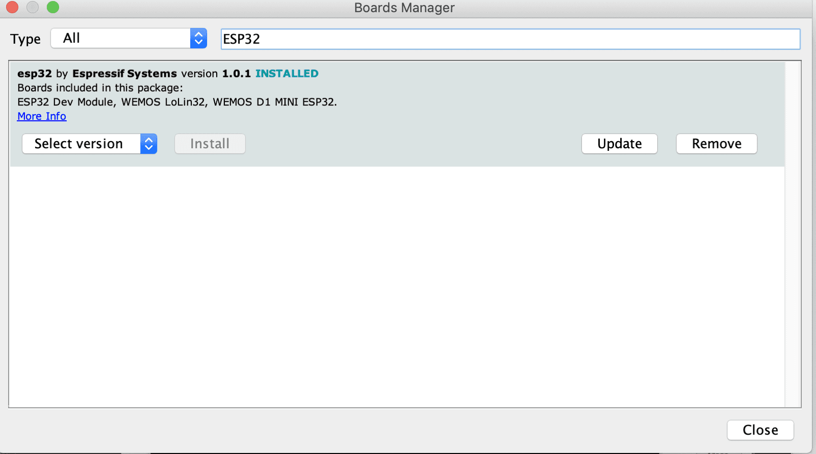

Then go to Tools -> Boards -> Boards Manager and add ESP32 board manager.

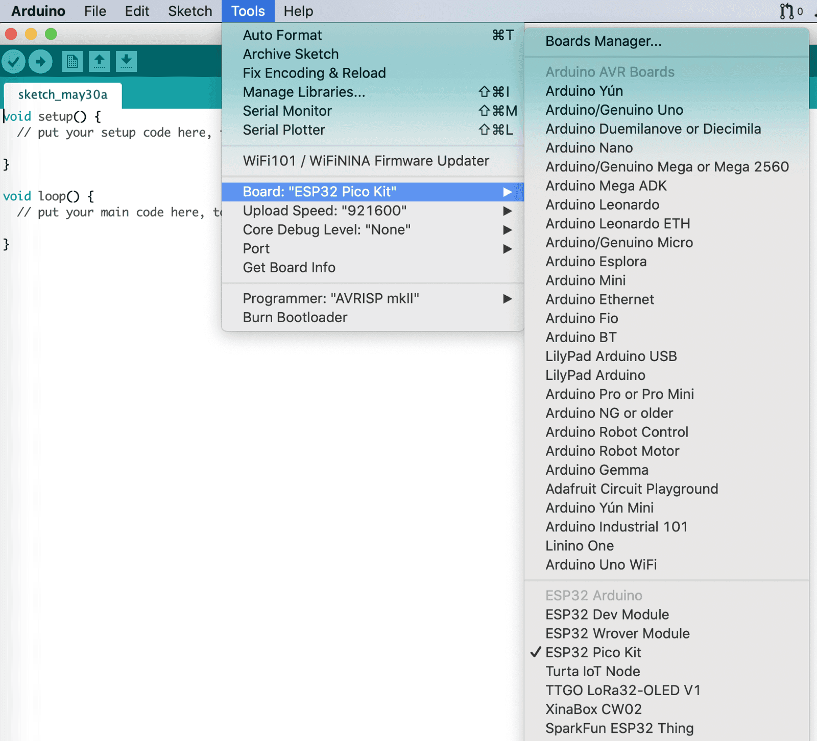

Next, in Tools -> Boards, choose ESP32 Pico Kit board. This tells the Arduino IDE which profile and base libraries to use when compiling the firmware image, and how to flash it to the board. Make sure that in the Tools -> Port submenu, you have selected the new COM port.

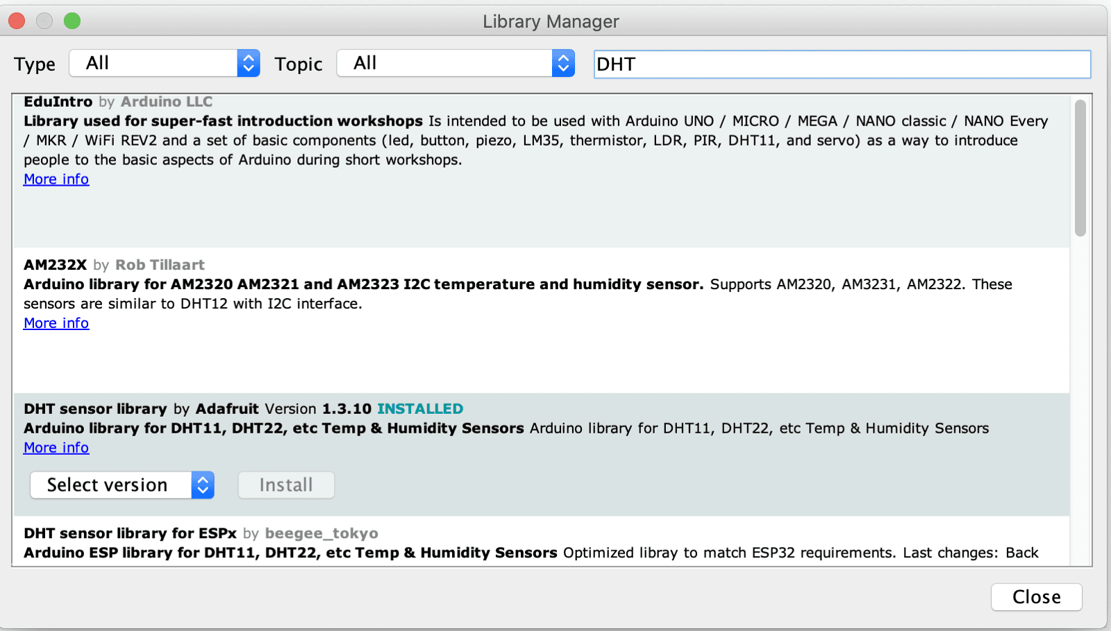

  • DHT sensor library by Adafruit
  • HCSR04 by Martin Sosic
  • Adafruit Unified Sensor by Adafruit
  • ArduinoBearSSL by Arduino
  • ArduinoHttpClient by Arduino
  • PrometheusArduino by Ed Welch
  • PromLokiTransport by Ed Welch
  • SnappyProto by Ed Welch
Go to Sketch -> Include Library -> Library Manager and install all of these. Make sure that you have all of them installed before moving to the next steps.

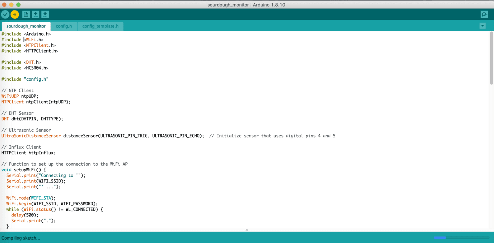

You can download the sketch from Github. In the folder, you will find 2 important files: config.h and sourdough_monitoring_grafana.ino. In the first file, we have our program. In the second, we are going to store our variables.
File config.h Add your variables:
  • Your Wi-Fi name and password, so the ESP32 can connect to your internet
  • Your user id as GC_PROM_USER
  • Your API key as GC_PROM_PASS
File sourdough_monitoring_grafana.ino Below you can find the program code with the comments explaining each section.

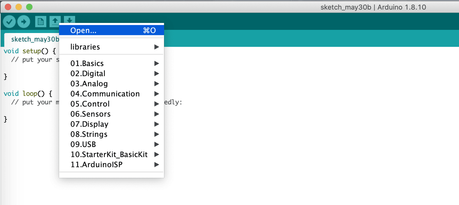

Click on the open button (arrow pointing up), choose Open, find your sourdough_monitor_grafana.ino file and open it.
Embedded image
Then go to Tools -> Serial Monitor and open it. This will allow us to see the debug output from the board. Set the port speed on the bottom to 115200.
Lastly, use the Upload button (arrow pointing to right) in the top bar of the IDE window to build and upload the program to the ESP32.
Embedded image
Once the upload has completed, our Serial Monitor will show:
  • Start-up and Wi-Fi connection
  • Results of submitting metrics
If everything was set up correctly, you will soon see incoming data also in your Prometheus compatible database.

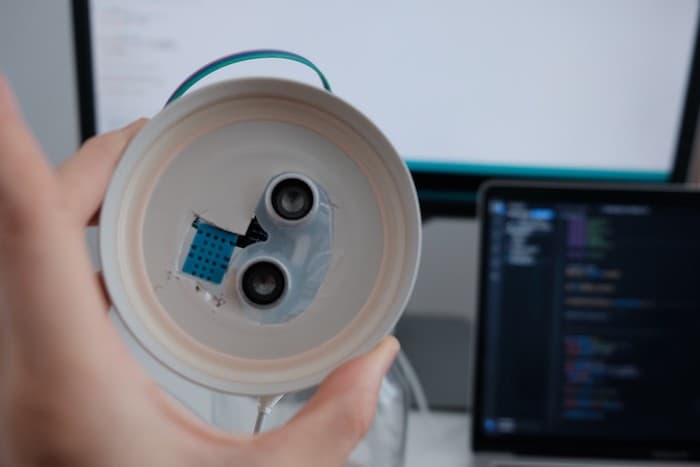

Take the lid from the jar and carefully make two holes: one in the middle of the lid for the ultrasonic sensor and another smaller one next to it for the DHT11.
Put the ultrasonic sensor in the HC-SR04 holder and glue it to the top of the lid. With double-side tape, stick the DHT11 to the lid so it is facing the jar.

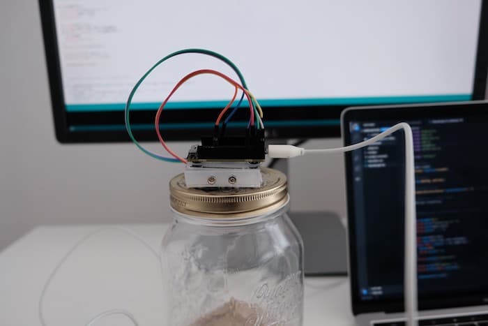

With a glue gun, carefully glue the ESP32 board to the top of the HC-SR04 holder. Make sure that you are only gluing to extended parts on which the ESP32 board stands and not the board itself.

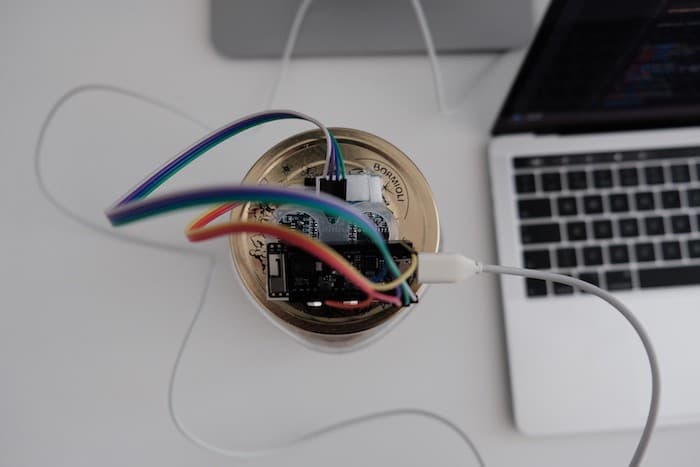

Embedded imageEmbedded image
And this is how it looks! Just place it in the kitchen (or any other area where you keep your starter), and plug it to the USB charger.
Note: After taking this picture, I added a cover made from a cut plastic bottle to make sure that the sourdough does not dry out because of the holes in the lid.
