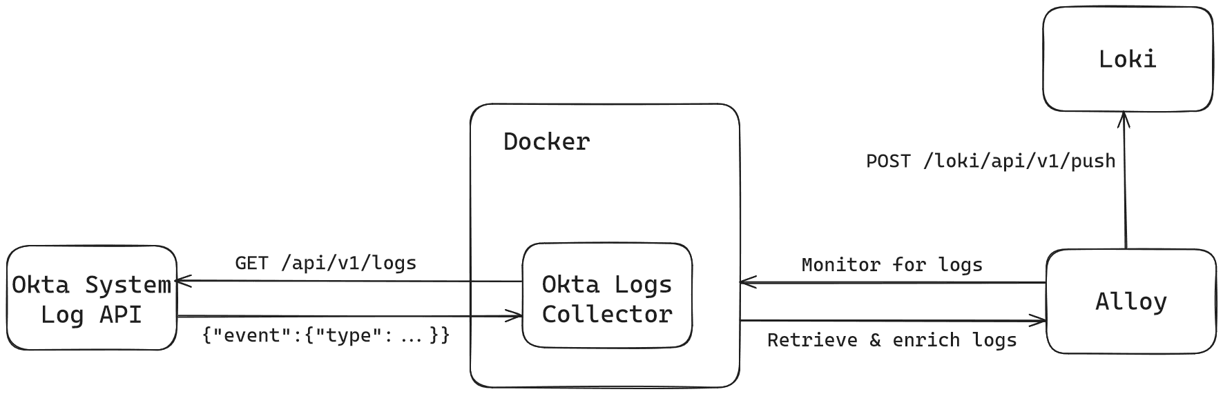

The Okta logs collector solution
Our okta-logs-collector application periodically fetches logs from Okta’s System Logs API and sends them to the STDOUT. Our solution works in a containerized environment, in which Alloy can discover Docker Engine, receive container logs, and forward them to Loki. Alternatively, you can pipe the application logs to a file on disk, which can then be monitored and read by Alloy using the loki.source.filecomponent and sent to Loki. The containerized solution is shown in the diagram below:
Okta logs collector diagram

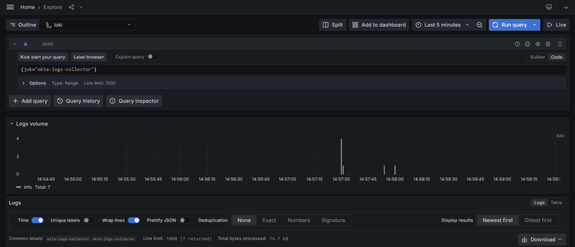

How to observe logs in Loki and Grafana
After a few moments, you should see logs appearing in Loki. Use the Loki LogCLI or its data source in Grafana to view and analyze the logs. If you are using Grafana Cloud, go to the Grafana Cloud portal and launch Grafana. From the right menu, navigate to Connections > Data Sources, where you will see that Loki is already added as a data source. Navigate to the Explore page and start querying your Okta logs using the {job="okta-logs-collector"} stream selector. The eventType field is indexed, allowing you to filter specific event types. A complete list of Okta event types (more than 930 as of now) can be found here.
Log volume dashboard in Loki
