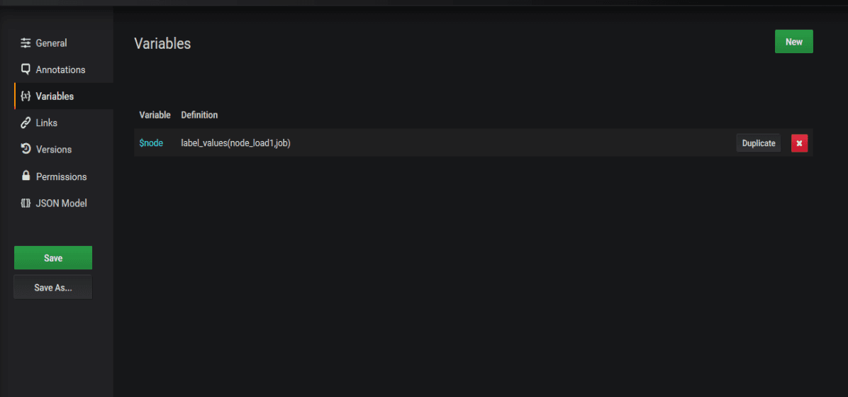

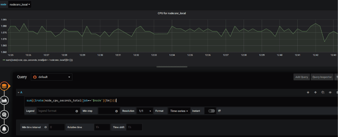

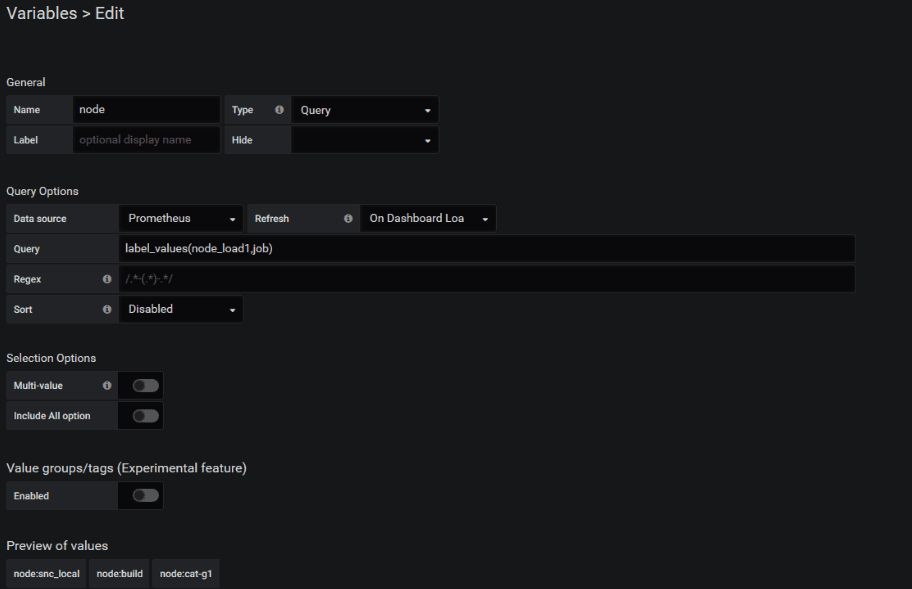

First, let’s create a simple dashboard with a working variable in it.
Embedded imageEmbedded imageEmbedded image
I also created a few edits to the dashboard, so we can see how versioning works. More on that later.

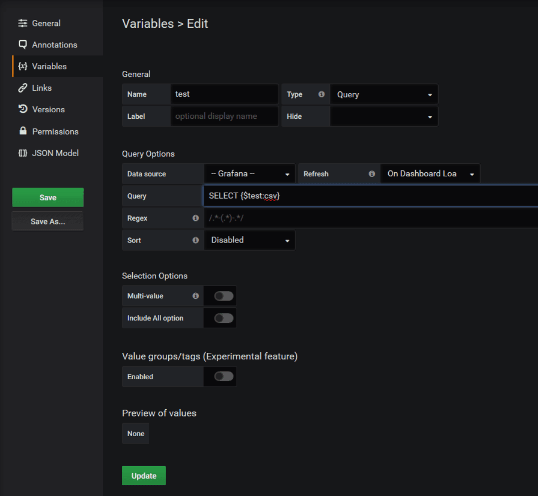

Now let’s break the dashboard by adding a self-referencing variable.
Embedded image

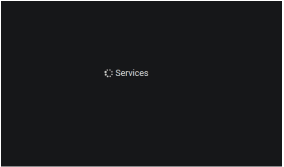

Now, when we load the dashboard, we just see this screen with a spinning “Services” error message.
Embedded image

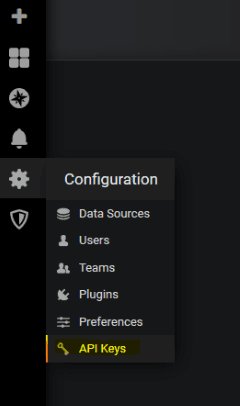

To fix this, we first need to use the API. All the commands here will be run from a regular Linux terminal session, running BASH and using the CURL and JQ commands. The first thing we need to do is create an API key to interact with the API. In Grafana navigate to Configuration -> API Key.
Embedded image
Click “Add API Key” and create one with Admin level privileges. Run the curl command it shows to confirm everything is working. If you pipe that through jquery (jq) you should see the JSON describing the dashboard in detail.

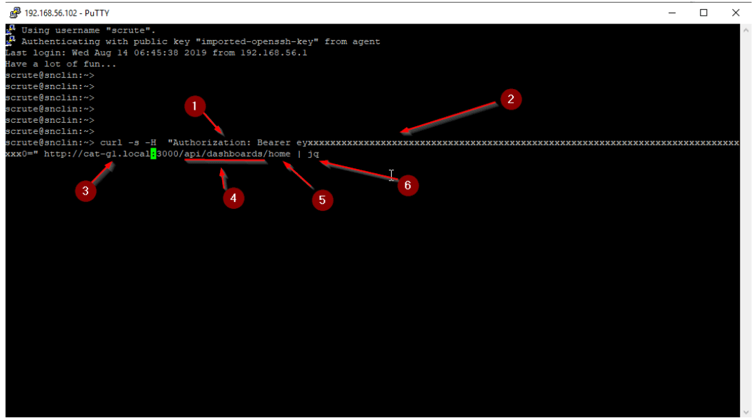

Let’s dissect that curl command line.
Embedded image
  1. The preamble you need in the authorization header
  2. The API key you just generated (obviously this has been obfuscated)
  3. The URL of my test grafana server
  4. The API call URl. These are all documented
  5. The parameter sent to the API call
  6. Pipes the output through jquery, so we can coloured formatting etc.
