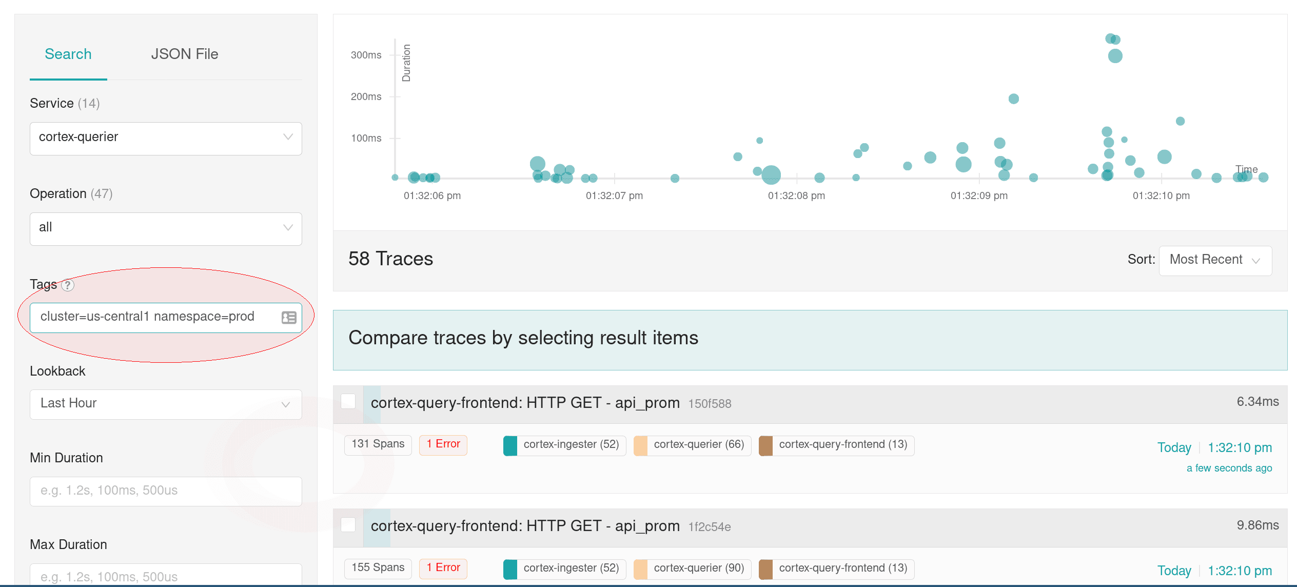

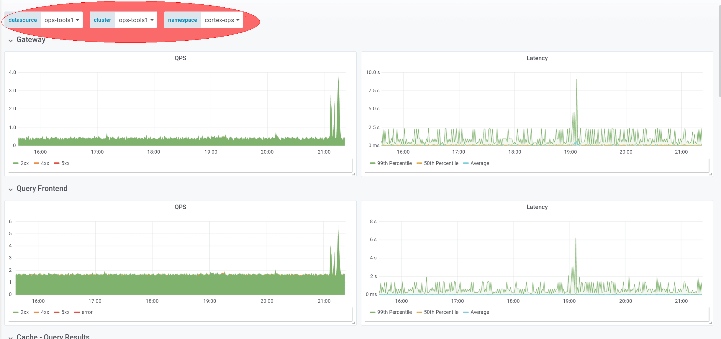

We use Prometheus to enable drilling down into specific traces. We have RED dashboards that highlight which services are slow, and when we see a spike, we can tell what environment it’s in. We can then go to the Jaeger UI to select the traces in the particular time range and environment (identified by namespace + cluster for us), and investigate which functions are taking too long, whether we’re making too many calls, if we could batch calls together, etc. We can then verify the impact of using Jaeger and Prometheus after rolling out the changes.
To enable this, we add the namespace and cluster tags to the env variables. We even published the jsonnet we use to add the tags:

This lets us attach the right tags with just a single line, and using the Prometheus labels we get in our alerts, we can drill down to the right traces:
Embedded image

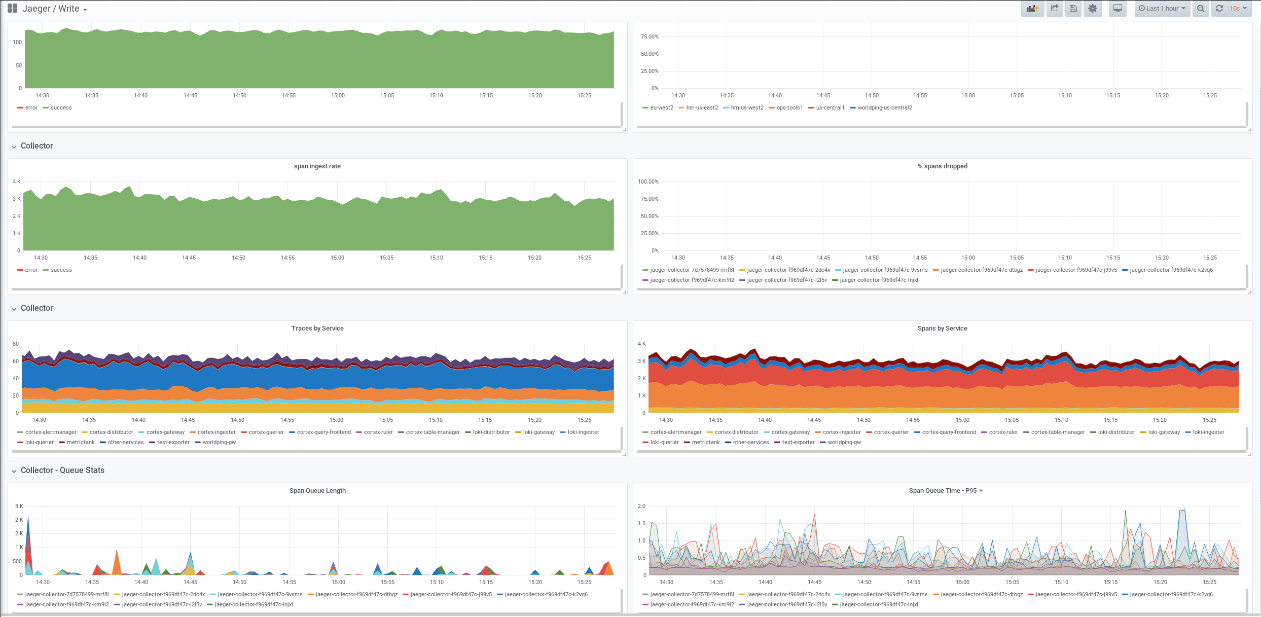

When we set up Jaeger and started running it, we wanted to see if it was working or not. Under heavy load with the original lack of load balancing, we found that we were actually dropping the data (spans). We wanted to know where we were dropping the data, what service was producing how much data, etc., but there were no dashboards or alerts to do this.
So I built a Jaeger mixin, which includes recording rules, dashboards, and alerts, and that gave us a lot of visibility. We’ve since donated the Jaeger mixin to the community.
