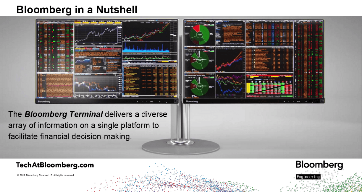

But the main product for the 38-year-old company is actually Bloomberg Terminal, a software system that aggregates real-time market data and delivers financial news to more than 325,000 subscribers around the world. The enterprise premium service handles about 120 billion (that’s billion) pieces of data from financial markets daily, 2 million stories from its news division and affiliates, and a messaging network (think “Instant Bloomberg”) that fields 1 billion messages.
