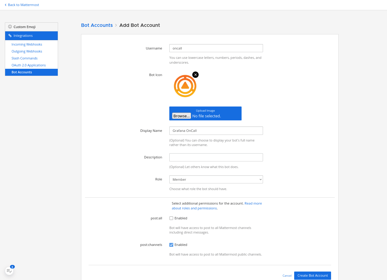

First, let’s create the bot account to access the Mattermost API using its access token:
Mattermost integration menu
Note: you may need to set the System Admin role to allow the bot to update the messages. See this Mattermost FAQ for more information.
You will get a token upon creation; make sure to keep that value at hand.

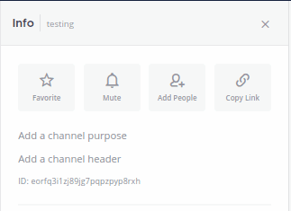

Next, add the bot user as a member in the channel you want the notifications posted to, and get the channel ID from that channel’s information view. To get there, click on the channel name dropdown and you will see the “View Info” option.

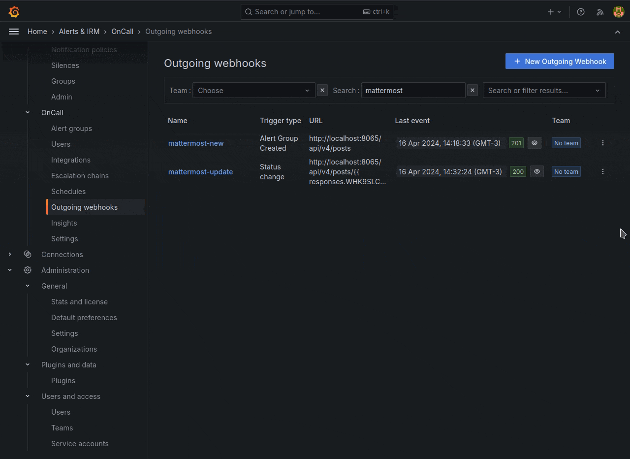

In Grafana OnCall, we will need to configure two webhooks: one to post the notification when an alert group is created (using the “create a post” endpoint), and another to update that notification when the alert group status changes (using the “update a post” endpoint).
Steps to connect Grafana OnCall to Mattermost
Let’s set up the Alert Group Created webhook first:
If you’re following along on your own machine, here is what you need to enter to achieve what you see in the steps outlined in the GIF above:
  • Name: mattermost-new
  • Enabled: True
  • Trigger type: Alert group created
  • HTTP method: POST
  • Authorization header: Bearer [your token]
  • Forward all: False
  • Data:
    { “channel_id”: “eorfq3i1zj89jg7pqpzpyp8rxh”, “message”: “:large_orange_circle::large_green_circle::white_circle::red_circle: {{ alert_group.title }}\n*{{ alert_group.state }}\n{{ alert_payload.message }}\n{{ integration.name }}*\n\nAcknowledged by: {{ user.username }}****Resolved by: {{ user.username }}****Silenced by: {{ user.username }} (until {{ event.until }})\n\n[View in Grafana OnCall]({{ alert_group.permalinks.web }})” }

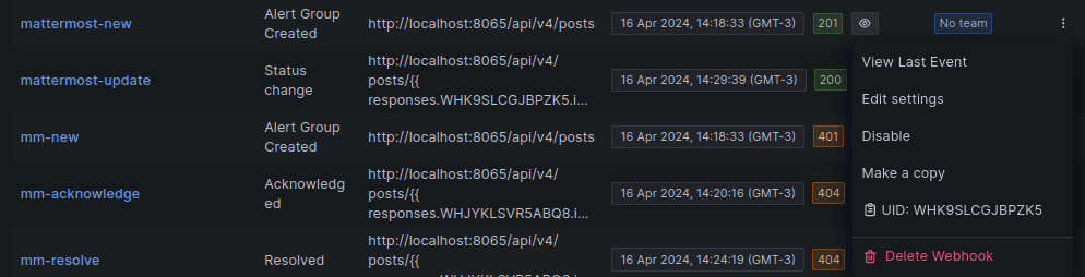

To update a sent notification, you need to have the original message ID. This ID is included in the response after triggering the webhook we just created. Grafana OnCall webhooks maintain a record of previous responses linked to an alert group, allowing us to reference this information in our update webhook.
Outgoing webhook details
Then, we can use the template expression {{ responses.WHK9SLCGJBPZK5.id }} to reference the id field from the previous response to the webhook with ID WHK9SLCGJBPZK5, corresponding to the same alert group triggering the status change. (This is the mattermost-new webhook. You can get this ID from the webhooks listing UI; see below.)
Webhook listings
With that in mind, we will set up the Alert Group Status Change webhook now. Here is the information you’ll need to enter to configure your webhook:
  • Name: mattermost-update
  • Enabled: True
  • Trigger type: Alert group status change
  • HTTP method: PUT
  • Webhook URL: (Use your mattermost-new webhook ID instead.) http://localhost:8065/api/v4/posts/{{ responses.WHK9SLCGJBPZK5.id }}
  • Data: (Use your mattermost-new webhook ID instead.)
    { “id”: “{{ responses.WHK9SLCGJBPZK5.id }}”, “message”: “:large_orange_circle::large_green_circle::white_circle::red_circle: {{ alert_group.title }}\n*{{ alert_group.state }}\n{{ alert_payload.message }}\n{{ integration.name }}*\n\nAcknowledged by: {{ user.username }}****Resolved by: {{ user.username }}****Silenced by: {{ user.username }} (until {{ event.until }})\n\n[View in Grafana OnCall]({{ alert_group.permalinks.web }})” }

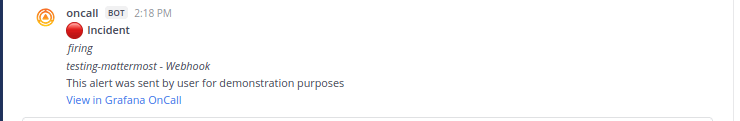

And that’s it! If you send a demo alert, you should get a notification similar to this one:
Incident firing message in Grafana Oncall

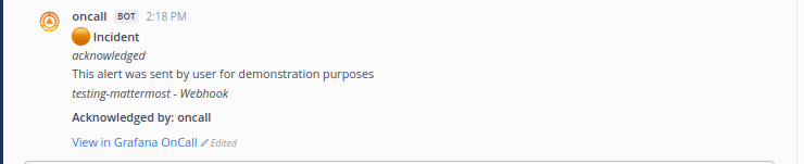

Which, after acknowledging, will be updated to:
Incident acknowledged message from Grafana Oncall

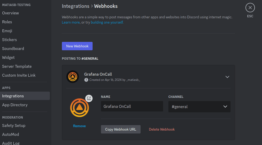

Discord is an instant messaging and VoIP social platform that supports voice calls, video calls, text messaging, and media and files. For this integration, the plan is to create a bot that will post alert group details to a channel and keep those alert groups’ status and information up to date.
In this case we will use Discord webhooks to implement the notifications:
Discord integration UI
Through a webhook URL we can do multiple operations. For our purposes, we are interested in:
Note: when creating a message we will need to set the ?wait=true query param to get a response with the created message information, which we will need to update that message later.

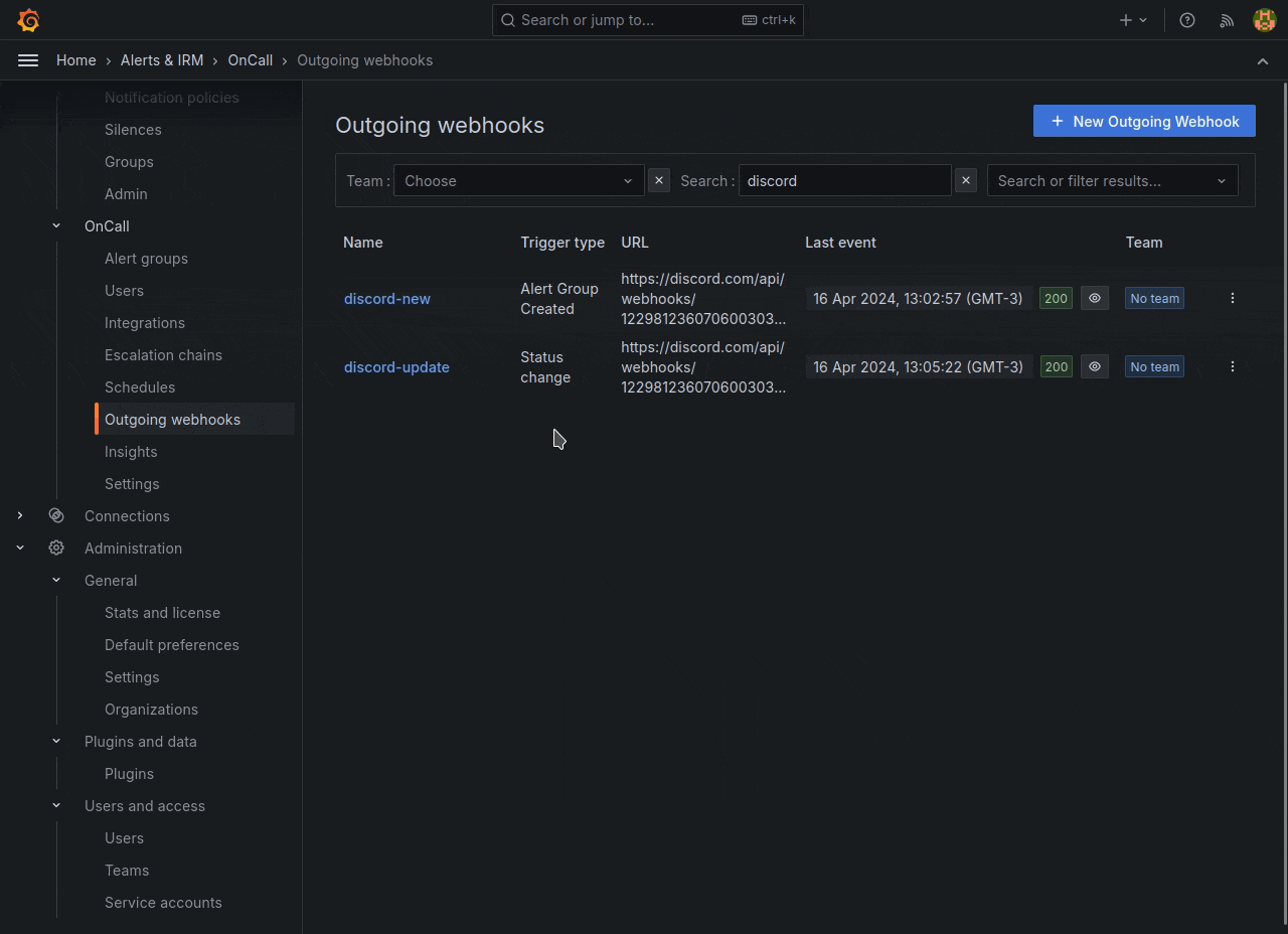

Similar to what we did for Mattermost, we need to create the Grafana OnCall webhooks following the linked API’s specification:
Steps to connect to Discord in Grafana Oncall
Here is what you need to enter to achieve what you see in the steps outlined in the GIF above:
  • Name: discord-new
  • Enabled: True
  • HTTP method: POST
  • Webhook URL: [your Discord webhook URL]?wait=true
  • Data:
    { “content”: “:orange_circle::green_circle::white_circle::red_circle: {{ alert_group.title }}\n*{{ alert_group.state }}\n{{ alert_payload.message }}\n{{ integration.name }}*\n\nAcknowledged by: {{ user.username }}****Resolved by: {{ user.username }}****Silenced by: {{ user.username }} (until {{ event.until }})\n\n[View in Grafana OnCall]({{ alert_group.permalinks.web }})” }
For the update webhook, we will use the message id from the previous discord-new response in the URL path:
  • Name: discord-update
  • Enabled: True
  • HTTP method: PATCH
  • Webhook URL: (Use your discord-new webhook ID instead.) [your Discord webhook URL]/messages/{{ responses.WH5PXWNJ7MT9Y5.id }}
  • Data:
