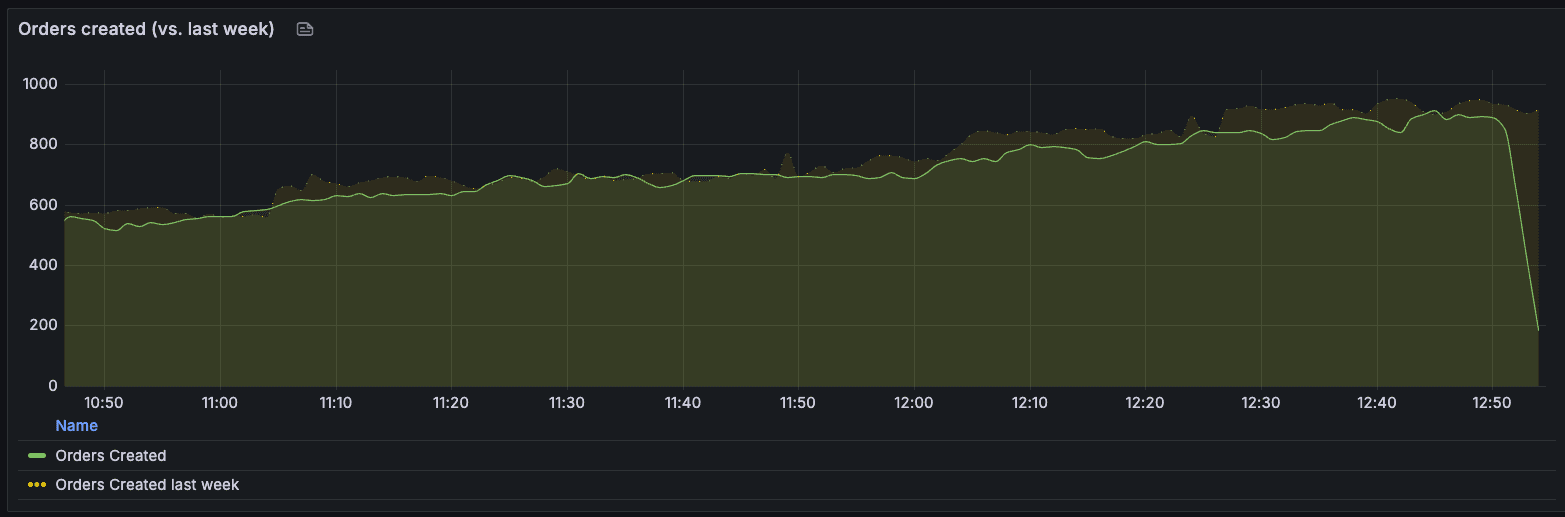

One of Glovo’s most important metrics is used to track orders created. The volume changes throughout the day, with more orders around lunch and dinner times. And as you can imagine, incidents that occur during those busier times have an outsized impact. So going back to our example from the beginning, this is not what you want to see as you close in on 1 p.m.:
Grafana dashboard shows a big drop in orders created
“As SREs, we are kind of in the dark when such incidents happen because any part of our distributed system could fail causing the order loss,” Deepika said. “So we built many custom dashboards and metrics in Grafana, which helps us during such incidents.”
In this example, engineers dug deeper into a RED metrics dashboard and learned it was a downstream dependency that failed because it was rate limiting checkouts. From there, they learned that it was tied to a code change and quickly rolled back the deployment. In under five minutes, they were back to normal.
