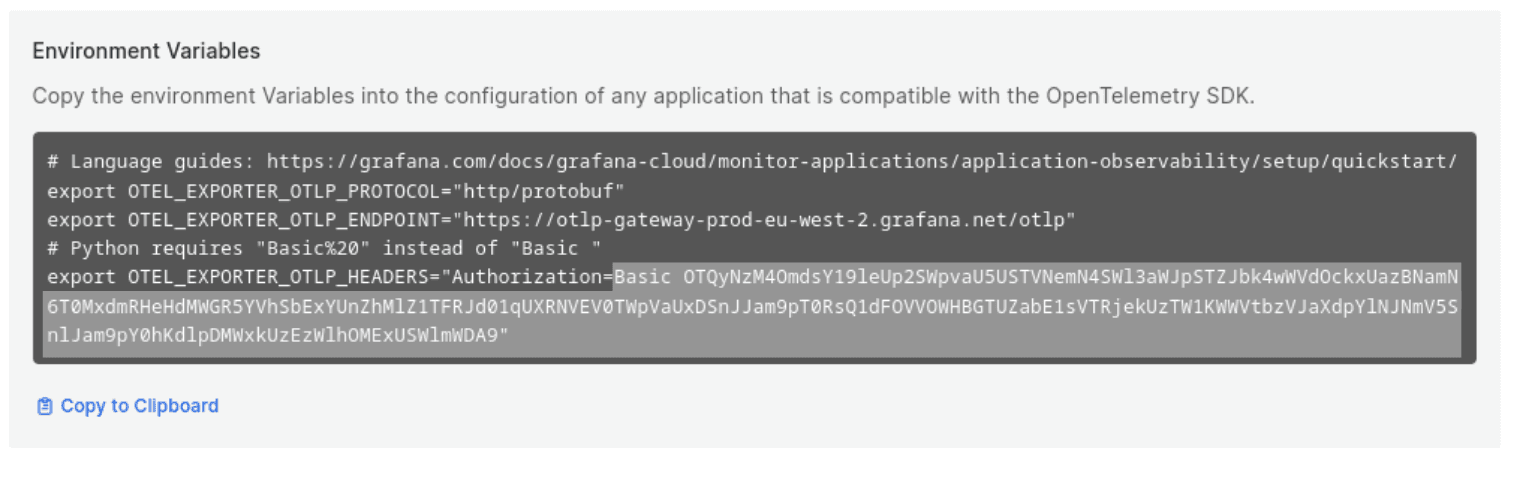

Also on that page, we can look at the environment variable OTEL_EXPORTER_OTLP_HEADERS that is shown after generating a token. Keep this handy, as we’ll need the value of the Authorization header later.

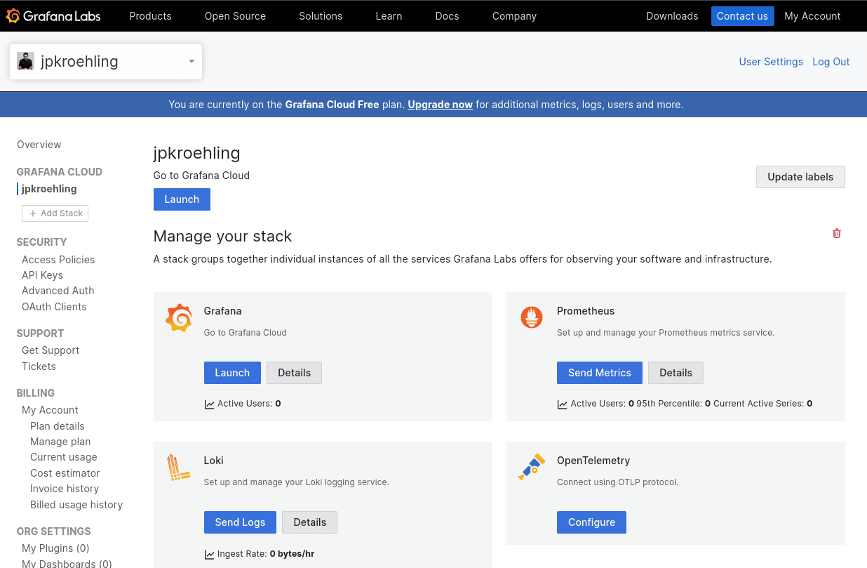

- Change the configuration file to include the correct value for the
Basicauthentication header and endpoint - Run the OpenTelemetry Collector:otelcol-contrib --config ./otelcol.yaml

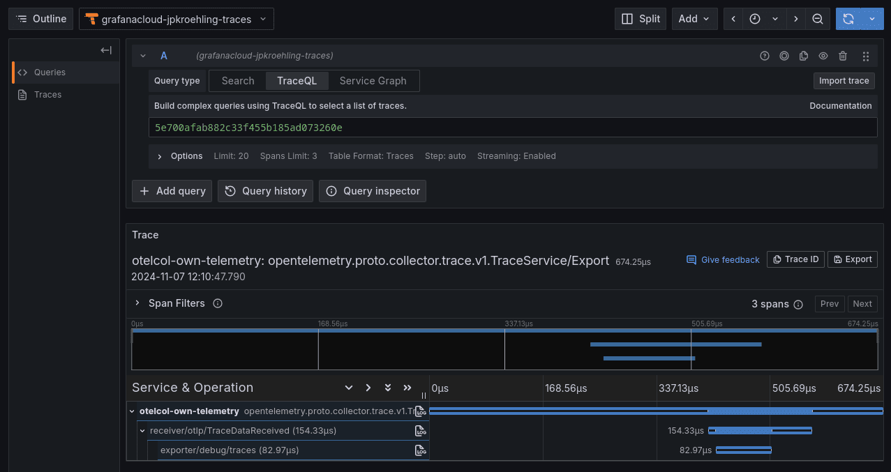

- Send some telemetry to the Collector. By default, each trace reported by
telemetrygencomes with two spans. Note that this telemetry will be discarded with the configuration provided, but the actions the Collector performed will be recorded:telemetrygen traces --traces 1 --otlp-insecure --otlp-attributes=‘cookbook=“own-telemetry”’ - On Grafana Cloud, select the traces data source and you’ll be able to find a trace that represents the Collector processing of the
telemetrygencall:

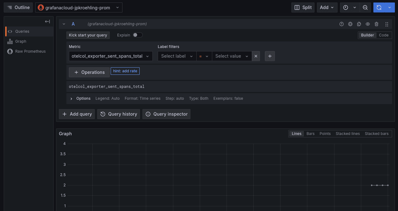

- Now, change to your metrics data source, and select the metric
otelcol_exporter_sent_spans_total. We can see that our Collector reported that it received the two spans.
Tasting notes
We’ve now seen that we can observe the Collector to understand what it is doing—we have easy access to its metrics and traces. But what about the logs?

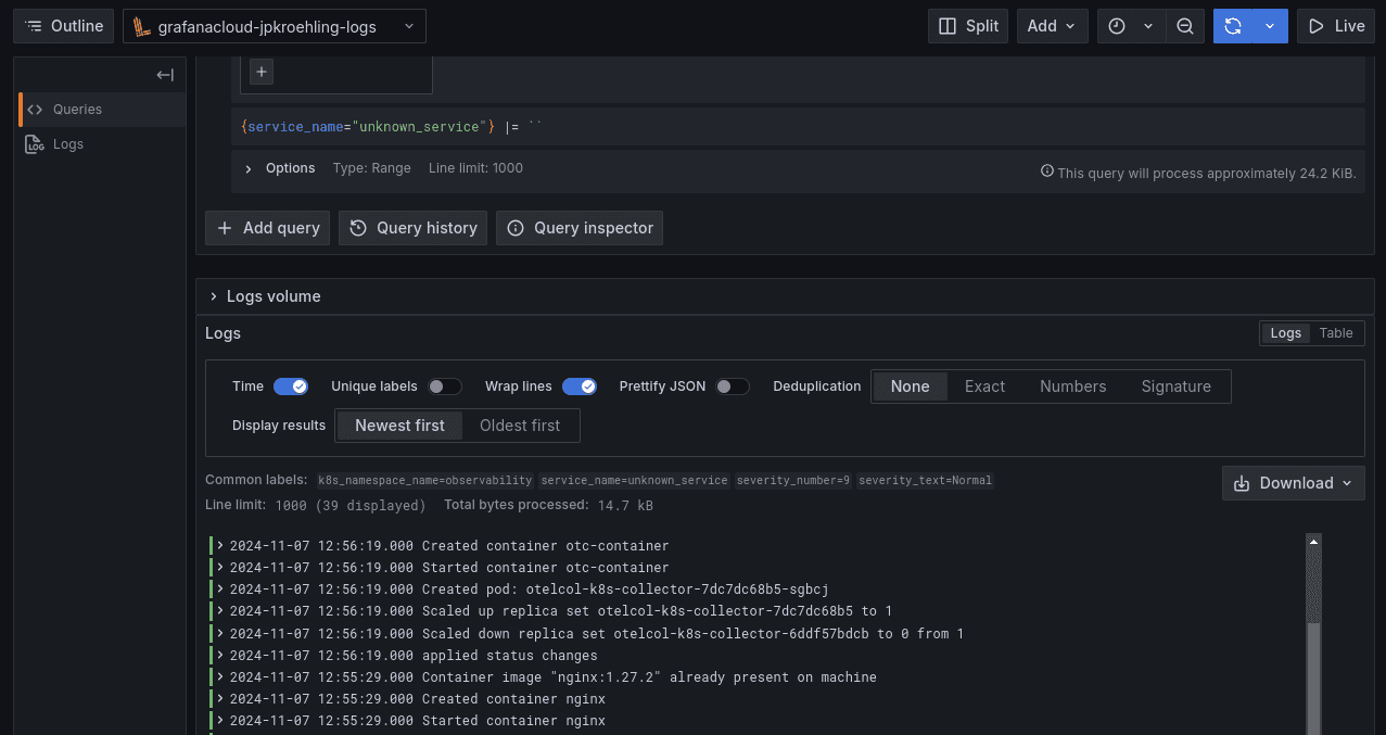

- We’ll now configure our Collector to obtain metrics and events (as logs) from the Kubernetes cluster.apiVersion: opentelemetry.io/v1beta1 kind: OpenTelemetryCollector metadata: name: otelcol-k8s namespace: observability spec: image: ghcr.io/open-telemetry/opentelemetry-collector-releases/opentelemetry-collector-contrib:0.113.0 serviceAccount: otelcol-k8s envFrom: - secretRef: name: grafana-cloud-credentials config: extensions: basicauth: client_auth: username: “${env:GRAFANA_CLOUD_USER}” password: “${env:GRAFANA_CLOUD_TOKEN}” receivers: k8s_events: {} k8s_cluster: collection_interval: 15s exporters: otlphttp: endpoint: https://otlp-gateway-prod-eu-west-2.grafana.net/otlp auth: authenticator: basicauth
- If you don’t have a workload running in your Kubernetes cluster, this one should be enough to generate a few events.apiVersion: apps/v1 kind: Deployment metadata: name: nginx-deployment spec: selector: matchLabels: app: nginx template: metadata: labels: app: nginx spec: containers: - name: nginx image: nginx:1.27.2 ports: - containerPort: 80

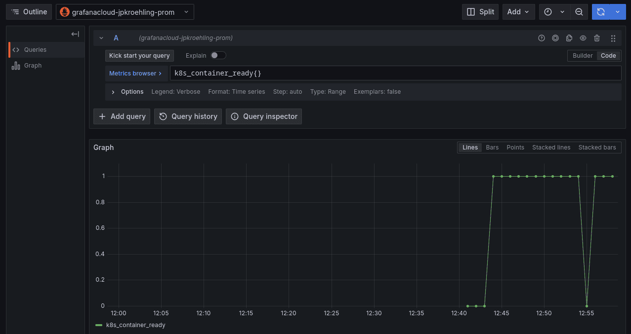

- At this point, you should have received a few events in your Grafana Cloud instance.
- Kubernetes metrics, such as
k8s_container_ready, should also be available.

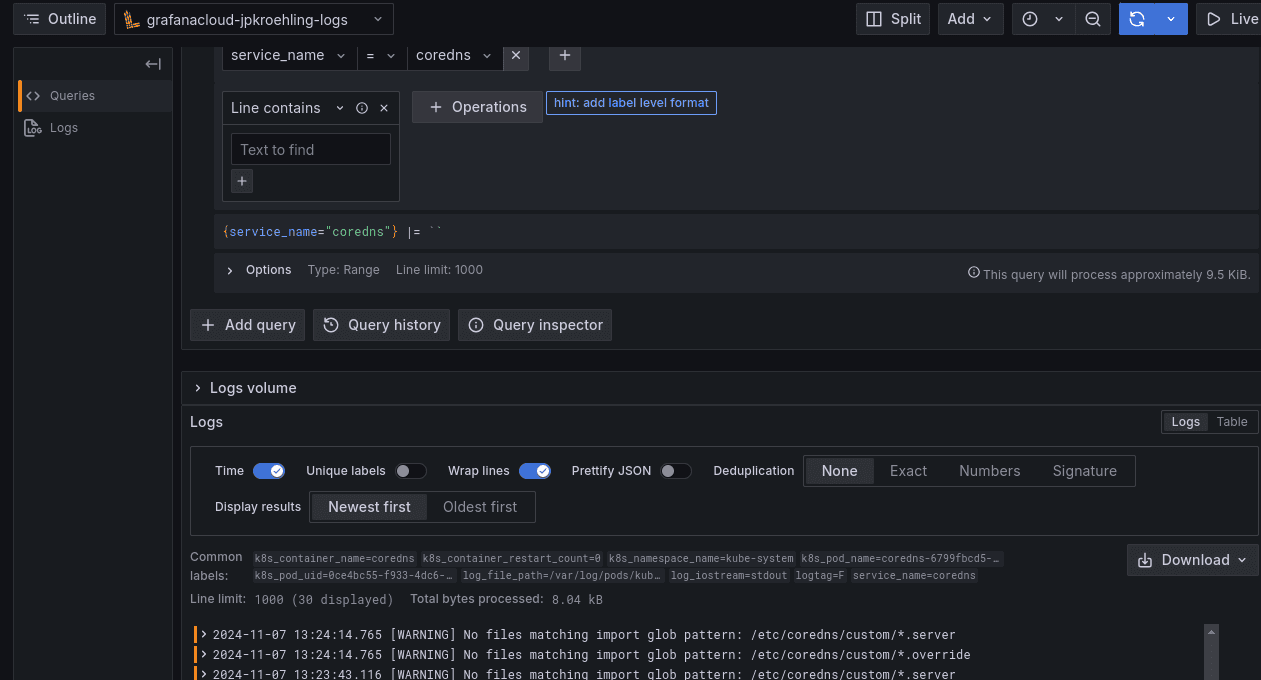

- Make sure you have a Kubernetes cluster and an OTel Operator running. Feel free to reuse the one you configured in the previous recipe.
- Next, create a custom resource with the following configuration.apiVersion: opentelemetry.io/v1beta1 kind: OpenTelemetryCollector metadata: name: otelcol-podslogs namespace: observability spec: image: ghcr.io/open-telemetry/opentelemetry-collector-releases/opentelemetry-collector-contrib:0.113.0 mode: daemonset envFrom: - secretRef: name: grafana-cloud-credentials volumes: - name: varlogpods hostPath: path: /var/log/pods volumeMounts: - name: varlogpods mountPath: /var/log/pods readOnly: true config: extensions: basicauth: client_auth: username: “${env:GRAFANA_CLOUD_USER}” password: “${env:GRAFANA_CLOUD_TOKEN}” receivers: filelog: exclude: [] include: - /var/log/pods///*.log include_file_name: false include_file_path: true operators: - id: container-parser max_log_size: 102400 type: container retry_on_failure: enabled: true start_at: end exporters: otlphttp: endpoint: https://otlp-gateway-prod-eu-west-2.grafana.net/otlp auth: authenticator: basicauth
- After a few moments, you should start seeing logs from the containers in the cluster.

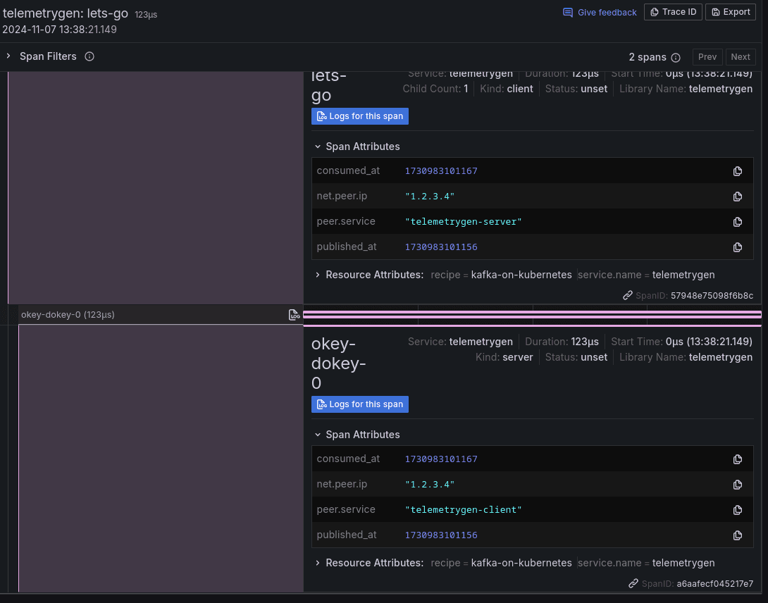

- Now, we need to send some telemetry to our “pub” Collector. If we don’t have a workload in the cluster available, we can open a port-forward to the Collector that is publishing to Kafka and send data via
telemetrygento it:kubectl port-forward svc/otelcol-pub-collector 4317 telemetrygen traces --traces 2 --otlp-insecure --otlp-attributes=‘recipe=“kafka-on-kubernetes”’ - You should now see two new traces in your Grafana Cloud Traces view, like the following. Note that we are adding new attributes to the spans, recording the timestamp when they were placed at topic (
published_at) and retrieved from it (consumed_at).
