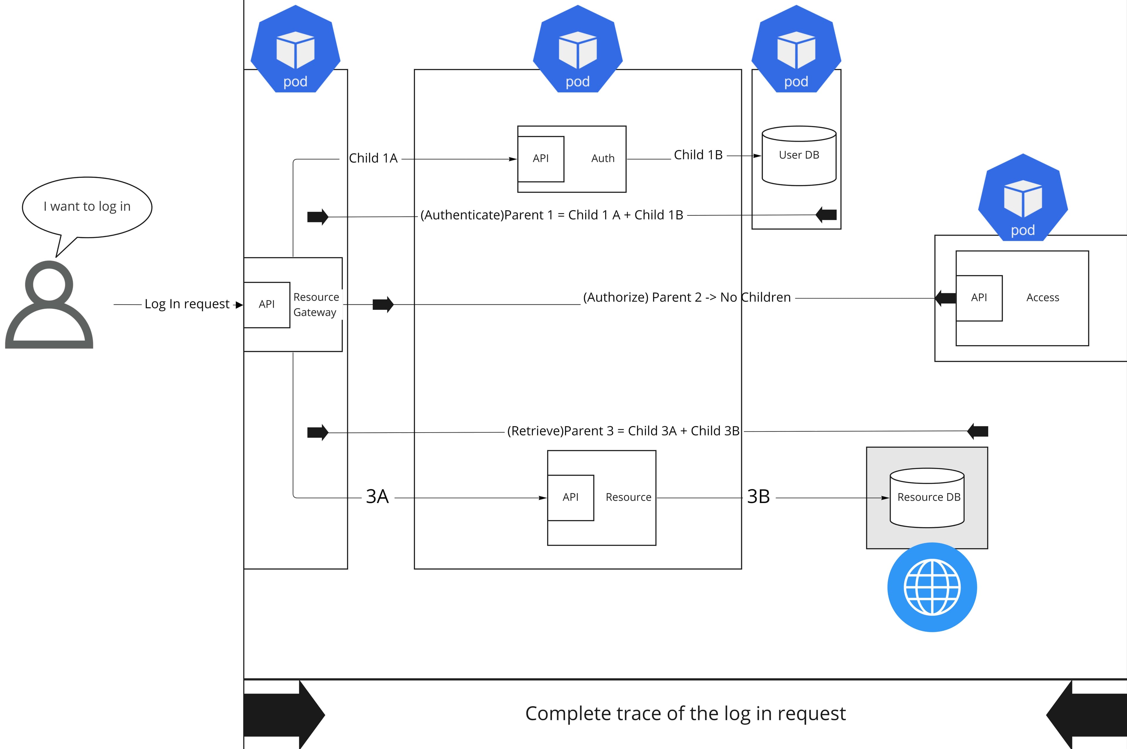

Distributed tracing follows the path of a request through that complex system of interactions. It provides the sequence and timing of the microservices or actions triggered within or outside the container, pod, node, or even cluster. Look at the desired result below to see how this is done:
An architectural diagram outlines a simplified version of a distributed system.
The image above is a simplified representation of a distributed system, where each microservice has its API, each microservice is in its own pod, and one database is external. Each line represents an interaction. Other concepts used here are spans and trace context, e.g., What does the trace include? Here’s some additional background information on spans and trace context:
  • Spans. Think of a span as a single unit of work, such as an operation or interaction, with a unique name and timestamp. A trace can be made up of one or multiple spans. In the example shown above, the parent span represents the original user request, and each subsequent span is a unique operation within the distributed system.
  • Trace context. According to the World Wide Web Consortium (W3C), a trace context is a specification that “standardizes how context information is sent and modified between services.” This specification provides a unique identifier to each individual request, which enables you to track vendor-specific metadata even if different tracing tools are used in the same transaction.
Developers and admins use distributed tracing tools to gain insights into the performance of user requests as they interact with other services by dividing each trace into spans, whose propagation is recorded using the trace context specification. Although this approach is simple, its implementation requires different components, which will be discussed below.

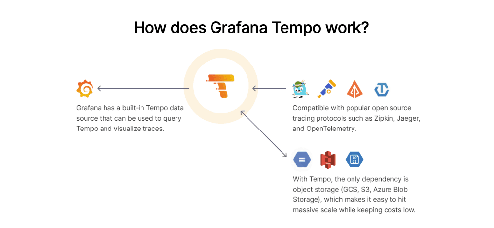

Distributed tracing tools work similarly and generally use the same components. However, there can be differences in the way they are implemented, their architecture, and even the tracing protocols used. For the purposes of this guide, we’ll use Grafana Tempo as our example.
An illustrating showing how Grafana Tempo works with tracing protocols, object storage, and Grafana.
Like most distributed tracing ecosystems, Grafana Tempo relies on four components to make it useful:
  1. Instrumentation. In simple terms, this component provides the telemetry data that will later be collected — traces, in this case — but it can also generate metrics and logs used by other tools. There are different standards for collecting telemetry data for applications and services, which we’ll cover later. Grafana Tempo supports OpenTelemetry (via OTLP), Zipkin, and Jaeger protocols for collecting telemetry data. There are libraries and frameworks that allow developers to generate traces from the application code, but as of v1.22, Kubernetes system components can also transmit traces using the OpenTelemetry protocol.
  2. Pipeline. Distributed tracing tools usually receive telemetry data from multiple sources simultaneously, so you’ll need to optimize the resources used by the tool as the application scales. To this end, tracing pipelines perform functions such as data buffering, trace batching, and subsequent routing to the storage backend. For this important task, Grafana Tempo can use the Grafana Agent, which is the same telemetry collector used to scrape metrics and logs in the Grafana ecosystem.
  3. Storage backend. After the traces are collected, they must be stored for later visualization and analysis. You need a storage backend capable of scaling with the application without consuming too many resources in the process. Grafana Tempo takes an innovative approach: Instead of relying on resource-hungry, in-memory databases, it uses popular object storage solutions such as Amazon S3, Google Cloud Storage, and Microsoft Azure Blob Storage as its trace storage backend. If needed, query performance can be optimized by using Memcached or Redis.
  4. Visualization layer. Tempo can be coupled with Grafana for visualizations and to create dynamic dashboards that correlate metrics, logs, and traces in Kubernetes.
