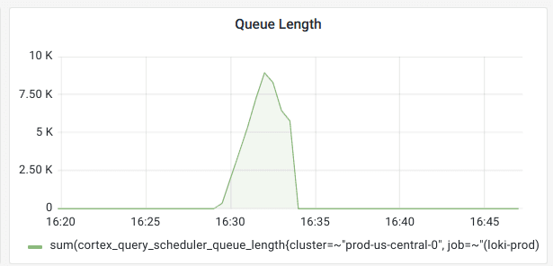

At this point, I feel pretty confident that our read path was entirely saturated with expensive queries that caused queriers to restart due to running out of memory. This, in turn, prevented other tenants from using these resources until queriers restarted. Afterward, we see more queries waiting in queue in the query scheduler:
Embedded image
