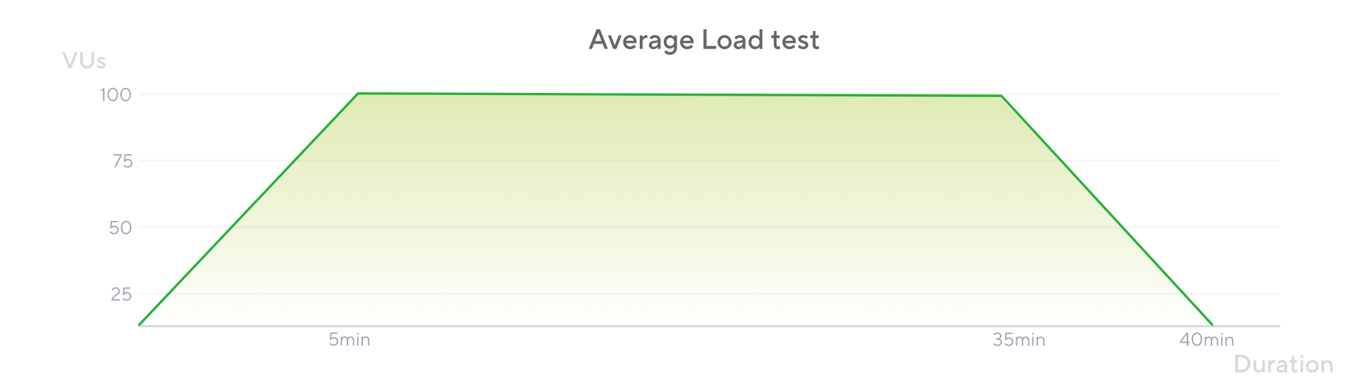

A chart depicting the duration and throughput of an average load test.
In an average load test, you gradually ramp up to the desired value of virtual users or throughput, stay there for the indicated period, then ramp down.
