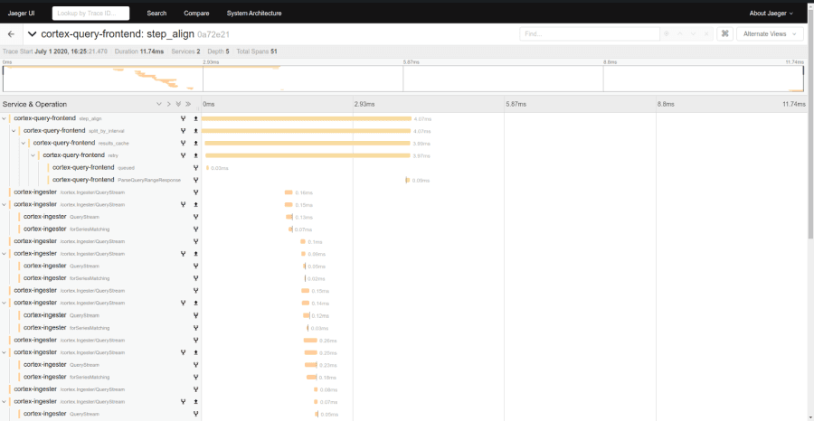

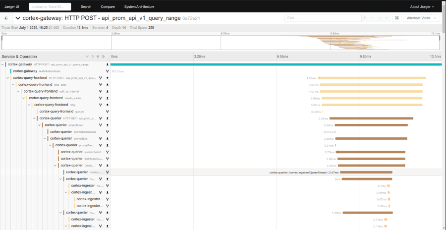

But first! Before you go diving into your infrastructure attempting to piece together where a span may have been lost, just refresh.
The Jaeger UI will often find traces in your backend that match your search criteria, but they haven’t been fully ingested. This is particularly common in extremely recent traces.
Before F5:
Embedded image
After F5:
Embedded image
If refreshing fails you, then it’s time to start looking at different elements of span ingestion and trying to figure out where spans are being dropped.

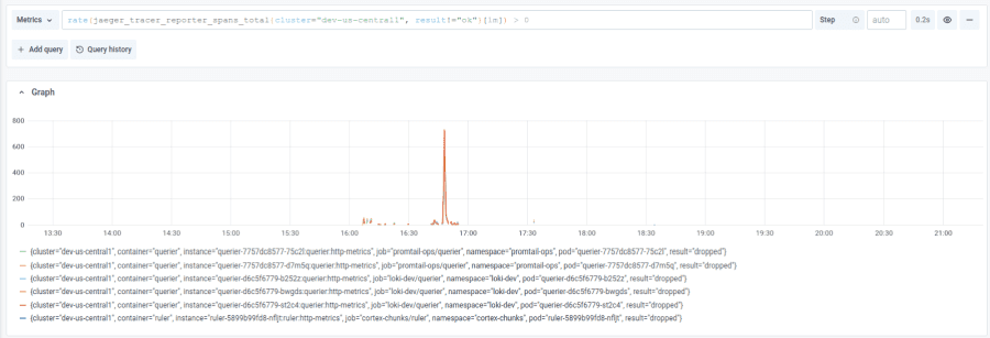

We are going to start in the process responsible for producing spans and move toward our backend, checking metrics as we go. For in-process metrics, we want to look at jaeger_tracer_reporter_spans_total. This particular metric is produced by the Jaeger Go Client and can tell us when spans are dropped before they make it off the process:
Embedded image
We can see here that there was a spike of dropped spans from some Loki components that resulted in broken traces.
Thrift clients also should be reporting dropped spans to the agent. These dropped spans are exposed as the metric jaeger_agent_client_stats_spans_dropped_total by the Jaeger Agent itself. Try both and see what works better for you!
The fix!
The Jaeger client internally buffers spans in a queue while it is sending them to the Jaeger Agent. Having dropped spans simply means that your process filled the queue faster than it was capable of offloading them. Two options for fixing this are:
Increase the queue size using the environment variable JAEGER_REPORTER_MAX_QUEUE_SIZE. Move the agent closer to the process. For instance, you could run it on the same machine or in a sidecar.
Other possibilities
Unfortunately, there is another possibility at this point that’s more difficult to diagnose. By default, your process will be using Thrift Compact over UDP to communicate with the agent. UDP is a best-effort protocol, and it’s possible that packets are dropped without either the agent or the process being aware. In this case I’d recommend consulting network metrics published by a tool like node exporter.
Additionally, if your clients are up to date with the latest changes to the Thrift protocol, the agent will print jaeger_agent_client_stats_batches_received_total and jaeger_agent_client_stats_batches_sent_total. These values can be used to determine if batches are being dropped between client and agent. However, this is not universally supported.
