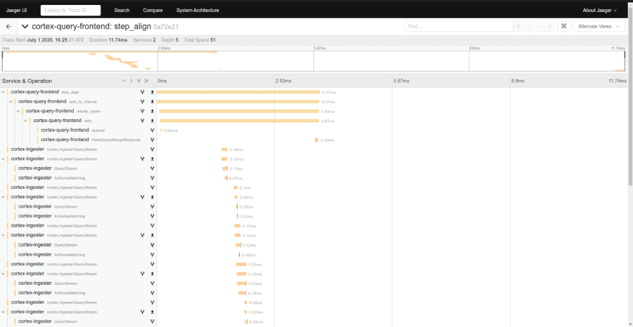

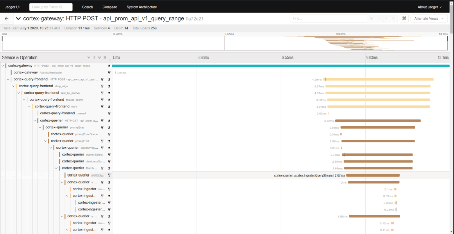

Before F5:
Embedded image
After F5:
Embedded image

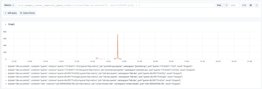

We are going to start in the process responsible for producing spans and move toward our backend, checking metrics as we go. For in-process metrics, we want to look at jaeger_tracer_reporter_spans_total. This particular metric is produced by the Jaeger Go Client and can tell us when spans are dropped before they make it off the process:
Embedded image
We can see here that there was a spike of dropped spans from some Loki components that resulted in broken traces.
Thrift clients also should be reporting dropped spans to the agent. These dropped spans are exposed as the metric jaeger_agent_client_stats_spans_dropped_total by the Jaeger Agent itself. Try both and see what works better for you!
The fix!
The Jaeger client internally buffers spans in a queue while it is sending them to the Jaeger Agent. Having dropped spans simply means that your process filled the queue faster than it was capable of offloading them. Two options for fixing this are:
Increase the queue size using the environment variable JAEGER_REPORTER_MAX_QUEUE_SIZE. Move the agent closer to the process. For instance, you could run it on the same machine or in a sidecar.

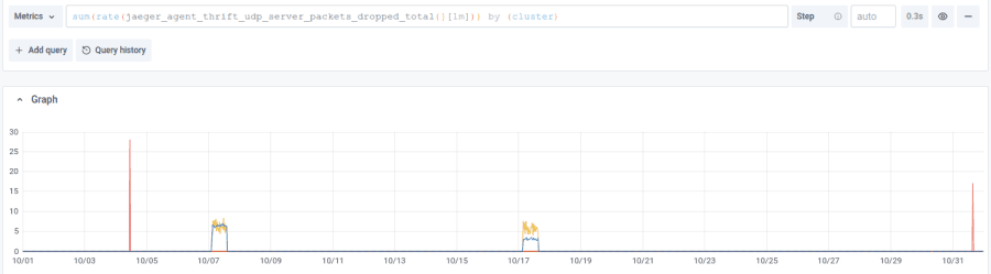

On the agent I’d recommend paying attention to the jaeger_agent_thrift_udp_server_packets_dropped_total metric. This metric will indicate if the agent is incapable of clearing its queue fast enough as it is forwarding spans to the Jaeger Collector.
Embedded image
The fix!
If you’re seeing spikes in this metric, consider:
Increasing the queue size. Note that there are different switches for different protocols. Most people will be using jaeger-compact.
--processor.jaeger-binary.server-queue-size int         length of the queue for the UDP server (default 1000)
--processor.jaeger-compact.server-queue-size int        length of the queue for the UDP server (default 1000)
--processor.zipkin-compact.server-queue-size int        length of the queue for the UDP server (default 1000)
Adding more Jaeger Agents to spread the load better or adding more Jaeger Collectors to consume them faster.
It’s also worth checking other metrics such as jaeger_agent_client_stats_batches_received_total to determine if there is an imbalance in traffic to your agents.

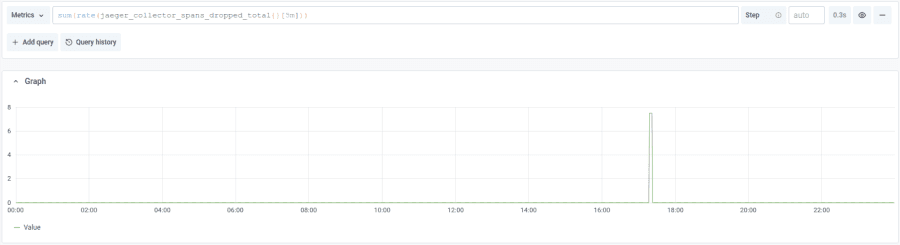

The Jaeger Collector also has a queue, but is a little different because it relies on an external backend such as Kafka, Elasticsearch, or Cassandra. In this case the metric we want to watch is jaeger_collector_spans_dropped_total. Kafka is generally very quick to consume spans, and so in our infrastructure, this is one of the least likely places to see dropped spans.
Embedded image
The fix!
You can probably guess the pattern now. Configure that queue!
There are two primary options to adjust the performance of the collector queue. Here at Grafana Labs, we have set the queue size to 10000 and set the number of workers to 100 (YMMV).
--collector.num-workers int                       The number of workers pulling items from the queue (default 50)
--collector.queue-size int                        The queue size of the collector (default 2000)
If you’re feeling experimental, there is a new option that allows you to configure the maximum amount of memory available to the collector queue. This option can cause elevated CPU but comes with the added benefit of publishing span size metrics.
-collector.queue-size-memory uint                (experimental) The max memory size in MiB to use for the dynamic queue.
If you are having persistent issues here, I would also consider reviewing the jaeger_collector_save_latency histogram and adjust your backend accordingly.
