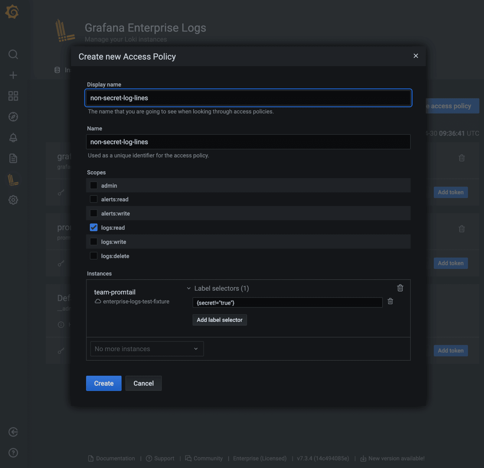

To exclude logs that have a specific label, you can create a label policy that excludes all log lines with the label secret=true by adding a selector with secret!="true" when you create an access policy.

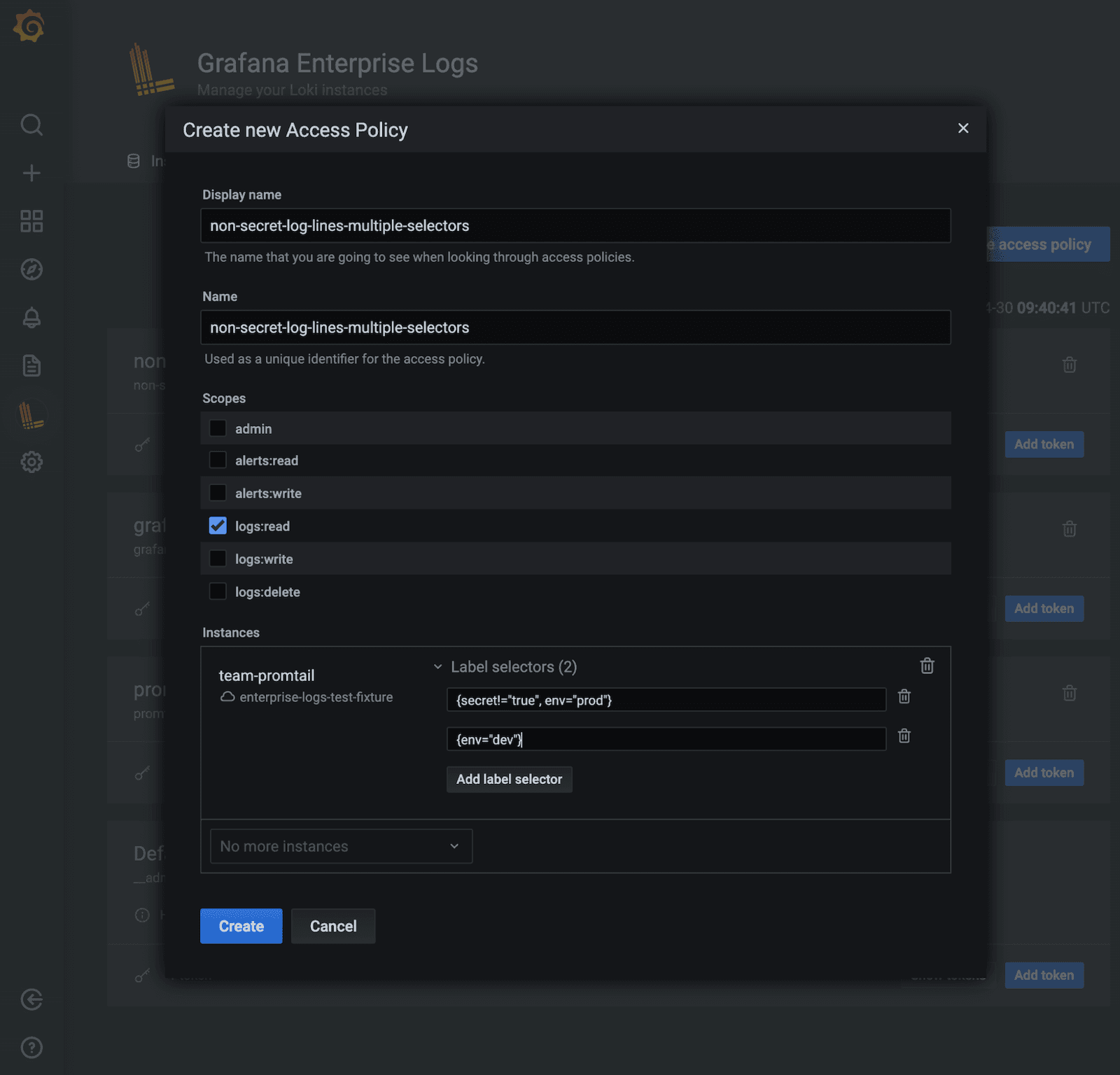

You could also use multiple selectors to create a policy that allows someone to access the production and development environments and exclude logs with the label secret=true in the production environment.
