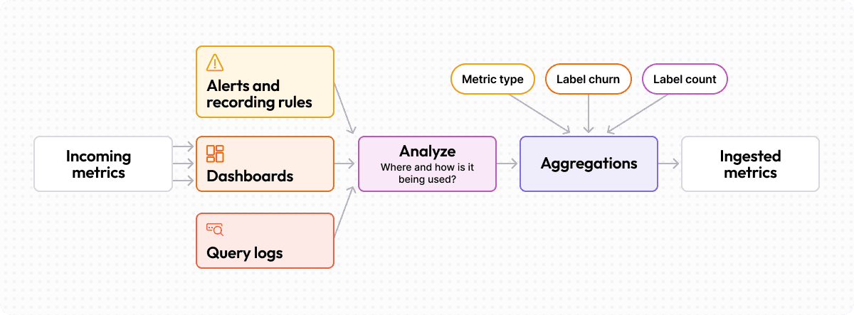

Adaptive Metrics was our first foray into this space. Introduced in 2023, it aggregates unused and partially used metrics into lower cardinality versions of themselves to reduce costs. To date, Adaptive Metrics has delivered a 35% reduction in metrics costs on average for more than 1,500 organizations.
Embedded image
As you can see from the workflow above, Adaptive Metrics analyzes how metrics are used—across dashboards, alerts, and queries—and classifies them to optimize data retention, ensuring you store only what matters.

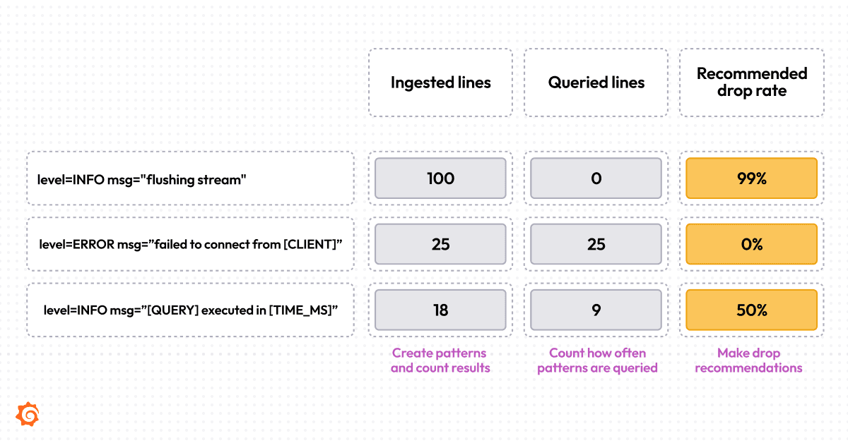

Introduced at ObservabilityCON 2024, Adaptive Logs uses AI/ML techniques to analyze observability data at a scale that wouldn’t be feasible with manual processes. It identifies commonly ingested log patterns and creates a set of customized recommendations for dropping unused telemetry.
The mechanics of Adaptive Logs and Adaptive Metrics are fairly similar. They both analyze usage and create recommendations that translate to reduced ingestion and cost savings. However, Adaptive Logs differs slightly in that it groups logs into patterns responsible for high log volumes. It also drops a percentage of logs, rather than aggregating them like Adaptive Metrics does.
Embedded image
Each of the lines in the chart above represents a hypothetical pattern generated by Adaptive Logs. In the middle example, you can see the logs are queried frequently, so the recommendation is to keep them all. For patterns that are queried infrequently or not at all, Adaptive Logs recommends dropping a certain percentage of those logs.

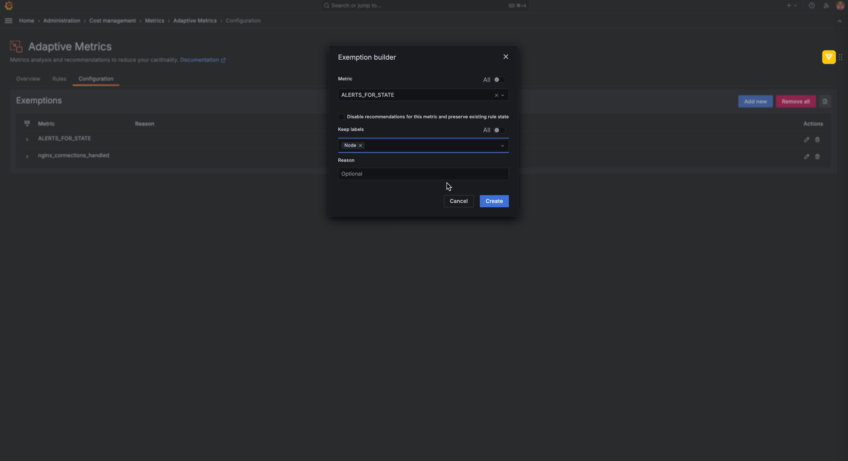

Exemptions let you identify and preserve the signals you can’t afford to lose—whether it’s specific metrics tied to SLAs or critical labels needed for detailed investigations. You have full control to ensure that, even as you optimize costs, your most important data is always available when you need it.
Embedded image
With Exemptions, you don’t have to choose between saving money and safeguarding your telemetry.
Whether it’s protecting vital metrics or retaining key labels, Exemptions give you the confidence to trust your observability—even in the most critical scenarios.
