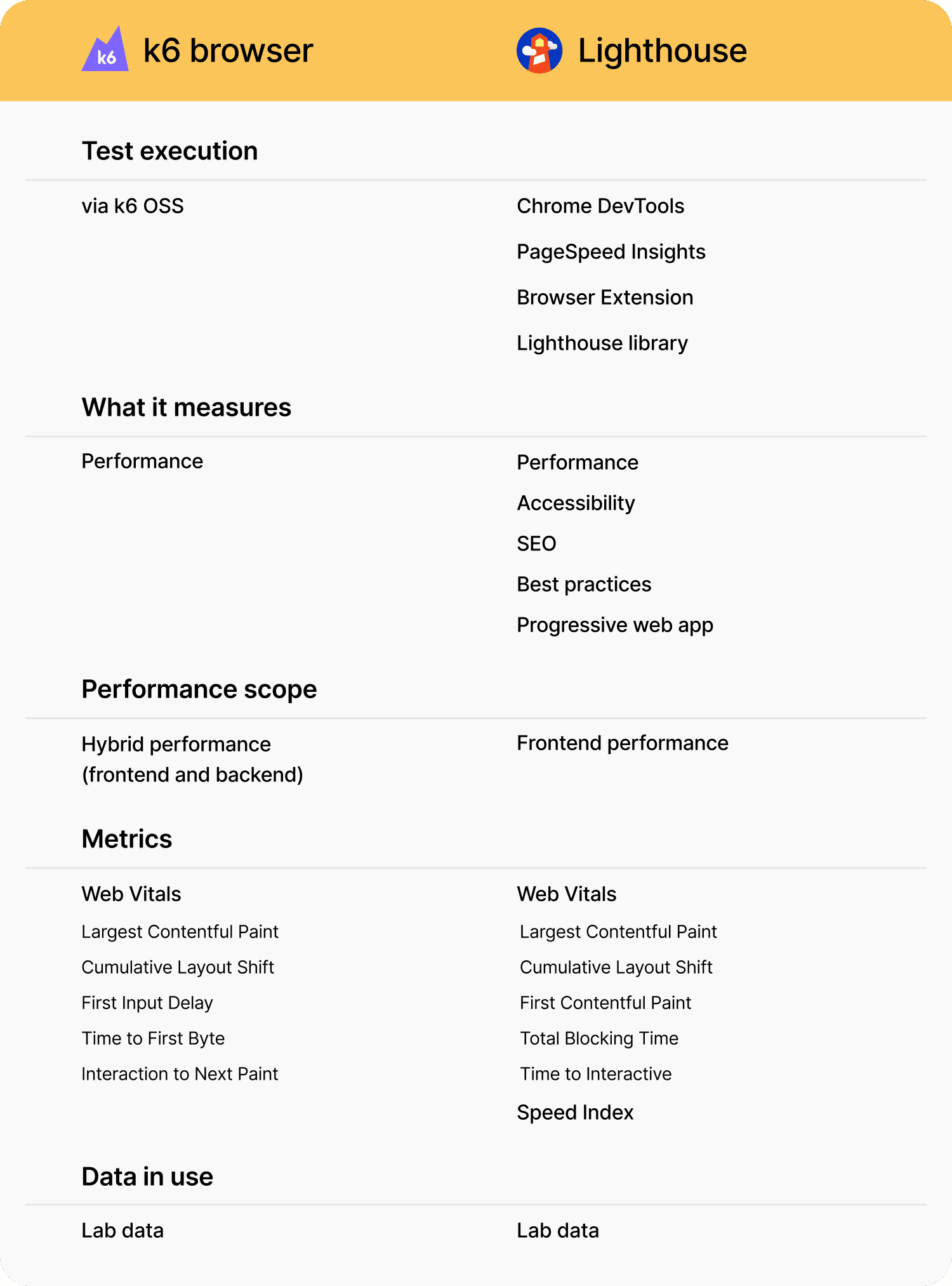

Web performance tools comparison
Again, while both k6 browser and Google Lighthouse measure web application performance, they differ in several ways.
The table below summarizes key comparison points between k6 browser and Lighthouse:
Feature comparison for k6 vs. Google Lighthouse

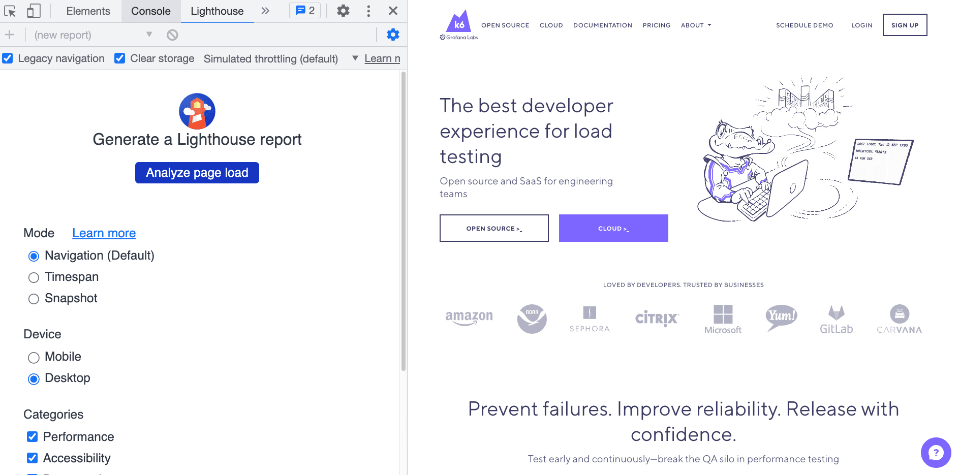

Chrome DevTools
The most convenient way to run a Lighthouse test is with Chrome DevTools:
  1. Download Google Chrome
  2. Go to the URL you want to audit
  3. Open up DevTools and use the Lighthouse tab
Run a Lighthouse test with Chrome DevTools

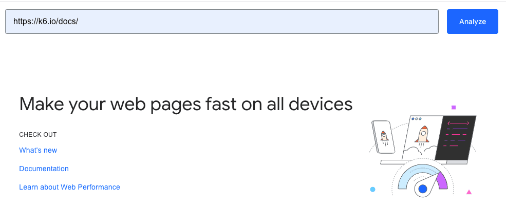

PageSpeed Insights
PageSpeed Insights is another free tool that lets you run Lighthouse tests. It uses real-world data on top of the lab data Lighthouse uses. To run a test, navigate to PageSpeed Insights, enter the URL you want to audit, and see a report of your website’s performance.
Run Lighthouse with PageSpeed Insights

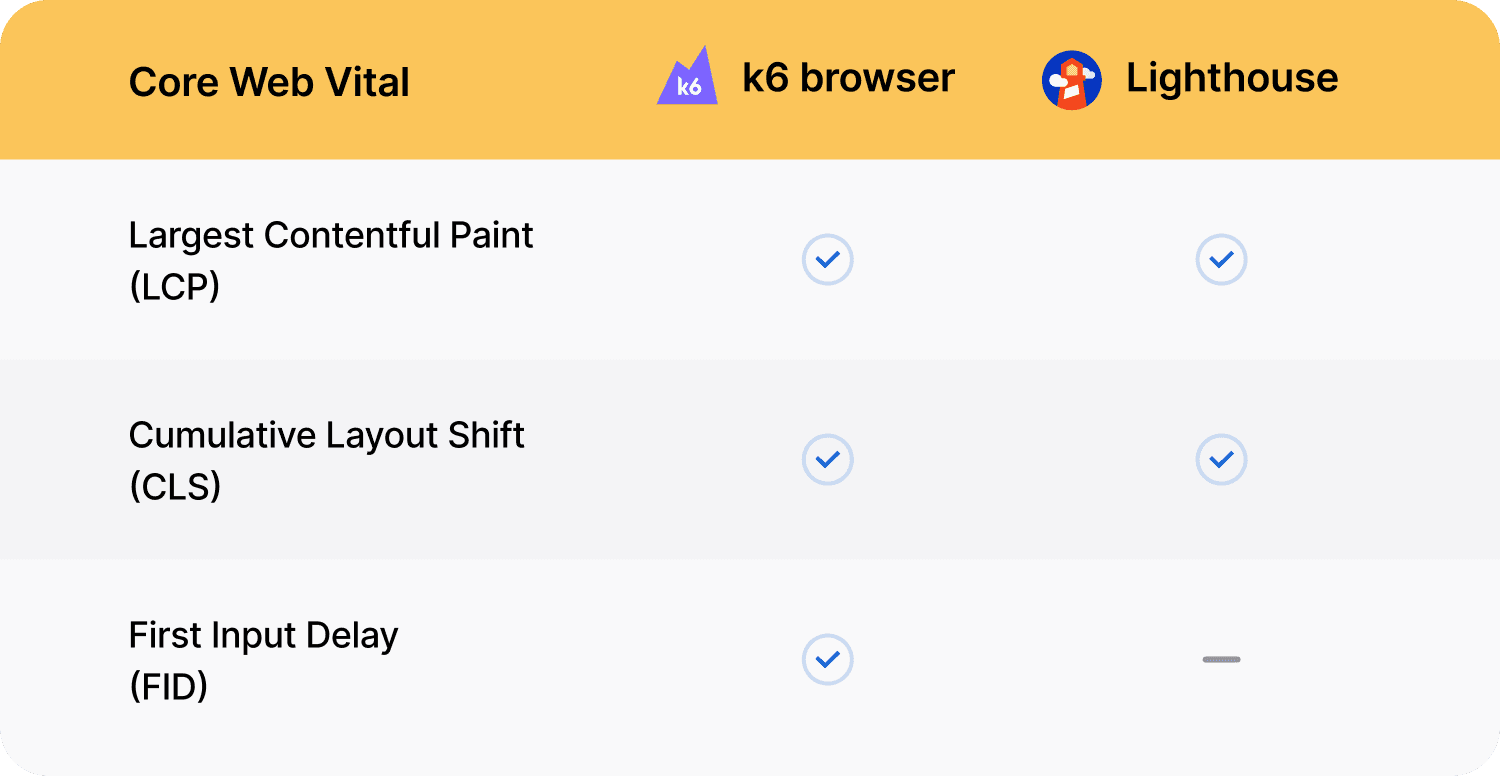

Core Web Vitals
Core Web Vitals are the holy trinity when it comes to web performance. These metrics apply to all web pages and measure the page’s loading performance, interactivity, and visual stability.
k6 browser and Lighthouse Core Web Vitals
Lighthouse doesn’t measure FID because this requires a real user interaction, and Lighthouse, by default, only analyzes the initial page load. On the other hand, k6 browser can measure FID because it provides an API that lets you script user interactions.

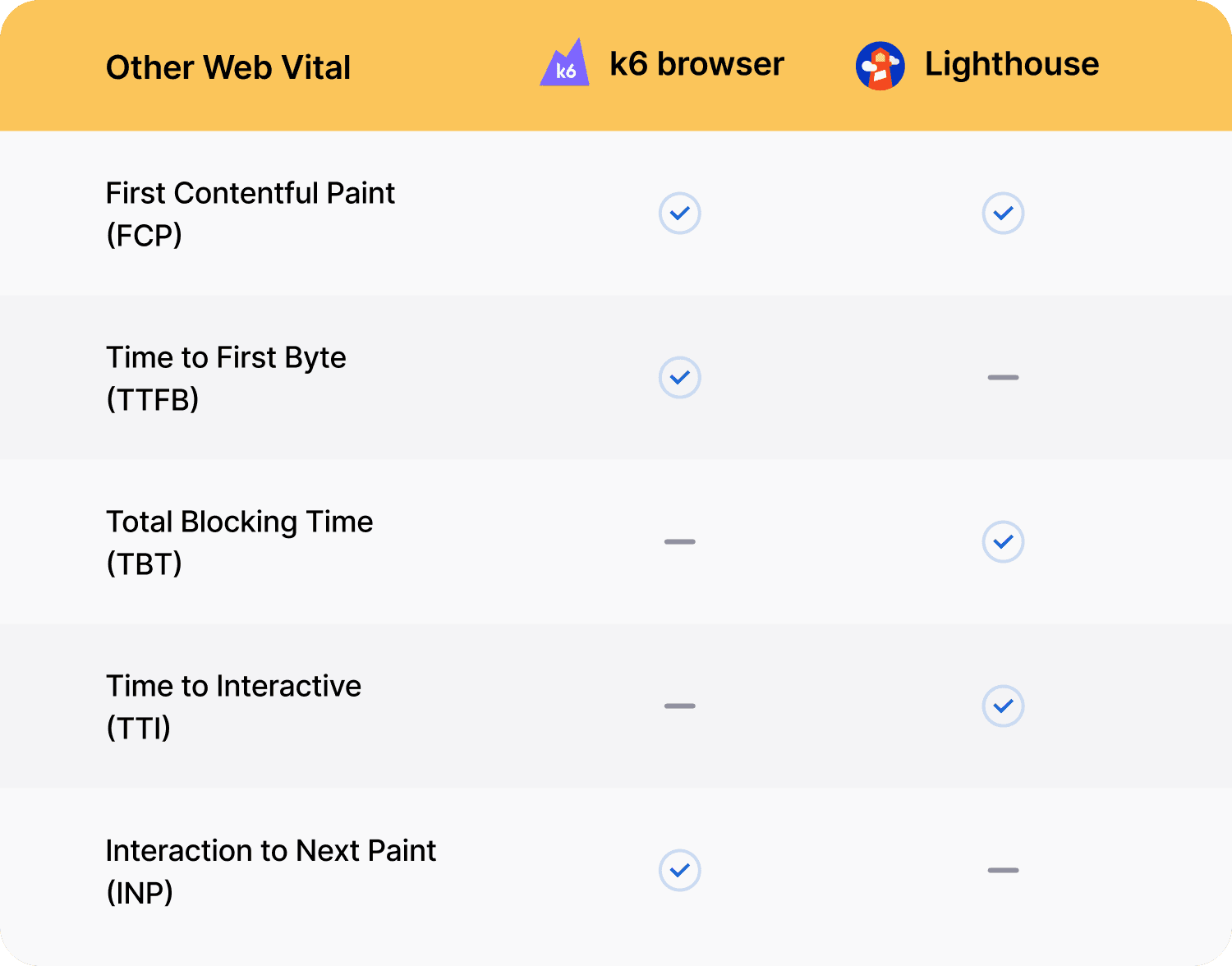

Other Web Vitals
Both k6 browser and Lighthouse also track metrics known as the Other Web Vitals. These metrics are not mandatory but can provide additional insights into the user experience.
k6 browser vs. Lighthouse Other Web Vitals
Lighthouse also tracks a metric called Speed Index, which is not part of Google Web Vitals.
