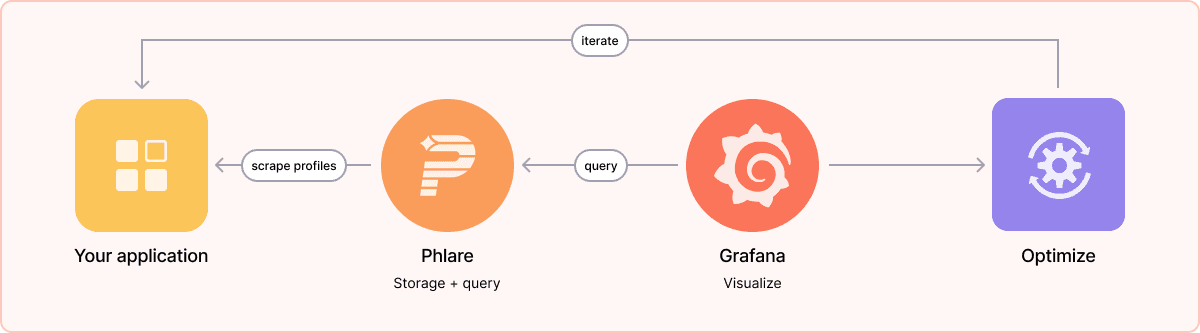

Diagram of how profiling works in an observability set up.
Cyril starts with an explanation of Phlare basics. “Phlare will scrape profiles in the pprof format,” he says, “and it uses the same service discovery as Prometheus — which means if you’re configuring Phlare with the same configuration that you use for Mimir, or Prometheus, or Loki, you’ll end up with the same labels attached to your profile and be able to correlate between those different symbols very easily.”
Your profiles will eventually be stored on object storage for long-term retention, and then they can be queried via Grafana. To improve the performance of your application, you’ll first look at where the problem is and what to optimize, then you iterate. “Then you look at the benefits and try again,” he says, “and then you iterate again.”
