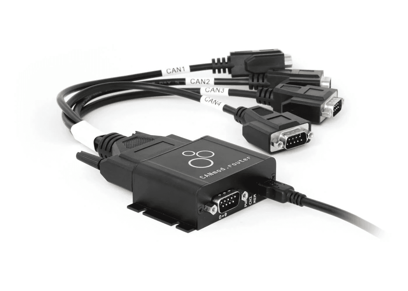

  • CANmod.router: Interface 4 x CAN buses, and output via CAN or USB
