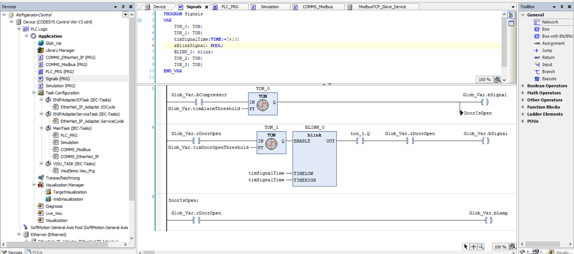

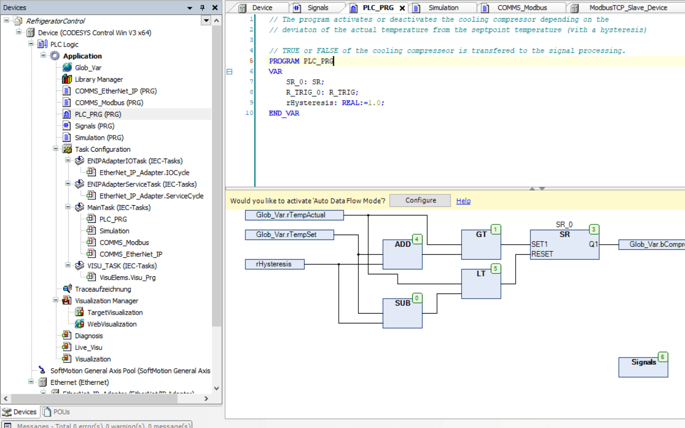

We adopted the demo Refrigerator Controller project to support a simple Modbus Client Device, with all the associated program inputs and outputs mapped to their respective memory structures as supported by the protocol. Let’s take a glimpse at what that was like.
The simulated system was programmed with the industry standard IEC 61131-3 programming languages and data types.
Embedded imageEmbedded image

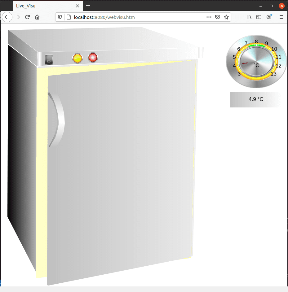

The simulated Refrigerator was made available over the browser interface so that a user can interact with it as shown below:

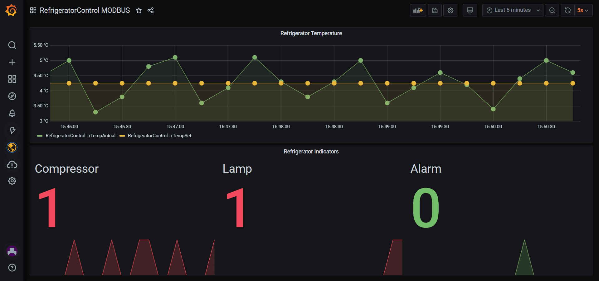

Next, it was time to visualize the metrics as usual using the hosted Grafana instance. All the exported metrics were made available by the Prometheus data source in Grafana. Here is a simple dashboard we came up with. Tada! 🎉
