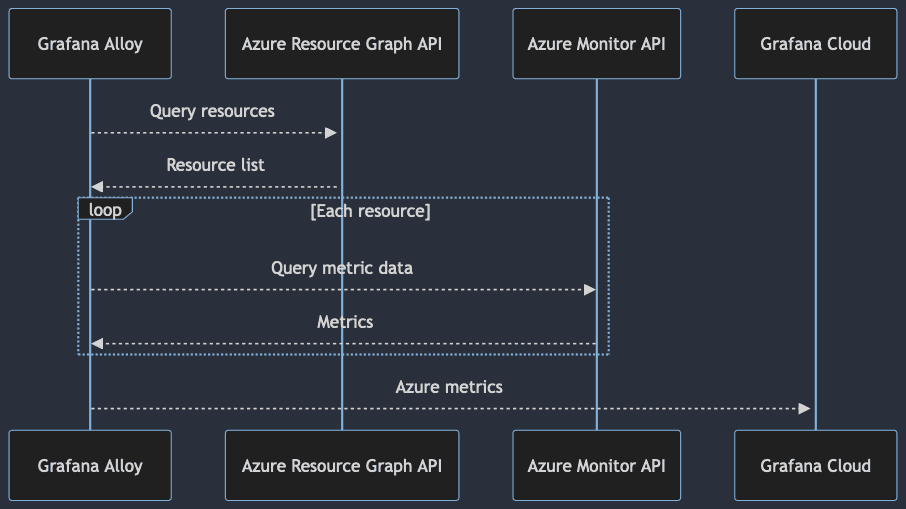

Azure makes various APIs available for gathering metrics. Before subscription-level metrics, Alloy collected metrics from Azure resource-by-resource, with this workflow:
Previous flow chart involving Alloy, Grafana Cloud, and the Azure Resource Graph API and the Azure Monitor API
This approach had a few downsides:
  1. The amount of resources in your Azure subscription dramatically increased the amount of time it took to collect the metric data.
  2. The rate limit on Azure’s Monitor API is not very high, which made it very easy to encounter errors that block you from collecting all your metric data.

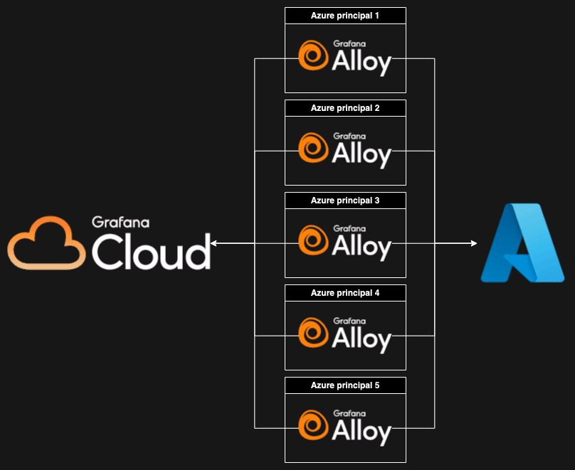

There were workarounds to these problems that involved running multiple Alloy deployments that used different service principals, each of which got its own resource limit. It would end up looking something like this:
A flowchart with multiple Alloy instances with arrows pointing to Grafana Cloud and Azure
As a result, you had to manage many independent Alloy deployments that cannot take advantage of Alloy clustering.
Clustering enables a fleet of Alloy deployments to work together to ensure high availability. This creates a horizontally scalable system with minimal resource and operational overhead, ensuring your mission critical Azure metrics will always be available for you.

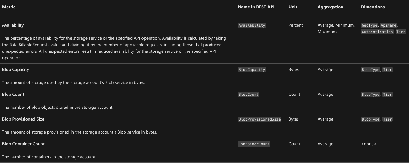

All your dimensions in a single configuration
Azure services expose their metrics with a set of dimensions. The set of dimensions might be different for each metric. If we look at an example for Azure Blob Storage metrics, we can see the metrics do not have an overlapping dimension set.
Screenshot of Azure metric dimensions
If you wanted to collect all of these metrics, including dimensions, it would require three separate configurations, each with different dimensions. This is incredibly complicated to manage and each extra configuration you add results in even more API calls, which increases the likelihood of being rate limited. But now you can do it all in a single configuration. Doing so will take you from this:
