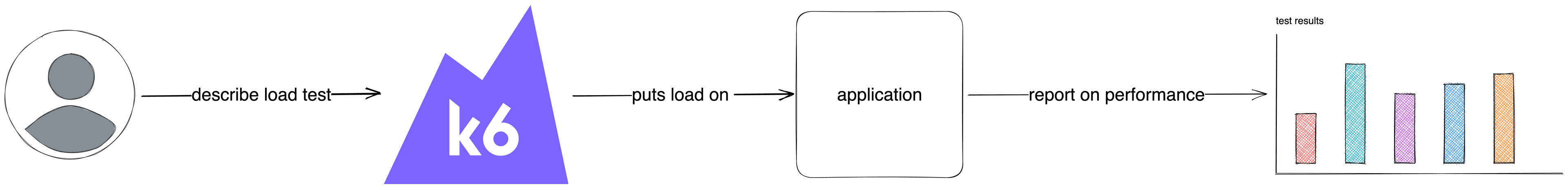

k6 has been engineered with two primary objectives in mind: generating load and collecting measurements, also known as samples, for analysis.
To meet these objectives, k6 enables software teams to describe and refine a testing strategy that accurately reproduces and simulates the traffic and interaction patterns they want to observe. The tool then springs into action, executing the plan and collecting measurements, ultimately empowering users to precisely understand how their software performs under the load k6 produces.
Embedded image

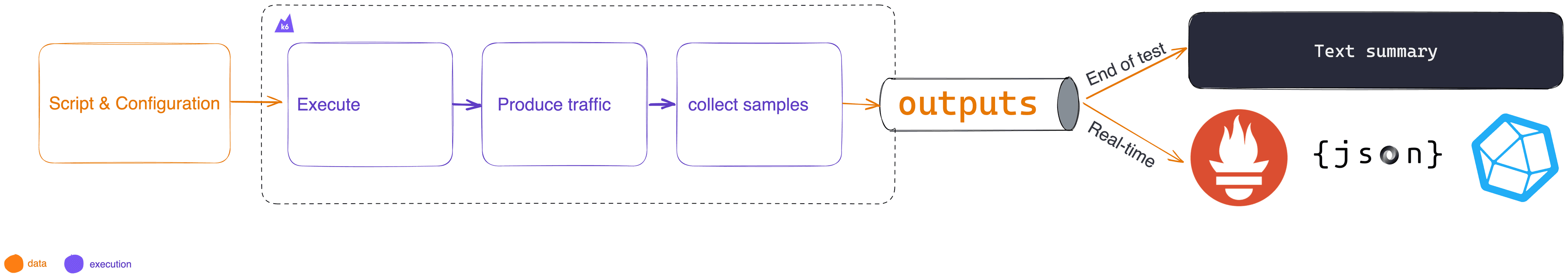

k6 is structured around four main pillars:
  1. Enabling users to script and configure their workloads
  2. Planning and executing tests
  3. Collecting measurements of software performance, such as response time
  4. Forwarding results to users

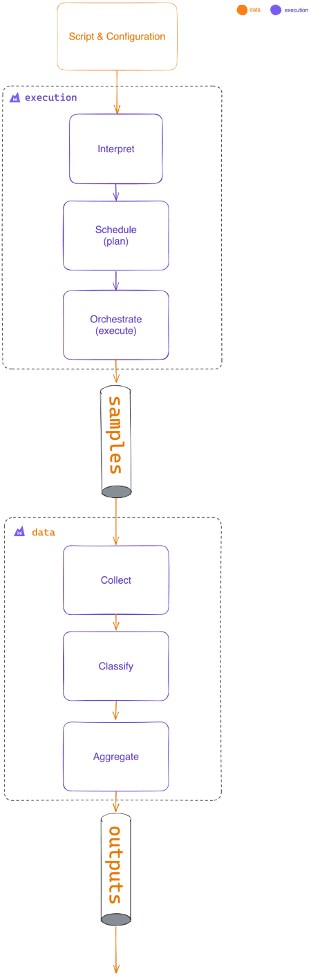

The design of k6
To fulfill its mission, k6 is centered around two main components: an execution pipeline and a data pipeline.
Embedded image
Think about k6 as a simplified work scheduler, similar to those found in operating systems. Users write code to define the operations they want to perform and specify the constraints they wish to apply. k6 then creates an execution plan based on this code and its configuration, and orchestrates the process until completion.
As the code is executed and the scheduled plan progresses, k6 gathers measurements and funnels them into the data pipeline. This data is directed to real-time external outputs, enabling users to analyze it with their preferred tooling and according to their specific needs, as described above. In parallel, k6 classifies and aggregates the data to generate an end-of-test summary.
Finally, as a load testing tool, k6 is engineered to execute code and carry out its plan swiftly and efficiently. To manage heavy workloads and high traffic volumes, it maximizes available hardware resources.
