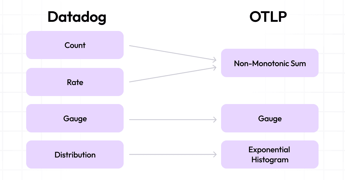

Datadog’s official documentation provides thorough information about their metric types: Count, Gauge, Rate, Histogram and Distribution.
The process of translating Count, Gauge, and Rate metric types was relatively straightforward, as each of these can be mapped fairly directly to an OpenTelemetry metric format. Datadog Gauge metrics can be mapped to OpenTelemetry Gauge metrics, and Count and Rate metrics can be mapped to OpenTelemetry Sum metrics (with an adjustment to the value for Rate metrics to factor in the interval).
The Datadog Distribution metric type can most closely be mapped to OpenTelemetry’s Exponential Histogram metric type. This was a more challenging translation, due to differences in how the bucket boundaries are defined in the two systems. A best-effort translation was implemented to minimize loss of accuracy in the resulting Exponential Histogram.

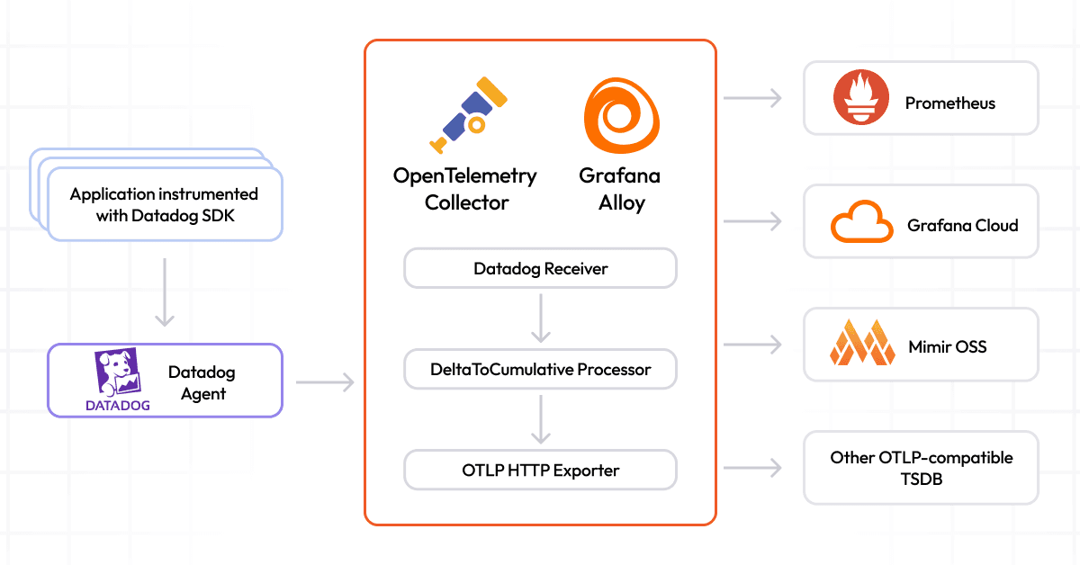

Once you enable the Datadog receiver, the collector will effectively be working with OpenTelemetry metrics coming from your Datadog-instrumented applications. You could choose from a wide range of collector exporters to write those metrics to specific backends. However, our recommendation is that you use the default OTLP exporter to make your pipeline as OTel native as possible.
It is important to note that the OpenTelemetry specification defines two different temporalities. If you intend to write to Prometheus, Mimir OSS, or Grafana Cloud, a processor is required to convert between these temporalities.
For such use cases, we have built and contributed an open source processor, known as the deltatocumulative processor. Once OTLP metrics come out of the Datadog receiver and pass through this processor, they’re ready for export via the OTLP HTTP exporter to Prometheus’s native OTLP endpoint or other systems, such as Grafana Cloud.

We expect that the upstream review process will take a few weeks as we coordinate with the OpenTelemetry community. At the same time, we want to enable you to try this out today, so we have included the receiver and the processor in the Grafana Alloy v1.2.0.
Here’s an Alloy configuration example:
otelcol.processor.deltatocumulative “example” {
max_stale = “5m”
max_streams = 10000
output {
metrics = [otelcol.processor.batch.example.input]
otelcol.processor.batch “example” {
output {
metrics = [otelcol.exporter.otlp.default.input]
otelcol.receiver.datadog “example” {
endpoint = “localhost:4444”
output {
metrics = [otelcol.processor.deltatocumulative.example.input]
