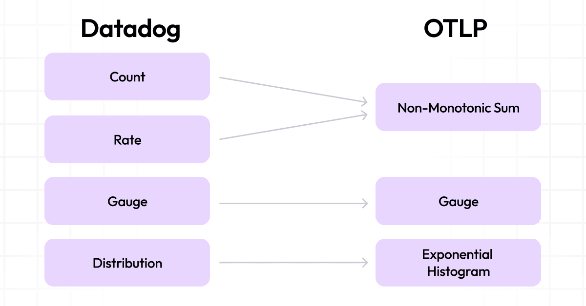

Chart of how Datadog metrics translates to OTLP format
Datadog’s official documentation provides thorough information about their metric types: Count, Gauge, Rate, Histogram and Distribution.
The process of translating Count, Gauge, and Rate metric types was relatively straightforward, as each of these can be mapped fairly directly to an OpenTelemetry metric format. Datadog Gauge metrics can be mapped to OpenTelemetry Gauge metrics, and Count and Rate metrics can be mapped to OpenTelemetry Sum metrics (with an adjustment to the value for Rate metrics to factor in the interval).
The Datadog Distribution metric type can most closely be mapped to OpenTelemetry’s Exponential Histogram metric type. This was a more challenging translation, due to differences in how the bucket boundaries are defined in the two systems. A best-effort translation was implemented to minimize loss of accuracy in the resulting Exponential Histogram.
