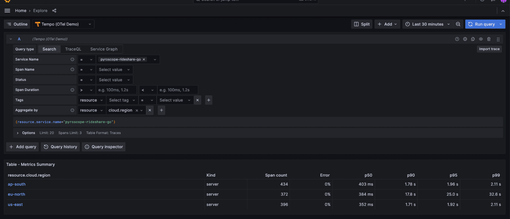

As a Grafana Cloud customer, you’ll see a new Aggregate by button in the Tempo Explore view. (If you’re not already using Grafana Cloud, you can sign up for a forever-free account today.) Open source Tempo users have access to this too — just set the metricsSummary feature toggle on your open source Grafana and enable the metrics summary API on your Tempo database.
To start, select an attribute to aggregate by. When you click Run query, you’ll get a table with RED metrics (total span count, percent erroring spans, and latency information) grouped by the attribute(s) you chose. If you choose to aggregate by resource.cloud.region, for example, and you have three regions — US, EU, APAC — you’ll get back a table with three rows, with each row detailing the RED metrics for spans from that particular region.

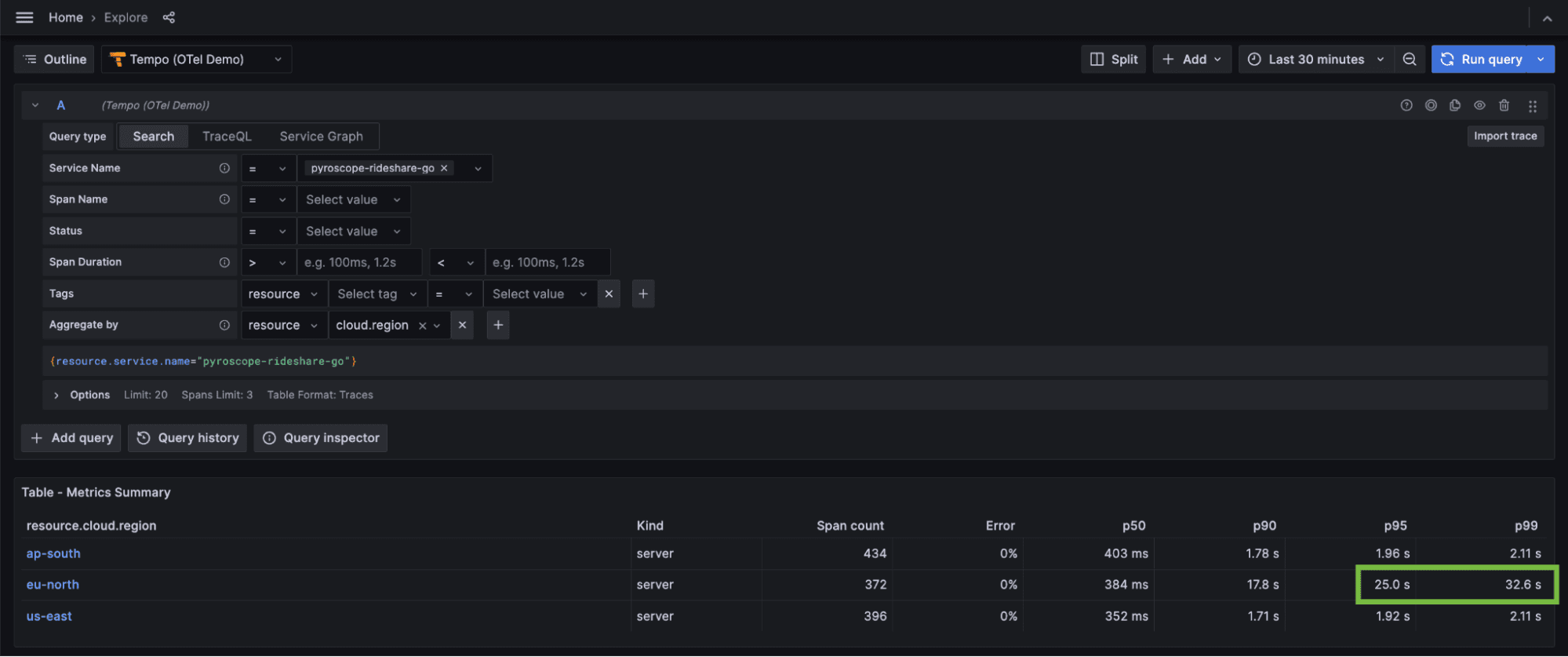

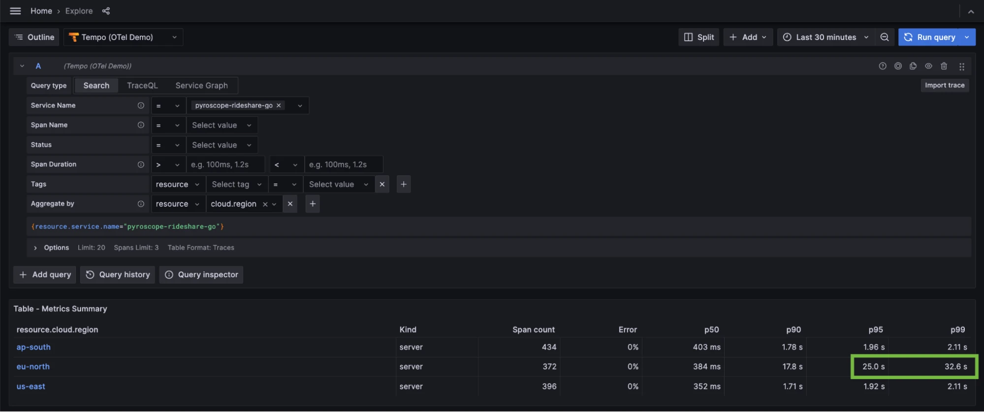

From here, you might notice that only traces going through the EU region are showing elevated latencies, allowing you to focus your investigation on the EU while ignoring anything coming from the US and APAC.

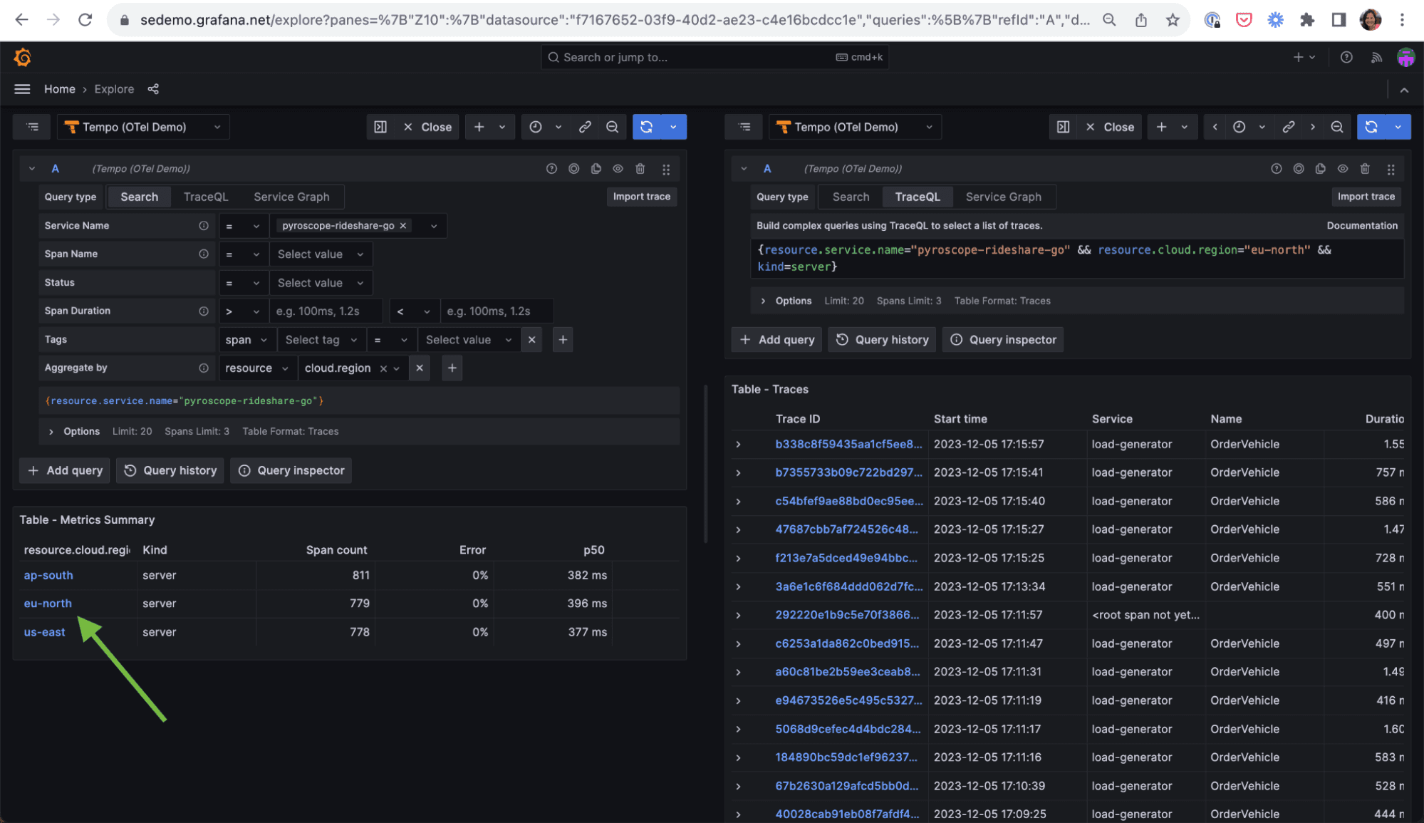

Now, you can communicate back to your team that the latency problem seems to be contained to a particular area, rather than being system-wide. To continue your investigation, simply click on “eu-north,” which will open a split screen showing you traces specifically from that region.
