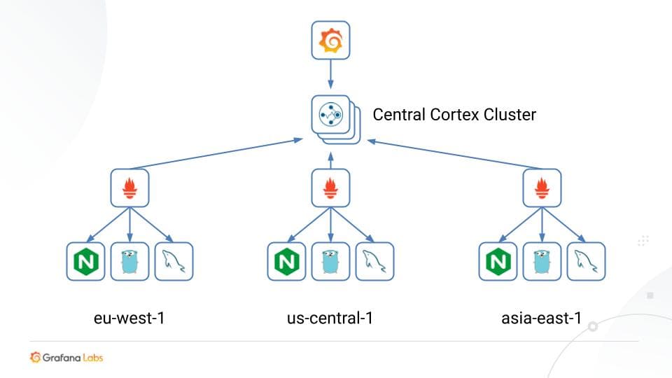

The story of remote write matches Wilkie’s own story with Prometheus. The first PR he did for Prometheus, five years ago, involved switching the remote write system from gRPC over to Protobuf and HTTP. At the time it was challenging to get gRPC to go through an Elastic Load Balancer, and Wilkie wanted to use Prometheus remote write to send data to Cortex, the open source project for scaling Prometheus that Wilkie co-founded. That, in a nutshell, is what Prometheus remote write is for — sending data to other systems.
Since then lots of vendors have taken notice of Prometheus and added support for remote write to their products. “You can send data from Prometheus to pretty much any of the metrics vendors in the world,” said Wilkie. “Now we want to push the interoperability story of Prometheus as far as it will go.” Recently, Wilkie’s team at Grafana Labs enabled Prometheus to receive remote write requests as well as send them. This, as he points out, solves the Prometheus federation problem in a new way.

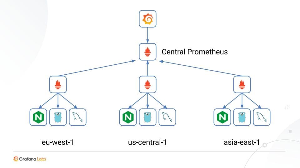

Global federation, revisited
Federation allows a Prometheus to scrape metrics from other Prometheus servers. The challenge is that, for the global Prometheus to be able to scrape the edge ones, you have to open up firewall ports and secure multiple servers. But with the push-based approach of Prometheus remote write, it’s possible to open up just the central location and have the edge locations push to it. “This may not sound like a big deal, but imagine if these edge locations were on IP addresses that were changing, or on unstable networks?” said Wilkie. “The remote write protocol could be a better fit.”

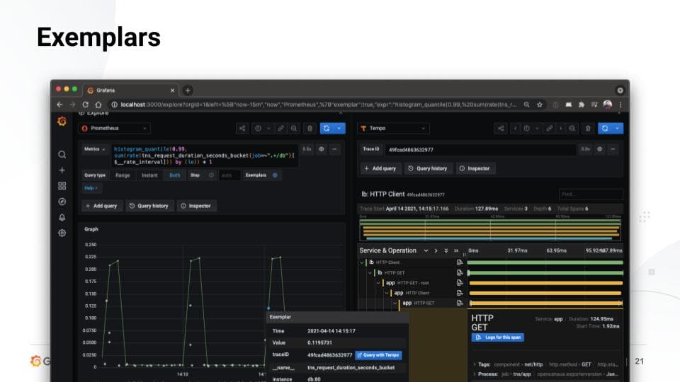

In Grafana, exemplars allow you to overlay dots on a graph. Click on one of those dots and you can jump straight to the trace that that dot represents. “Beorn Rabenstein added exemplar support to client Golang quite a while ago, and Callum Styan added exemplar support to Prometheus in the last release,” said Wilkie. “Together you can implement this really cool experience that speeds up instant response and debugging workflows and makes the whole system feel a lot more integrated.” Now, the Grafana Labs team has added remote write for exemplars in the next release. “We want to make this available to remote write endpoints,” said Wilkie. “People who are implementing remote write should also be able to receive exemplars and offer the same APIs and the same experience.”
