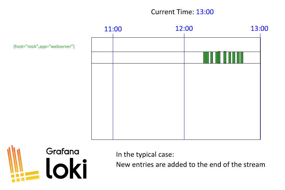

Perhaps some more poorly built but animations could be helpful here! First let’s look at a single stream:
Embedded image

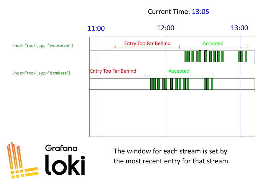

Now let’s extend that example to include multiple streams:
Embedded image
Hopefully this helps clarify how Loki receives older logs!
