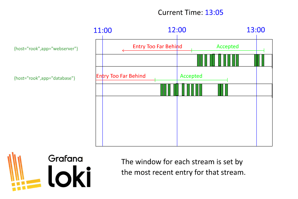

As the name implies, most recent log refers to the log received by Loki with the most recent timestamp. Sounds simple enough, right? Well, the confusion comes in when you pair that with for a stream. That’s because Loki determines the most recent log on a stream-by-stream basis, so you can’t automatically assume your streams are all aligned to the same time.

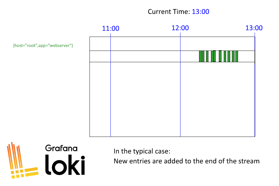

Perhaps some more poorly built but animations could be helpful here! First let’s look at a single stream:
Now let’s extend that example to include multiple streams:
Hopefully this helps clarify how Loki receives older logs!
