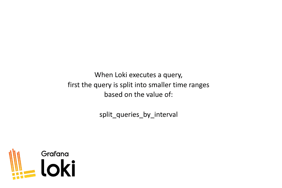

Now that I’m a self proclaimed “animation expert” (See: Part 2), I thought a nice animation would help here.
The first step when Loki executes a query is to split it into smaller time segments:
A diagram shows Grafana Loki splitting queries into smaller time ranges.

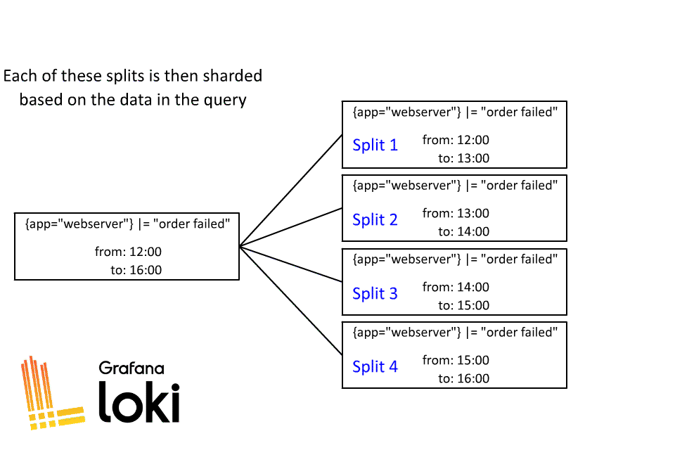

Then each time segment is split again through a sharding process:
A diagram shows splits sharded based on the data in the query

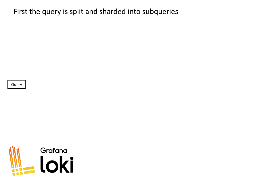

Sharding is a dynamic process in Loki, after the query is split by time, each of those splits then is divided into shards. The number of shards will be based on how much data will be processed, some splits may have a lot of shards while others may only have a few.
Once a query is split and sharded into subqueries, they are placed into a queue where a pool of querier workers will process all the subqueries.
A diagram shows the queries split and sharded into subqueries
