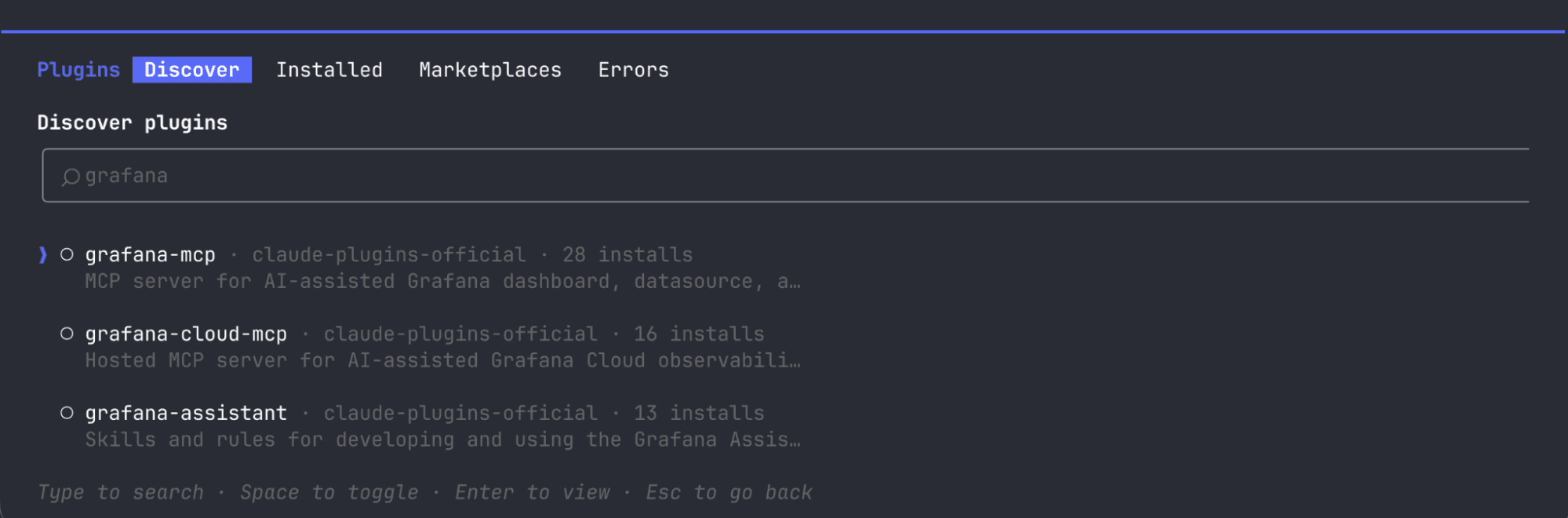

Claude Code showing the grafana-mcp, grafana-cloud-mcp and grafana-assistant plugins in its marketplace
If you’re using Claude Code, you can easily install the Grafana MCP server as a plugin. We also offer the Grafana Assistant plugin, which provides guidance on interacting with Grafana Assistant. gcx comes with its own bundle of skills, which you can install with gcx agent skills install. These skills can teach your agent to use gcx effectively and efficiently for some common workflows.

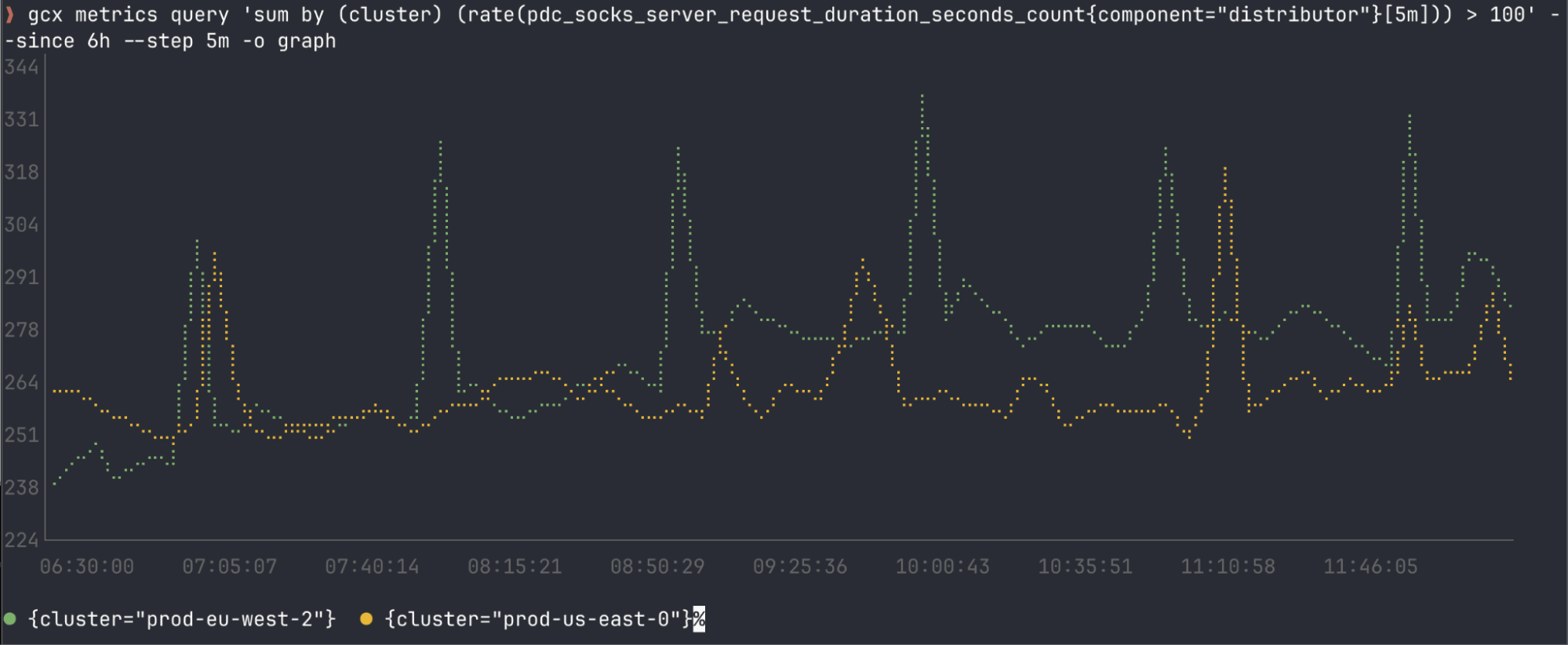

gcx lets humans and agents query their telemetry from the terminal

Say you’re adding a new provider to your payments service. Suppose you already have a dashboard showing RED metrics for your payments service and you can see that the p95 request latency for the existing provider Swipe is two seconds. You will explain to your agent that you expect 30% of the traffic to be diverted to this new provider, and you expect the latency to be the same.
Your agent can fetch real telemetry data from your production environments to ground these requirements in reality, which might influence the suggested implementation from the agent since it knows what requirements and limitations it needs to deal with. For example, it could find the current payment request rate for your systems to get an estimated request rate for the new request handler it will build. It will also know to add a built-in latency when it mocks the payment provider for unit and integration testing.
The result will be logic that behaves as you expect in an environment similar to your production environment, since the agent was guided by real data instead of making assumptions based on its training data.

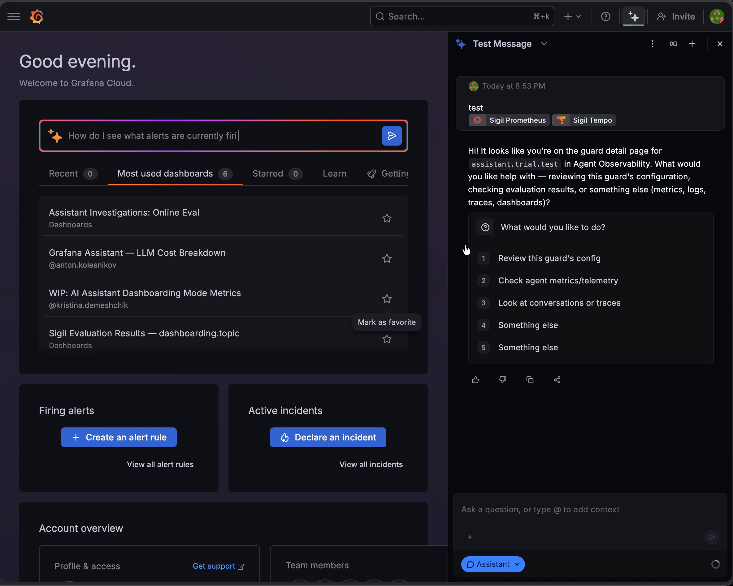

Did you know you can continue Grafana Assistant conversations on the command line? This can be really useful if you want to get context from your conversation into your coding agent. In the Assistant sidebar or Assistant Workspace, click the three dots, then click ‘"Hand off Conversation" to see a gcx command to pull the transcript.

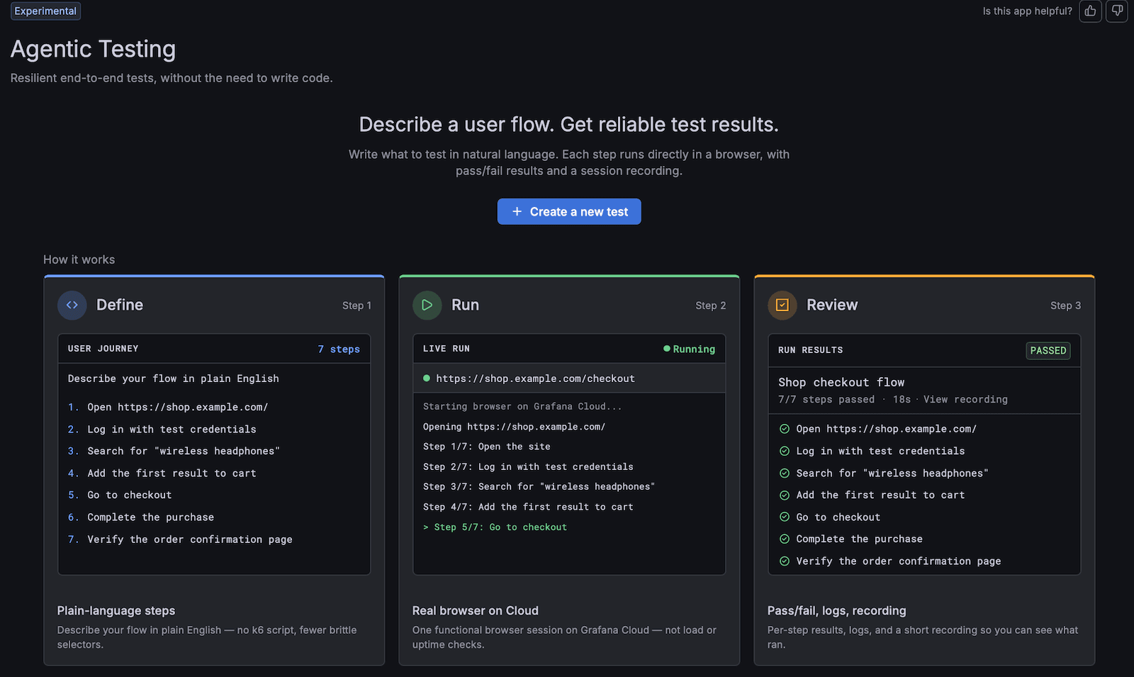

A screenshot from the Agentic Testing UI, asking users to describe a user flow, as well as the steps the tool will follow: define, run, review
Telemetry doesn’t give you the full picture for UIs, unfortunately. However, we have released Agentic Testing (experimental), which allows you to use natural language to describe a set of instructions and validations for an agent to perform against a publicly available web application. These tests can help detect regressions in your UI, and they are easier to define and better equipped to deal with UI changes, than traditional browser tests.
