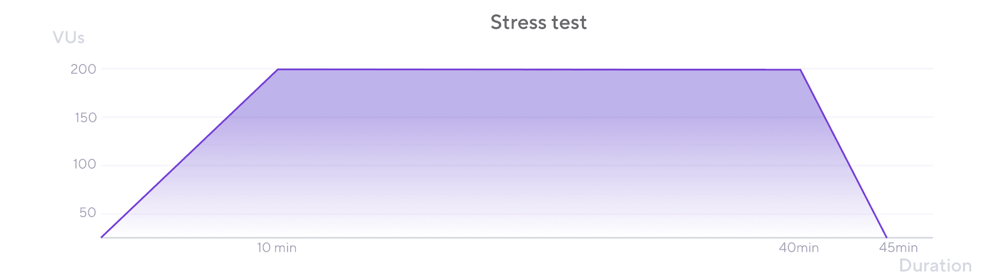

Here is a test script for the open source load testing tool Grafana k6:
import http from "k6/http";
import { sleep } from "k6";
export const options = {
// Key configurations for Stress in this section
stages: [
{ duration: "10m", target: 200 }, // traffic ramp-up from 1 to a higher 200 users over 10 minutes.
{ duration: "30m", target: 200 }, // stay at higher 200 users for 30 minutes
{ duration: "5m", target: 0 }, // ramp-down to 0 users
export default () => {
const urlRes = http.get("https://test-api.k6.io");
sleep(1);
// MORE STEPS
// Here you can have more steps or complex script
// Step1
// Step2
// etc.
For more complex behavior, refer to more load testing examples in our k6 documentation.

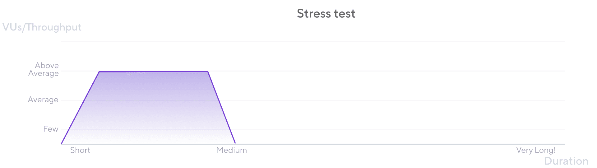

The VU or throughput chart of a stress test looks similar to this:
Note that similar to the average-load test, the stress test starts at 0 but increases beyond the point tested in the average-load type. The ramp-up and ramp-down periods are longer to allow for a more realistic response.
