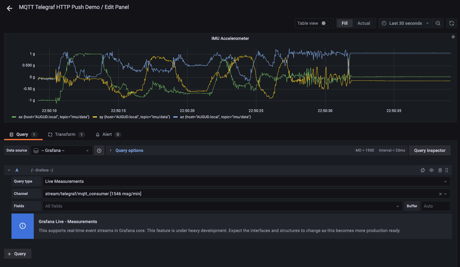

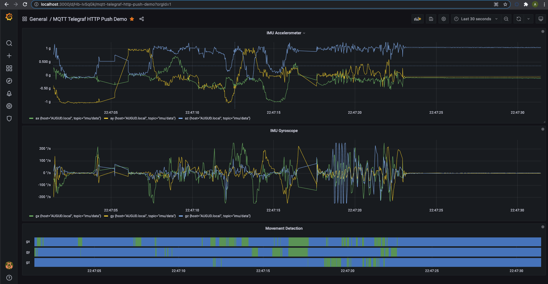

We created the same dashboard as before using the time series and timeline panels, to visualize the tri-axial data from the accelerometer and gyroscope.
Embedded image
For details on how to set up the individual queries for your panels, refer to our tutorial on streaming metrics from Telegraf to Grafana.
Embedded image
