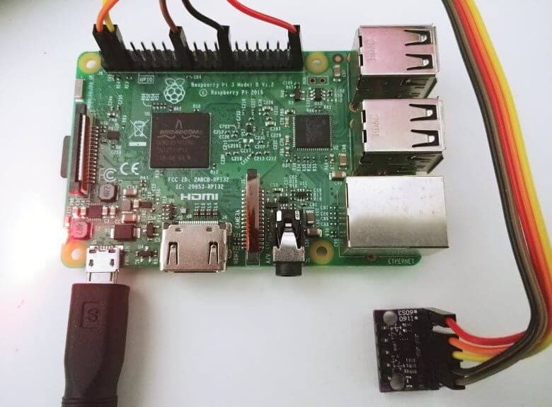

In order to demonstrate an applicable real-life scenario we used a simple IMU-based attitude sensing board and connected it to a Raspberry Pi to stream both the accelerometer and gyroscope data over MQTT.
The sensing board is based off of a very widely used, versatile, and off-the-shelf IMU, BMI160 from Bosch Sensortec. It is a compact, low-power, low-noise 6DOF IMU that is typically found in smartphones and wearable devices. The sensor board was connected to a Raspberry Pi over its I²C interface, and we used a Python script to extract and periodically publish the sensor data to a Mosquitto MQTT broker, both running locally on the Pi.

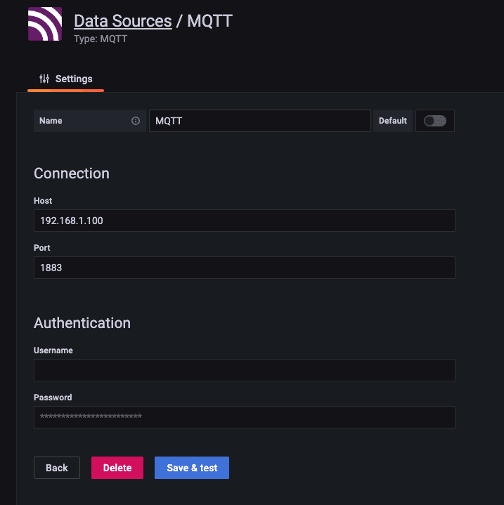

In order to fetch the streaming sensor data into a Grafana instance on a separate machine, we installed and used the Grafana MQTT Datasource plugin on that machine. (For details on the installation procedure for the MQTT Datasource plugin refer to the README in the GitHub repository.) The plugin uses an integrated MQTT client to subscribe to MQTT topics and the Grafana Live streaming API to publish them to the event stream in the Grafana Live engine. The datasource was configured to connect to the Mosquitto MQTT broker running locally on the Pi.

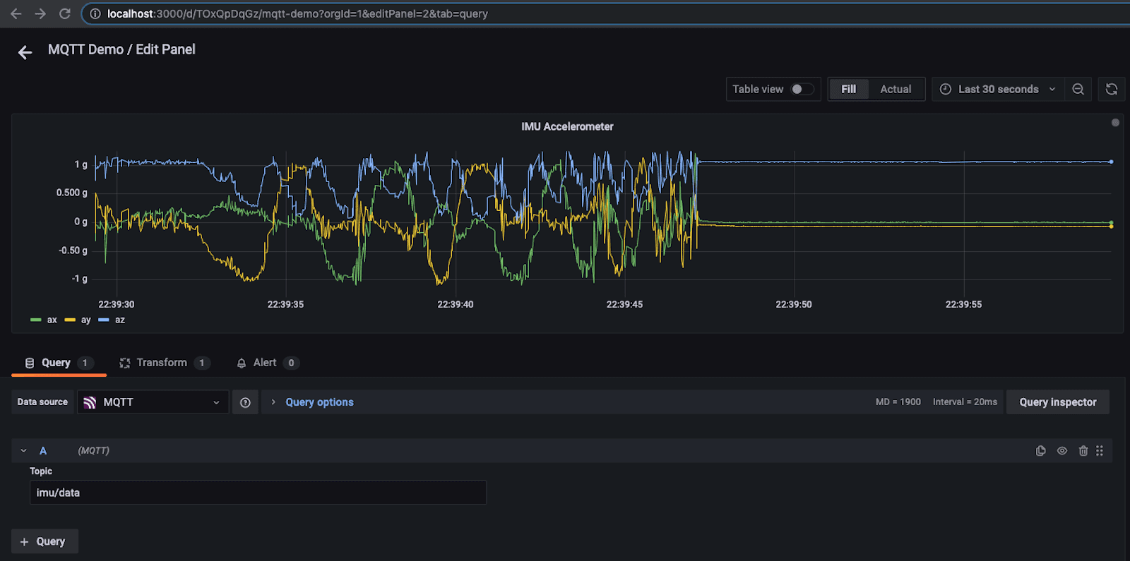

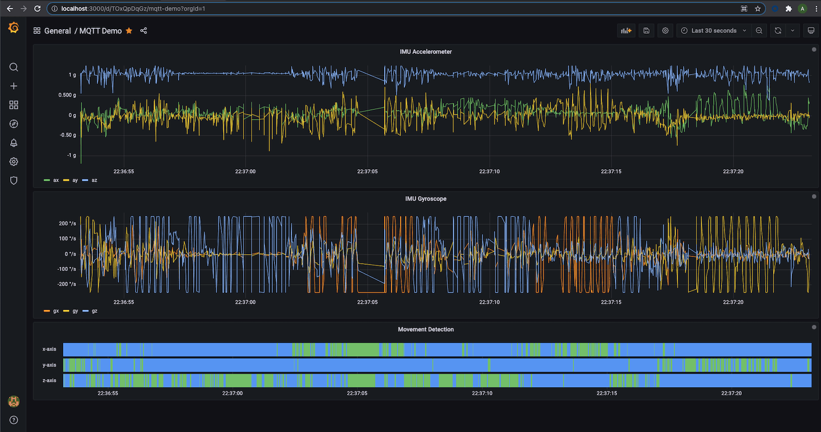

For our dashboard, we used the time-series panel, which was previewed in the v7.4 release, to visualize the accelerometer and gyroscope data for all the axes separately. And we used the newly released timeline panel to detect movements on either of the three axes. These visualizations can be very useful in systems where anomalies and imbalances manifest themselves with excessive movements or rotations around a certain axis. Furthermore, these kinds of dashboards can be very critical in maintaining oversight over dynamic systems which have sophisticated attitude control mechanisms in place to maintain stability and functionality.
The demo
Here is a live demonstration of what the final result looks like. Note how the time-series trends respond to the changing orientation and rotations around all three axes of the sensing board, and how useful the state timeline is in terms of independently detecting movement on any axis.
