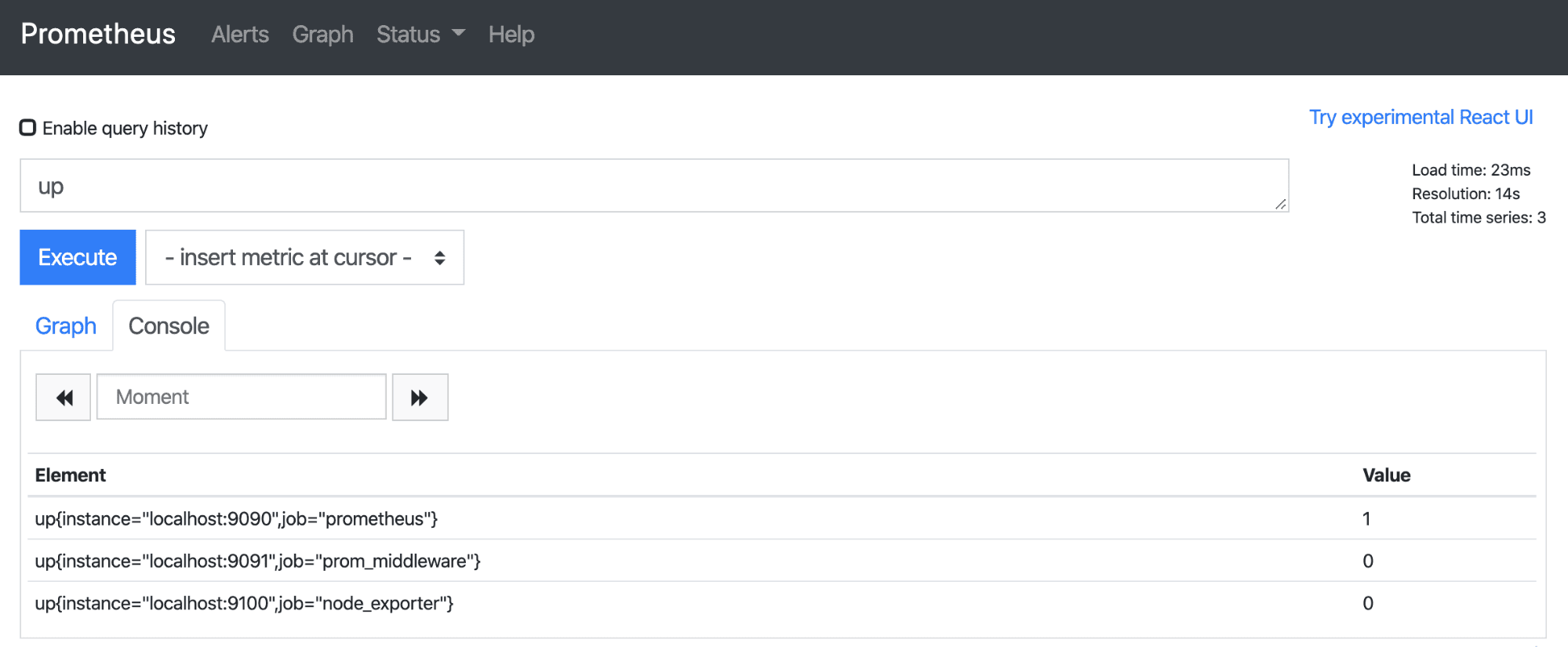

I’m sure everyone agrees that knowing when any of your instances are down is very important. Therefore, I’m going to use this as our condition by using up metric. By evaluating this metric in the Prometheus user interface (http://localhost:9090), you will see that all running instances have value of 1, while all instances that are currently not running have value of 0 (we currently run only our Prometheus instance).
Embedded image

Once you do this, anytime you want to create an alert, you can just stop the node_exporter or prom_middleware app.

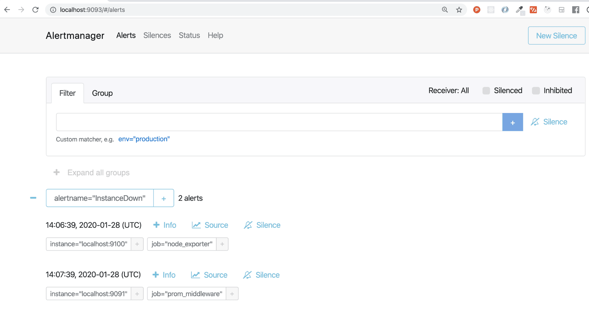

Depending on whether or not you have any active alerts, Alertmanager should be properly set up and look something like the image below. To see the annotations that you added in the step above, you’d click on the +Info button.
Embedded image

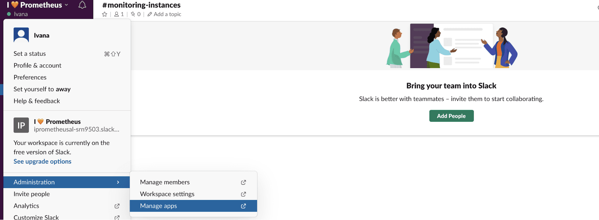

If you want to receive notifications via Slack, you should be part of a Slack workspace. If you are currently not a part of any Slack workspace, or you want to test this out in separate workspace, you can quickly create one here.
To set up alerting in your Slack workspace, you’re going to need a Slack API URL. Go to Slack -> Administration -> Manage apps.
Embedded image

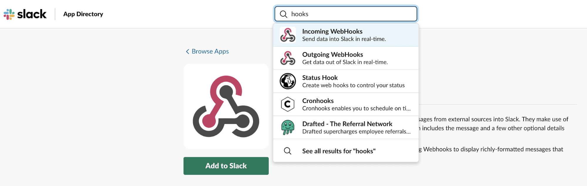

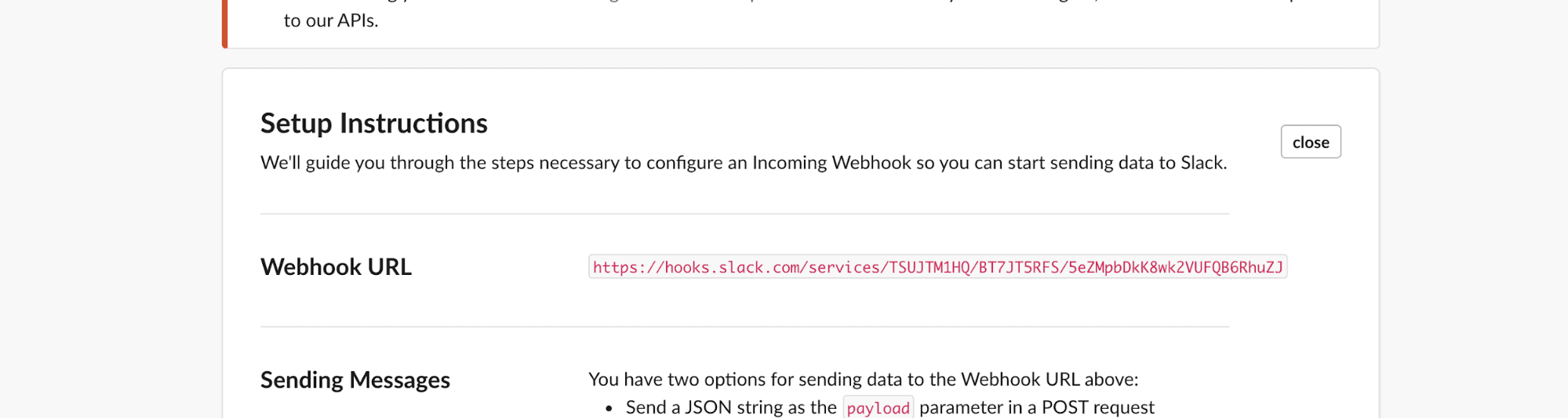

In the Manage apps directory, search for Incoming WebHooks and add it to your Slack workspace.
Embedded image
Next, specify in which channel you’d like to receive notifications from Alertmanager. (I’ve created #monitoring-infrastructure channel.) After you confirm and add Incoming WebHooks integration, webhook URL (which is your Slack API URL) is displayed. Copy it.
Embedded image
Then you need to modify the alertmanager.yml file. First, open subfolder alert_manager in your code editor and fill out your alertmanager.yml based on the template below. Use the url that you have just copied as slack_api_url.

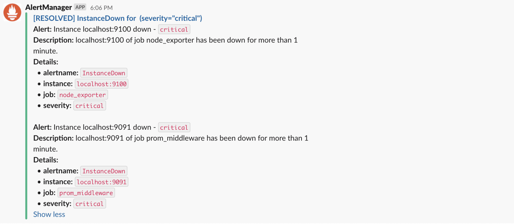

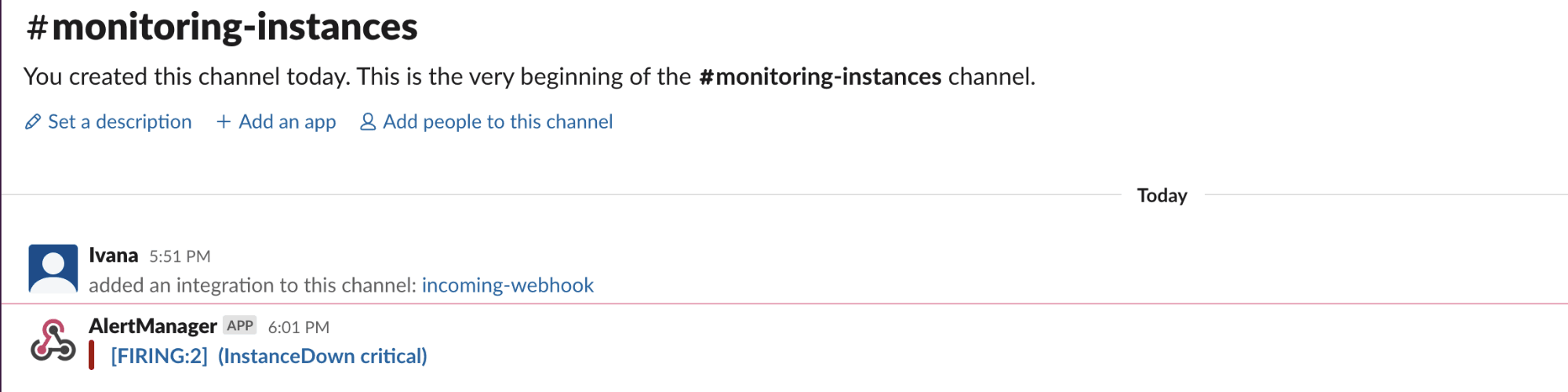

Reload configuration by sending POST request to /-/reload endpoint curl -X POST http://localhost:9093/-/reload. In a couple of minutes (after you stop at least one of your instances), you should be receiving your alert notifications through Slack, like this:
Embedded image

And this is the final result:
Embedded image

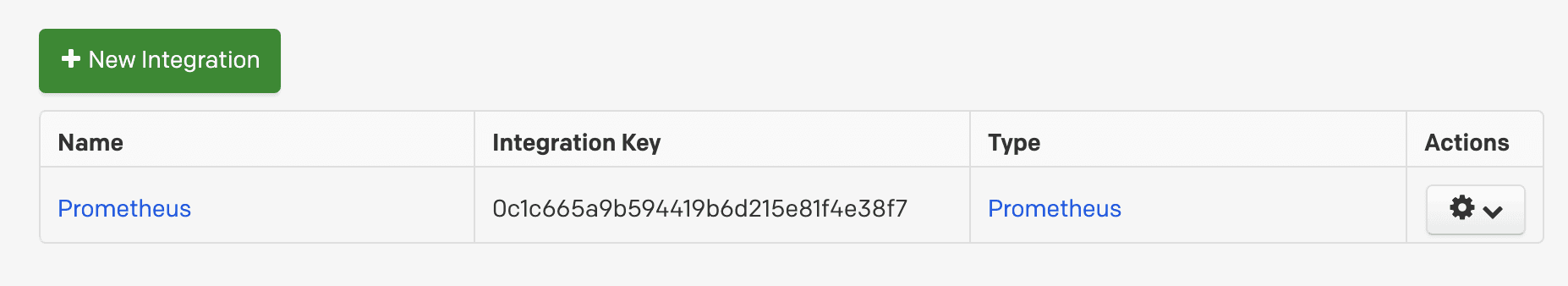

How to set up PagerDuty alerts

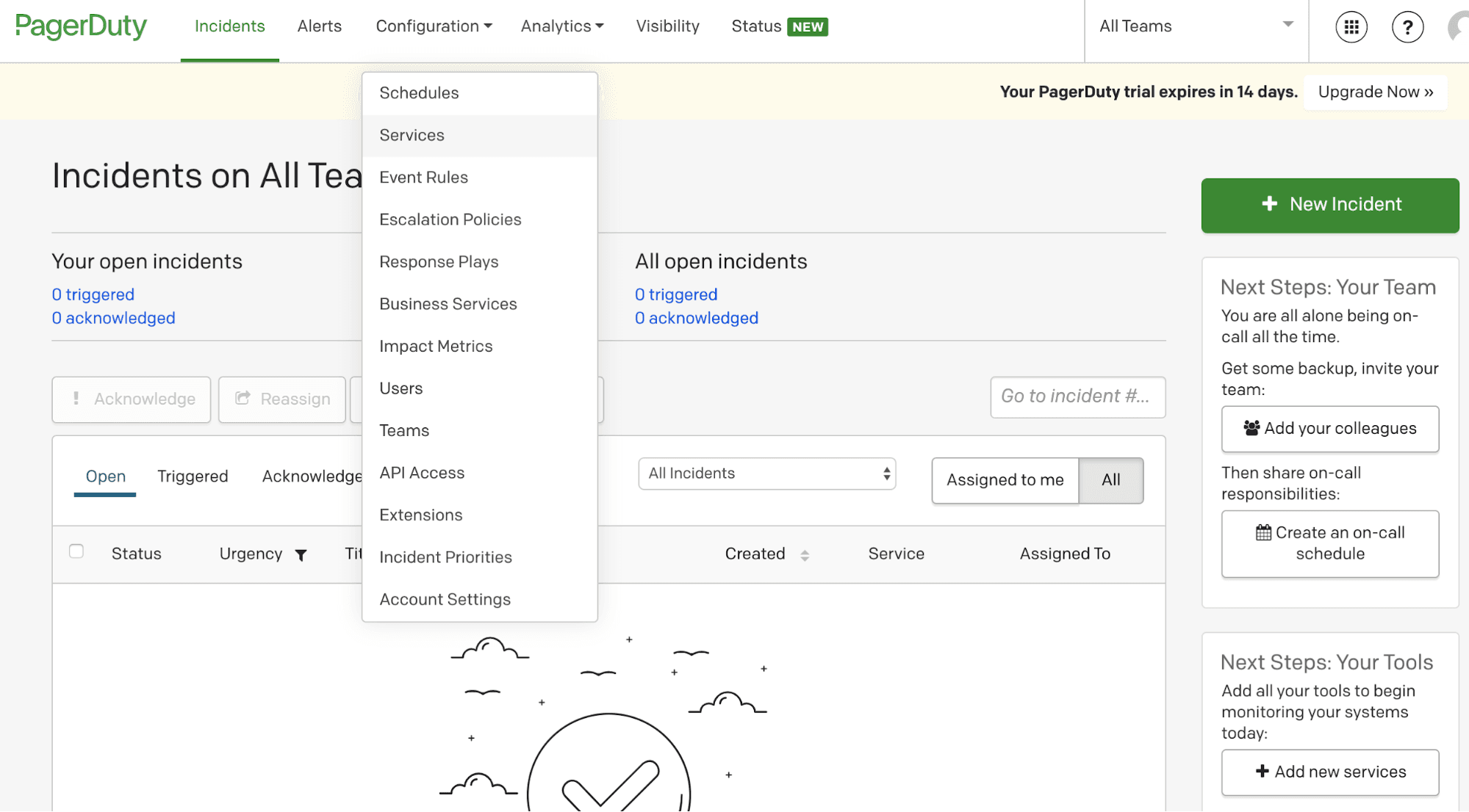

PagerDuty is one of the most well-known incident response platforms for IT departments. To set up alerting through PagerDuty, you need to create an account there. (PagerDuty is a paid service, but you can always do a 14-day free trial.) Once you’re logged in, go to Configuration -> Services -> + New Service.
Embedded image

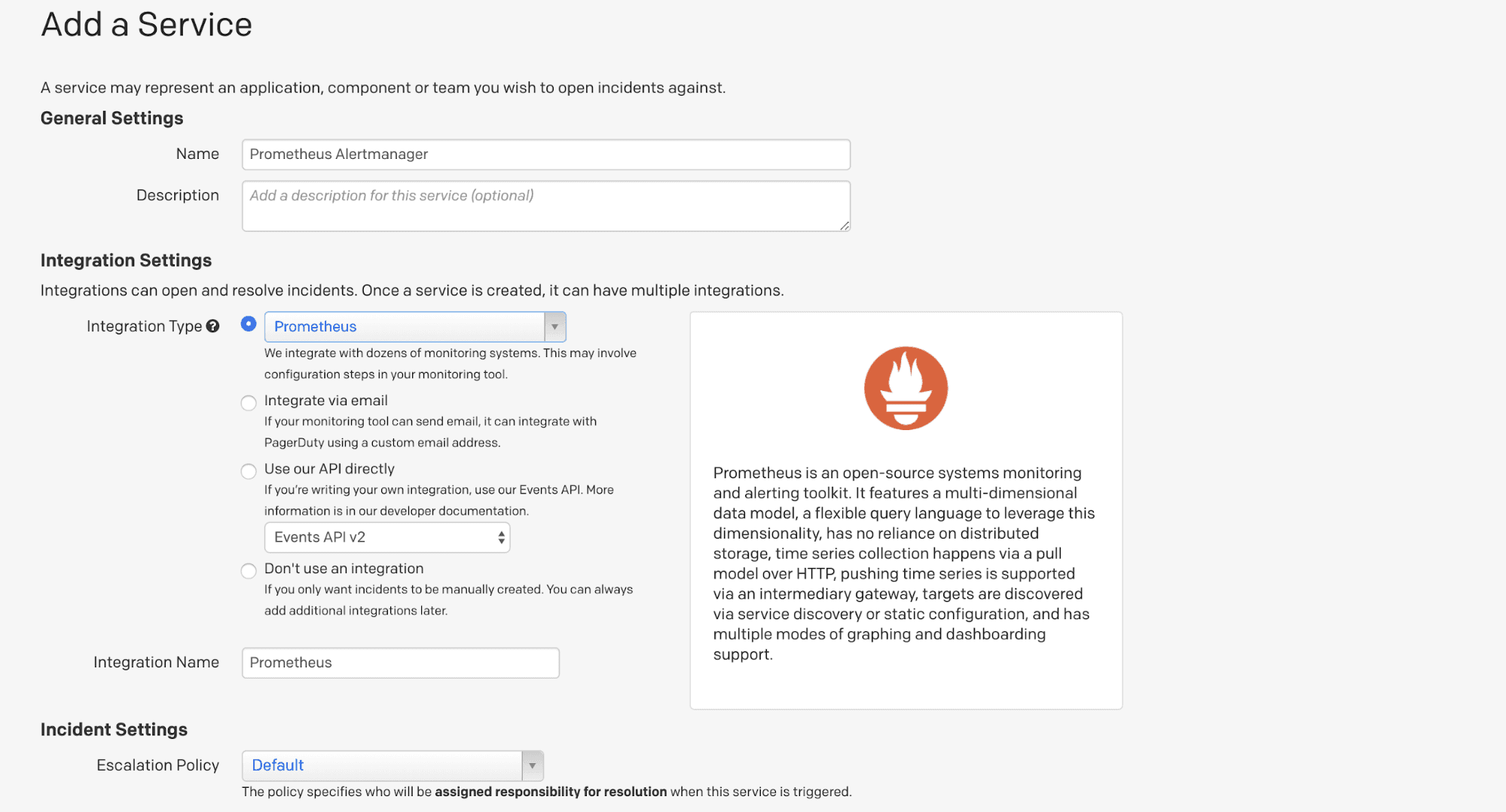

Choose Prometheus from the Integration types list and give the service a name. I decided to call mine Prometheus Alertmanager. (You can also customize the incident settings, but I went with the default setup.) Then click save.
Embedded image
The Integration Key will be displayed. Copy the key.
Embedded image
You’ll need to update the content of your alertmanager.yml. It should look like the example below, but use your own service_key (integration key from PagerDuty). Pagerduty_url should stay the same and should be set to https://events.pagerduty.com/v2/enqueue. Save and restart the Alertmanager.

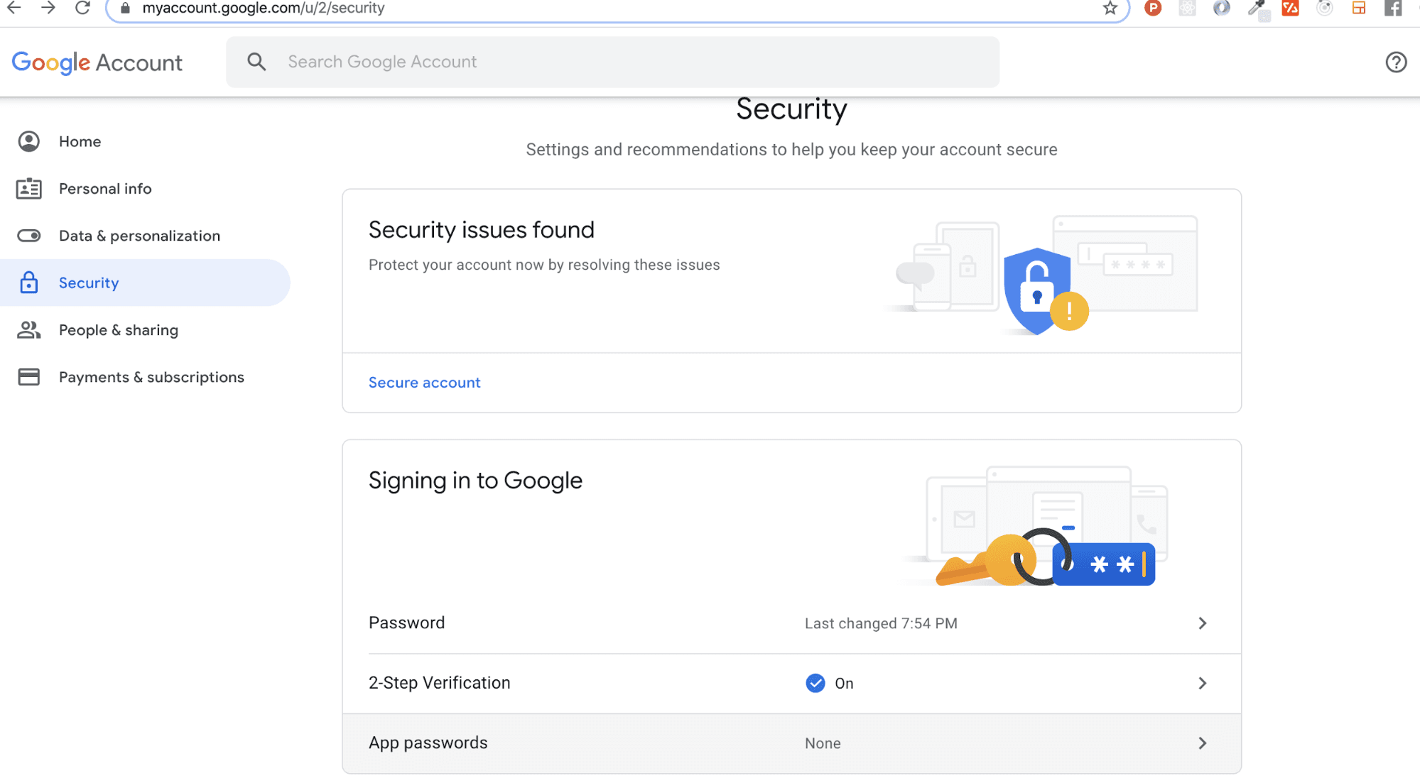

It isn’t recommended that you use your personal password for this, so you should create an App Password. To do that, go to Account Settings -> Security -> Signing in to Google -> App password (if you don’t see App password as an option, you probably haven’t set up 2-Step Verification and will need to do that first). Copy the newly created password.
Embedded image
You’ll need to update the content of your alertmanager.yml again. The content should look similar to the example below. Don’t forget to replace the email address with your own email address, and the password with your new app password.

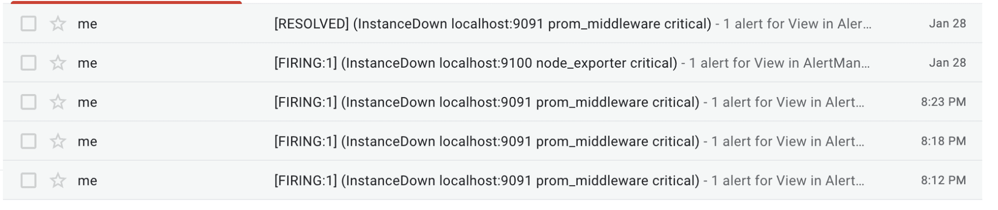

Once again, after a couple of minutes (after you stop at least one of your instances), alert notifications should be sent to your Gmail.
Embedded image
