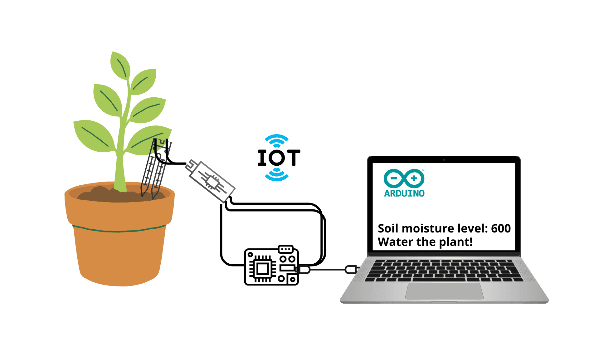

Understanding IoT through gardening
Since the start of COVID-19, we’ve bought a few indoor plants. Some have flourished, while others failed to survive. It seemed we either watered the plants too much or didn’t water them enough.
To start explaining IoT to my daughter, I asked her to imagine if each plant had a little green-thumb helper (aka, a sensor) in its soil that could detect moisture levels and inform us when it needed water. Sounds cool, right? I explained that IoT is just that — a way to connect objects, including sensors, to the internet so they can monitor, communicate, and, in some cases, even take action automatically to make our lives easier.
A diagram of the IoT setup.
We observed that our soil moisture sensor has two metal parts, similar to a fork. When the soil is wet, water helps electricity flow easily between the metal parts, and when the soil is dry, electricity can’t flow as well.
The moisture sensor passes this information as electrical signals to a development board like an Arduino or ESP32, which acts as the brain of this project.
Once the sensor is connected to a development board, it can have two possible outputs:
  • Analog Output (AO), where output is of a variable number depending on the moisture level. When it’s a high number, the soil is dry. When it’s a low number, the soil is wet.
  • Digital Output (DO), where output is HIGH when the soil is wet and LOW when the soil is dry.

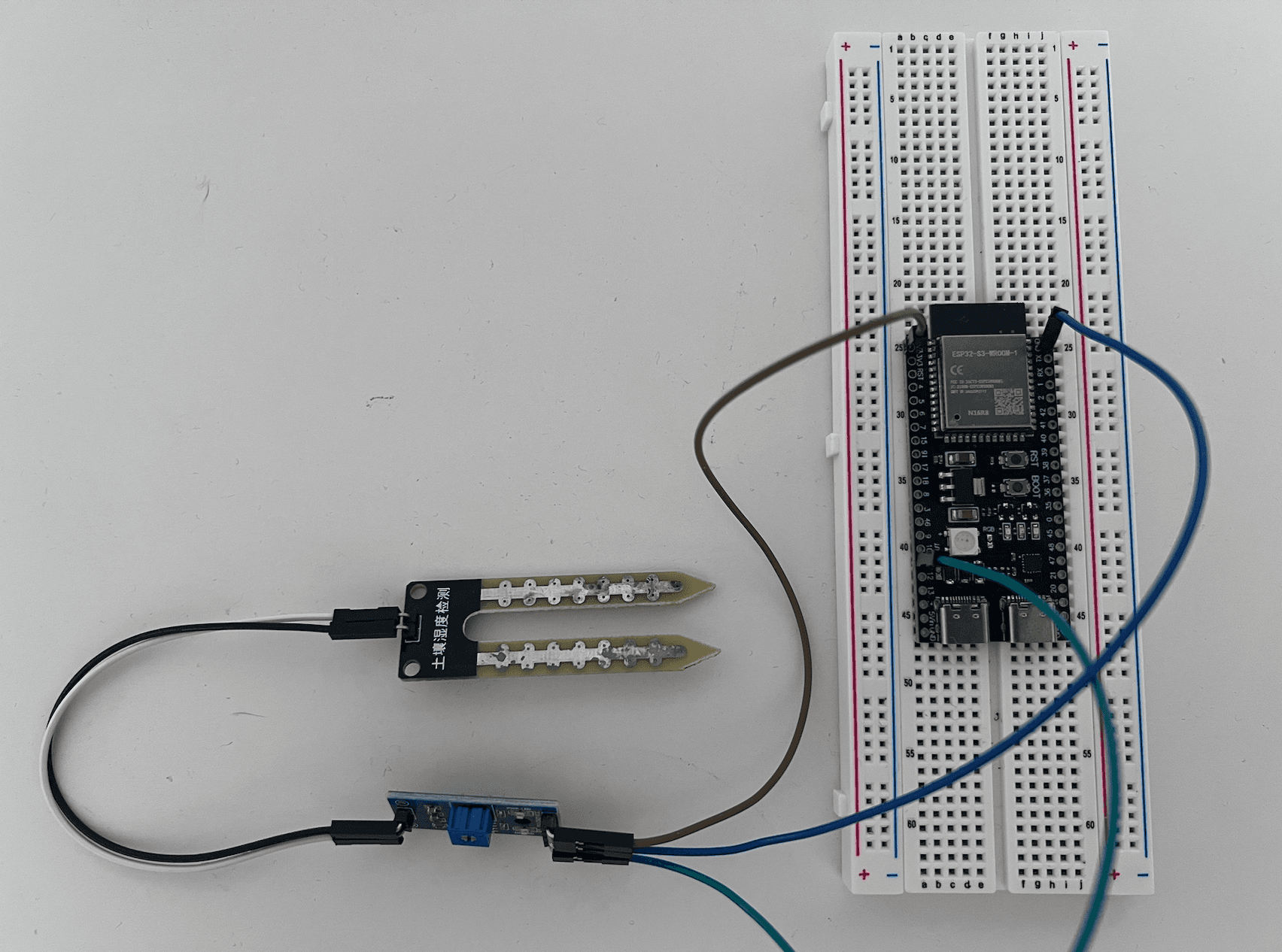

Connecting all the hardware
Now that we had everything we needed, it was time to piece together all the hardware and get to the most exciting part of the project.
Our first step was to connect the soil moisture sensor pieces using the Dupont cables. Afterward, we attached the ESP32 development board to the breadboard. While this is an optional step, we found that, in our case, inserting the development board into the breadboard made it more stable.
Next, we connected the moisture sensor to the development board by connecting the following pins:
  • VCC pin to 3.3V pin
  • GND pin to GND pin
  • AO to pin 11
A screenshot of the hardware for the soil moisture sensor project.
We also inserted the moisture sensor directly into the soil of a plant that had recently been watered.

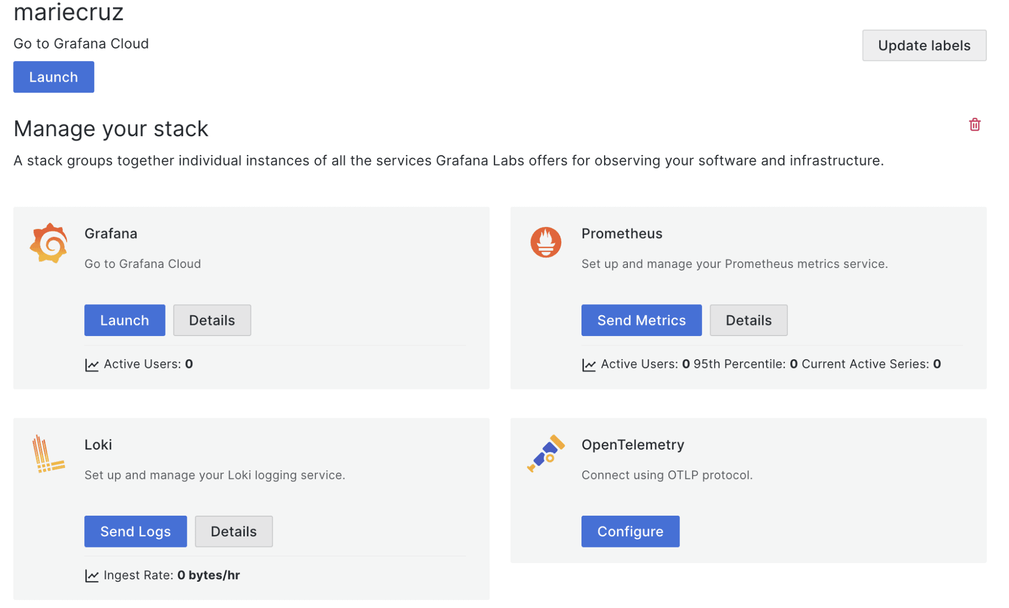

The easiest way for me to show Prometheus was to set up a Grafana Cloud account using the free tier, which comes with a fully managed Prometheus instance. After signing up, we were redirected to a landing page like the one shown below.
A screenshot of the Grafana Cloud landing page.

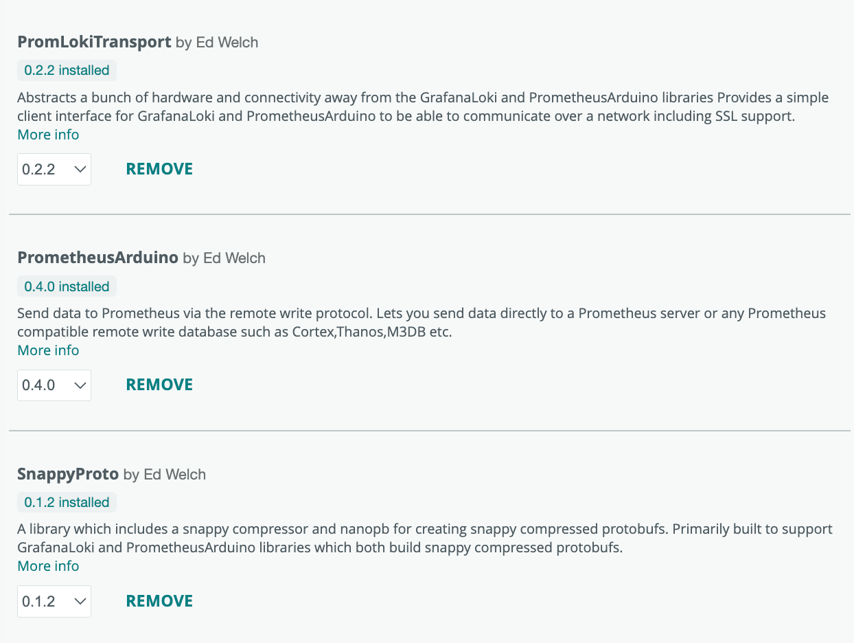

Installing Prometheus libraries in Arduino
To make it easier for our Arduino code to connect to Prometheus, we installed additional libraries (shown below), as instructed in the IoT with Arduino and Grafana GitHub repo, which was relatively straightforward.
A screenshot showing the installation of the additional libraries.

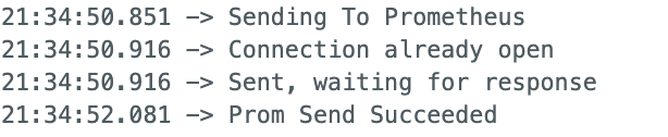

After uploading the updated program to our development board, we saw the following logs on our serial monitor. 🙌🏻
A screenshot of serial monitor logs showing the data is sent to Prometheus.

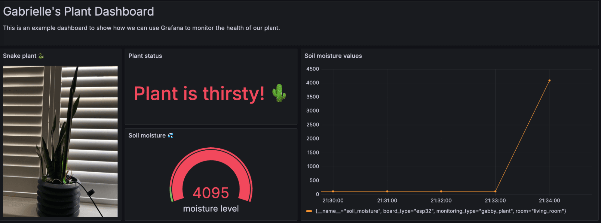

The final piece of the project was to visualize all our data with Grafana Cloud. While Prometheus was our gardener, I explained that Grafana is our cool visualizer. It takes the sensor values from Prometheus and turns them into beautiful graphs, making those values easier to understand.
The Plant Dashboard

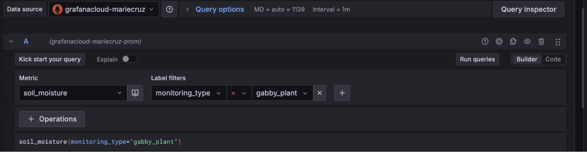

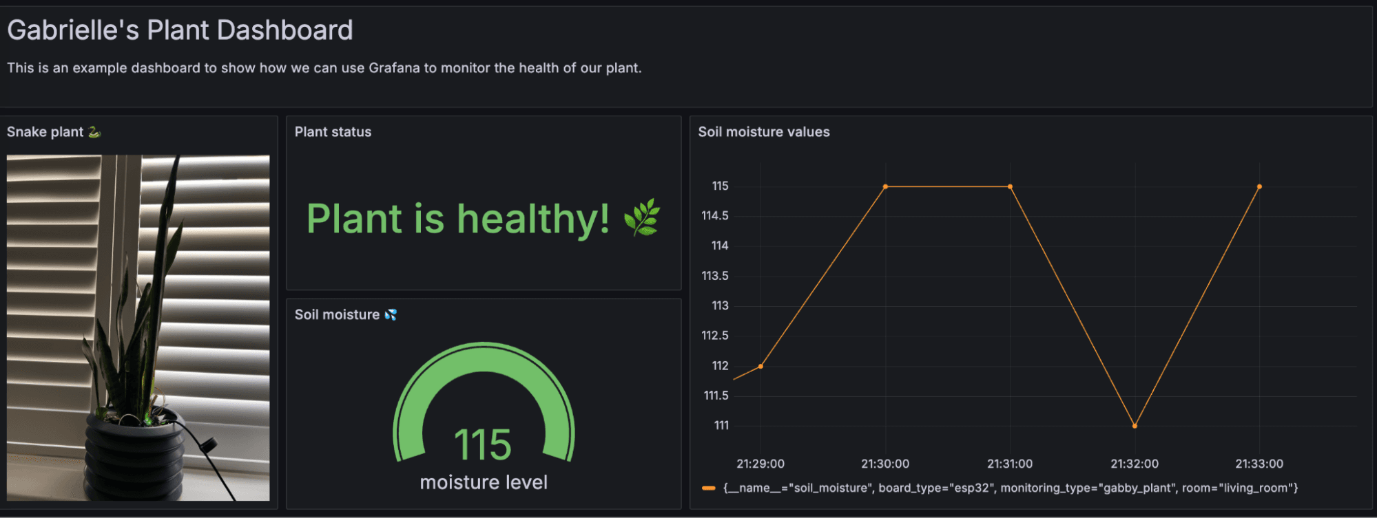

We created our dashboard using different visualization types, such as the classic time series, stat, gauge, and text panels. Since Prometheus is the default data source for Grafana Cloud, we just had to select the correct metric and label values when creating the different panels.
A screenshot of the metric and label values for the Prometheus query.
We ended up with the following dashboard by configuring value mappings to print different texts based on the values. 🙌🏻
A screenshot of a Grafana Cloud dashboard showing that the plant's soil moisture level is sufficient.A screenshot of Grafana Cloud dashboard showing that the plant's soil moisture level is dry.

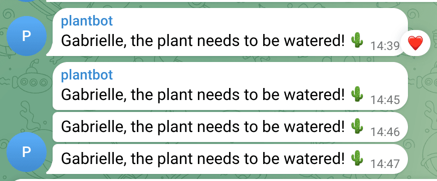

Thirsty Plant Alert
Having a dashboard to look at is excellent, but we thought getting an alert when our plant was thirsty would be even better. So, the final piece of our project was to configure Grafana Alerting.
To set this up, we created a new alert rule with the alert condition “when the query is above 500” to ensure we would only be alerted if the soil moisture value was above 500.
A screenshot of the alert rule conditions for our soil moisture sensor project.
We also linked the alert to our dashboard and time series panel for an additional visual indicator of whether an alert was firing or not. Note: you can learn more about this process in this video.
Finally, we created a new contact point to define where our alerts should be sent when an alert rule is triggered. We chose Telegram and followed the instructions to configure Telegram for alerting. So, every time the sensor values go above 500, we get the following notification on Telegram:
A screenshot of the alerting notifications sent to Telegram.
