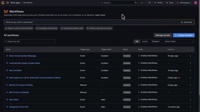

Ready to get started with Workflows? Pick the part of your week that keeps requiring someone to gather context or coordinate the next step. Choose a starting point from the blueprints library, or describe your process to Grafana Assistant and ask it to build a workflow for you.
Video

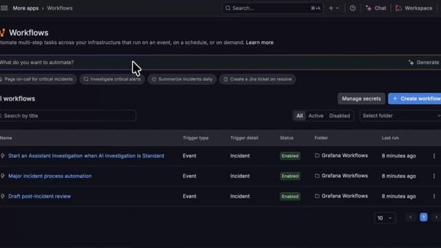

The workflow opens disabled, so you can review and test it before turning it on. The visual editor shows how the steps fit together. Run history lets you inspect their inputs, outputs, and errors, helping you check both the actions taken and the information passed between them.
For example, click on the button below to create your first workflow using an Assistant prompt to build a daily summary of incidents and firing alerts.
Grafana Workflows is available now in public preview. Use the getting started guide to try your first blueprint and learn more about this new feature in Grafana Cloud. Start with the incident setup you keep repeating, the handoff that always takes too long, or the service review you wish you had time to prepare. Make that one process easier, then build from there.
