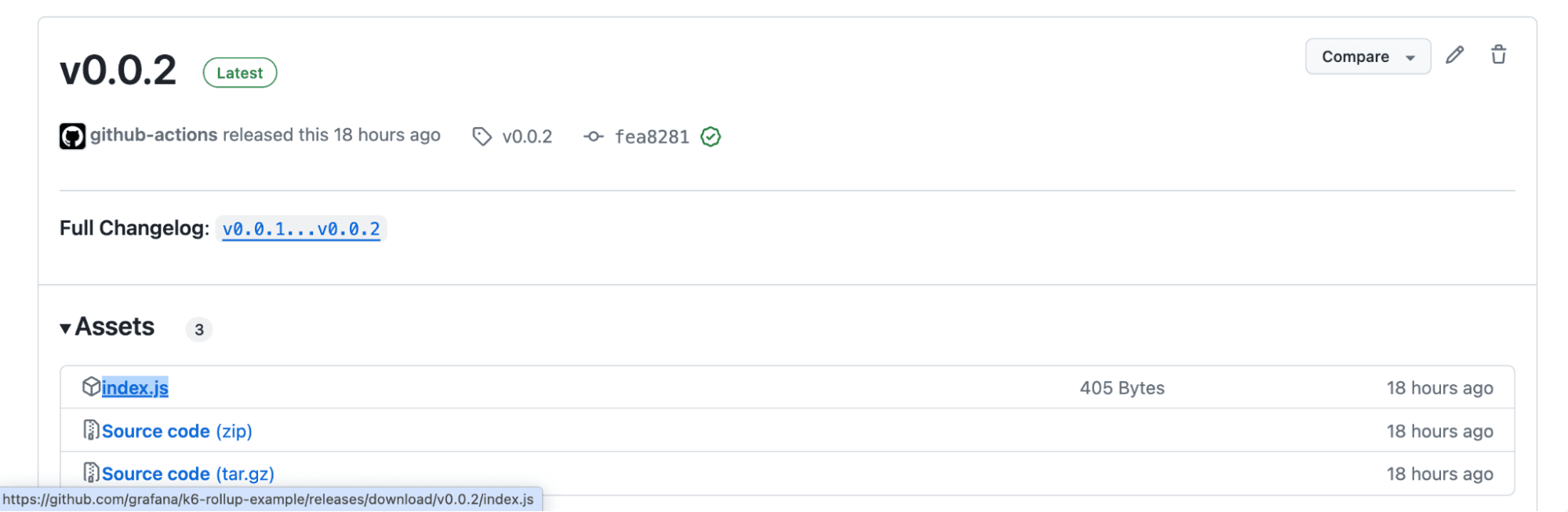

If you visit the GitHub release page for these projects, you’ll find the bundled public modules available as release assets:
A screenshot of a GitHub release page.
Copy the link of the release asset and use this URL to import the remote module from your k6 tests:
