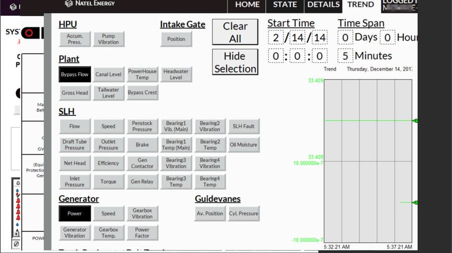

McKinley shared what the UI for one Oregon plant’s industrial controls looked like when he started at the company. “I don’t know if you guys have seen industrial control UIs, they start to look like this,” he said, pointing to page after page of charts. “OK, we need some buttons, let’s add some buttons to it. Oh here’s some more… Oh man. This thing’s kind of a disaster.”

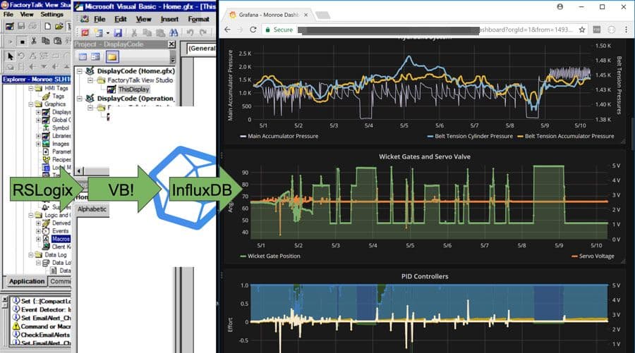

Working with the existing RSLogix system the company had in place, McKinley came up with a better solution. “You have to open up some Visual Basic, take Visual Basic, write it out to Influx, send it to Influx, then graph it to Grafana,” he said. “And everyone’s really impressed. Now you’ve got much easier-to-deal-with graphs.”
