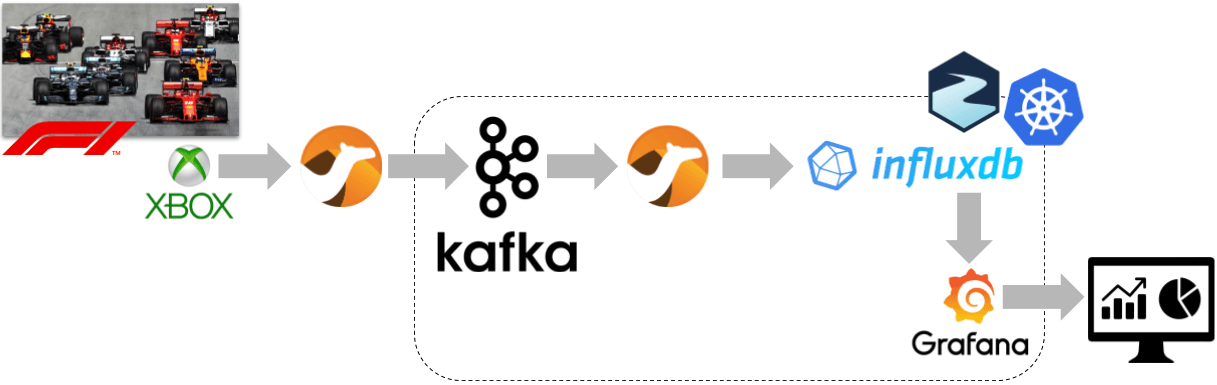

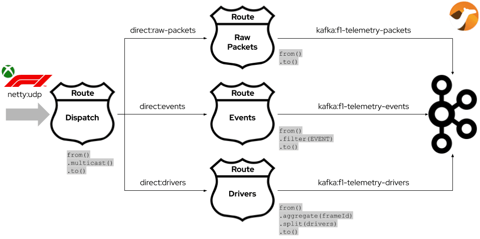

In order to go from UDP-exposed data to Apache Kafka running on Kubernetes, an Apache Camel based application is used. Apache Camel is an open source integration framework that empowers you to quickly and easily integrate various systems consuming or producing data.

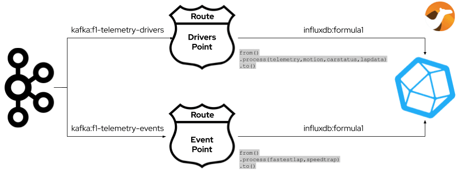

In this specific use case, the application implements multiple Camel routes to receive the data on UDP and dispatch it to different Apache Kafka topics containing:
- the decoded raw packets with no additional processing
- aggregated drivers data with all the corresponding information about car status, telemetry, motion, and lap data
- race events like speed traps and best lap
Of course, this application runs locally where the simulated data is available through the F1 2020 game.

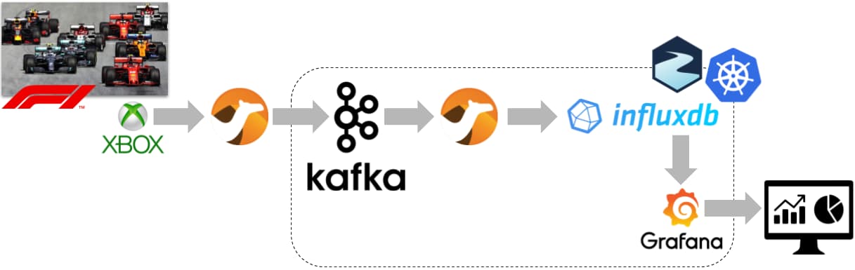

After the telemetry data is ingested into Apache Kafka running inside a Kubernetes cluster, it is made available for monitoring as time series using InfluxDB as a data source for Grafana.
In order to do so, another Apache Camel-based application, this time running on Kubernetes alongside the Apache Kafka cluster, is used to get the data from the topics and write them to an InfluxDB database.

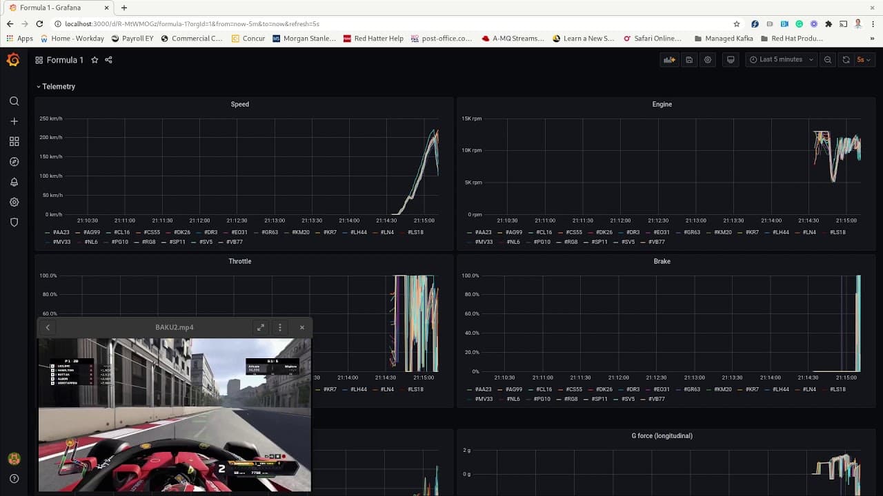

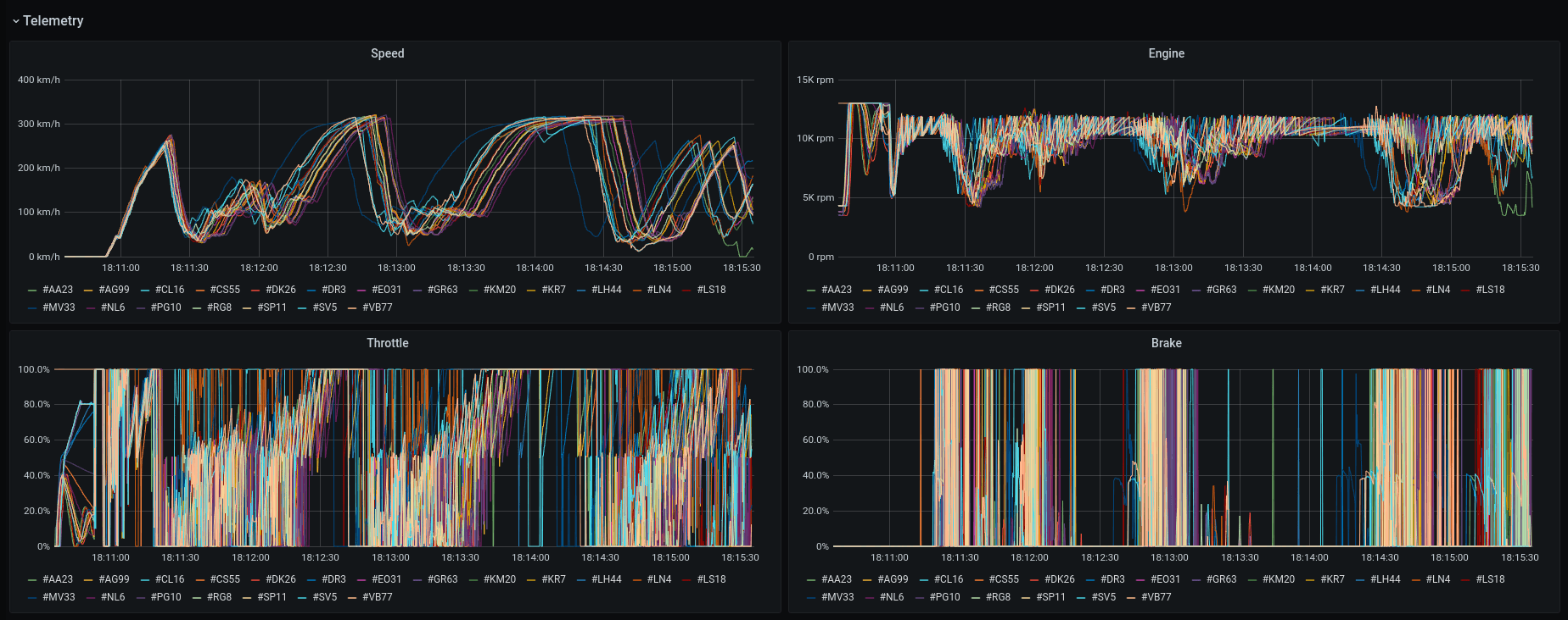

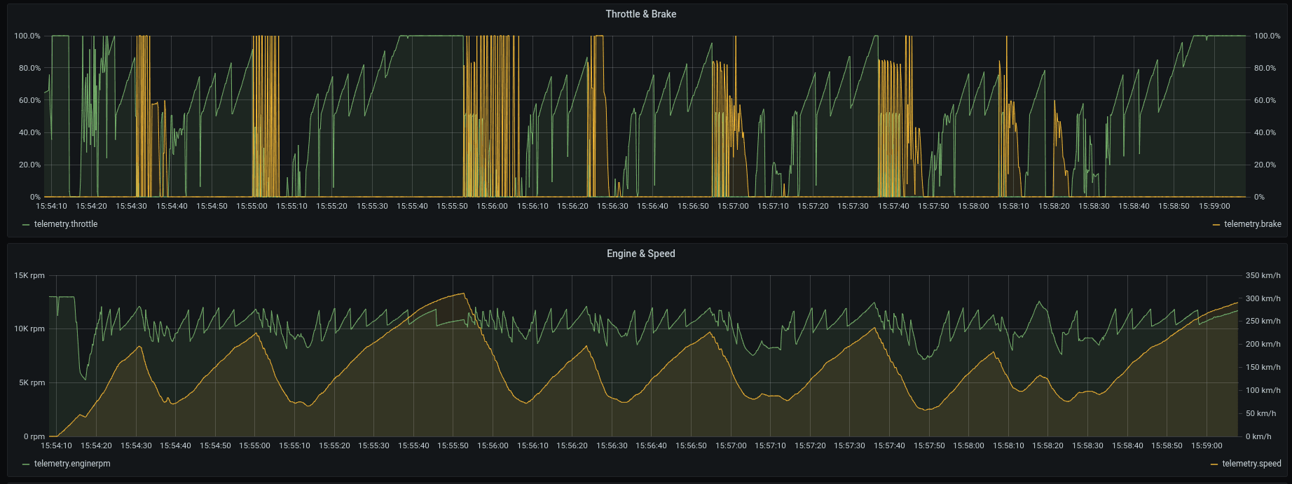

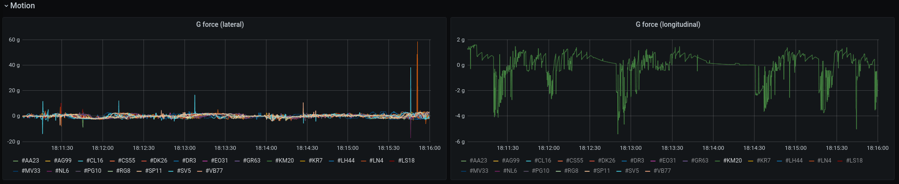

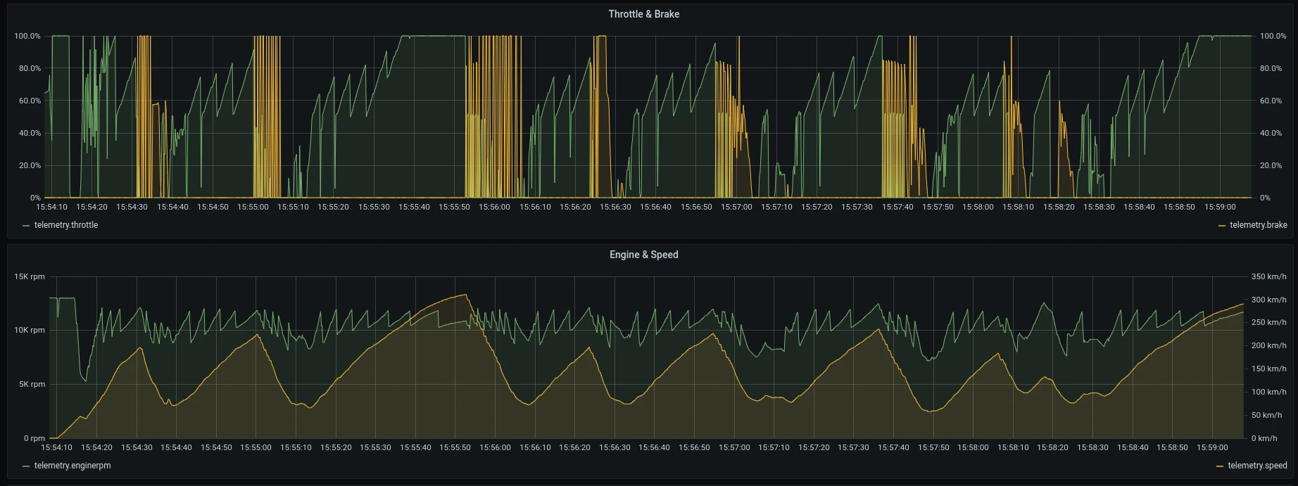

One dashboard has multiple panels for showing the data plotted for all the drivers in order to allow comparison in real time. The telemetry section shows the speed and the engine as well as the correlation with throttle and brake.
The motion panel provides information about G force, both longitudinal and lateral. The longitudinal one can be correlated with throttle and brake graphs to show what kind of force a driver is subjected to on acceleration and deceleration. The lateral force is more interesting when the car is facing a turn, or if it’s hit by another car due to an incident during the race.

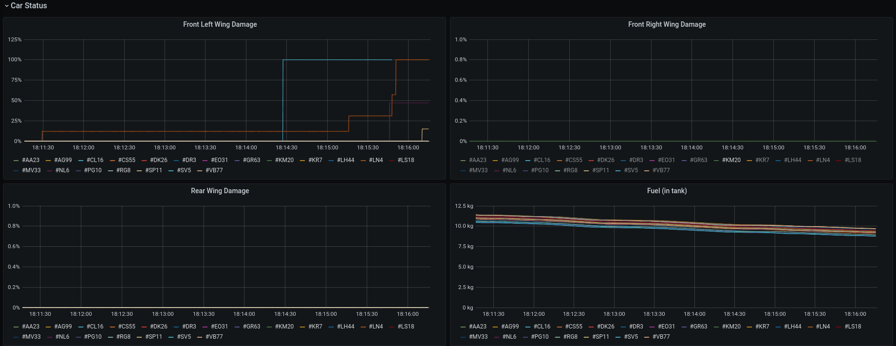

Speaking of incidents, the car status panels show the damage on the car wings (both front and rear); the fuel in the tank is shown in this section as well.

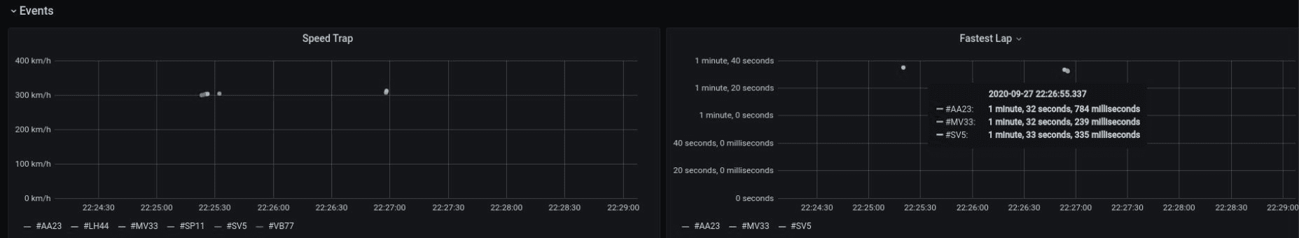

This dashboard shows the main events happening during the race; for example, the maximum speed reached by the drivers on the track as well as the fastest lap.

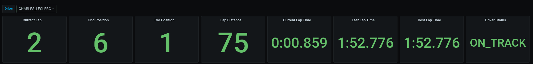

The top part provides some stat panels with laps timing, distance, and position of the driver during the race.

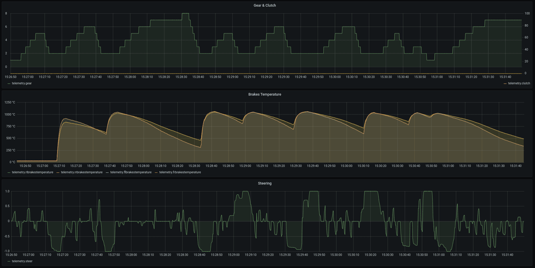

The bottom part has some graphs with each one showing more than just one type of telemetry data. For example, it’s interesting to correlate the throttle and the brake, as well as the speed and the engine revolutions per minute. Other useful information displayed here include the temperature of the brakes, the steering position, and the gear that the driver is using.

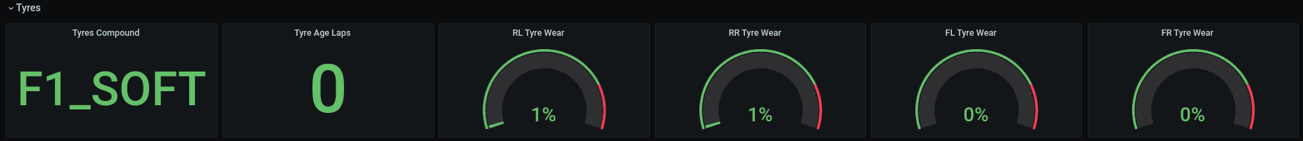

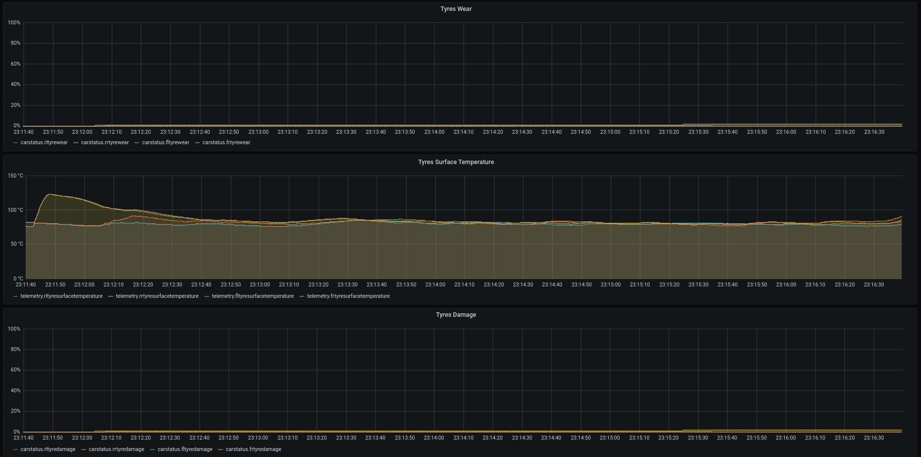

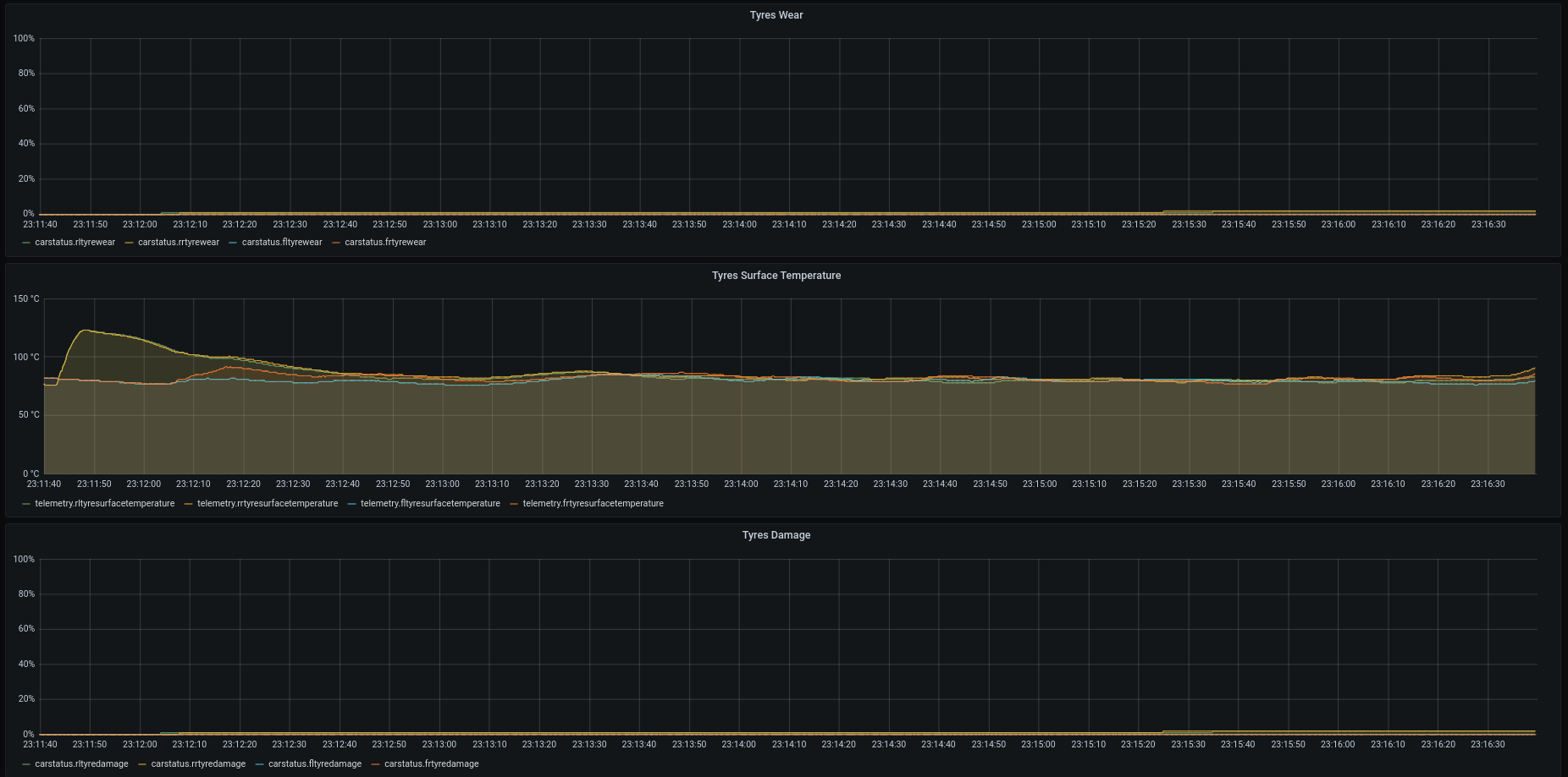

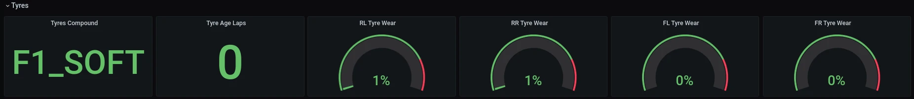

The last section shows information about tires in terms of their compound, age, wear (both using gauges and graphs), surface temperature, and damage.

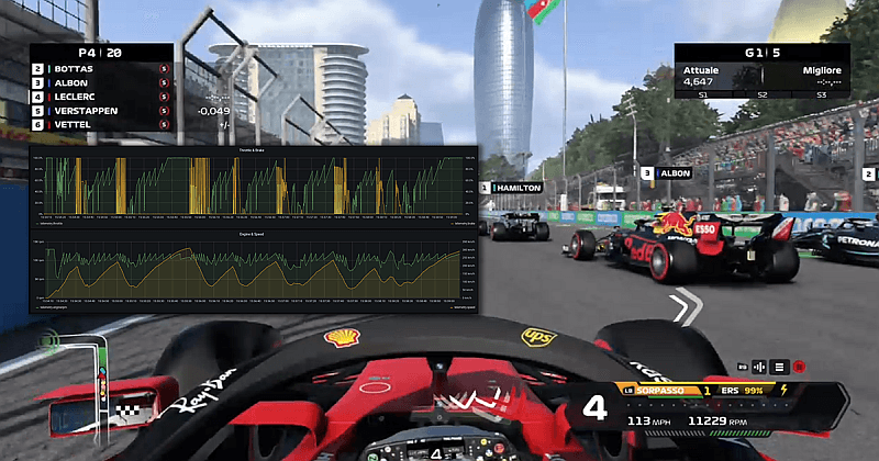

With a cursor highlighting and moving across all three panels, it’s really easy to see how the car is behaving from all the above perspectives. The dashboard provides important insights to the telemetry engineer to understand where the car can be improved and at which point of the circuit the driver is losing time.
